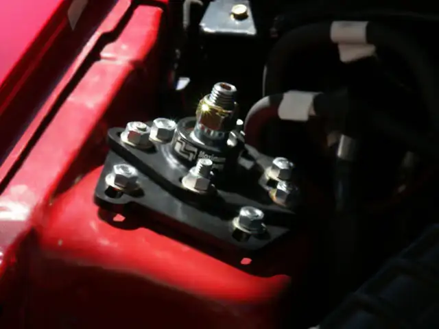

It's been awhile since I did mine. I wish I could see the instructions again. I'm thinking that once you figure out how much shaft is going to be protruding at the top (it will be too long and hit your hood, you need to compress it a bit for it to fit correctly), then I think you are supposed to put enough spacers below to take up the space between the strut body and the underside of the strut tower. The top spacers are set up so some your nut is above the CC plates like in the picture below. If you have your instructions scanned and can send them to me, I'll send you my email address and look at them to stir up my memory.
i got my instructions off american muscle's website. from some other threads i searched most people seem to have the spacers the opposite of the way i have em, so i think Ill give that a shot. from your picture, yours is setup the way i shouldve done it according to the instructions. i did it the other way because i didnt think id have a drop with these springs, but i was wrong.

Do you mean "upper strut housing"? The shaft goes through the cutout in the strut tower. See, that's where I was saying that he needed to make up for that distance between the strut tower "cutout" and the upper housing. I really need to put my car up on a lift again to be sure I'm explaining it right. Or if I'm full of **** for that matter. I think too few (lower) spacers could cause banging/rattling. Quick fix if that may be it... add another small spacer down below (on each side, passenger/driver - both sides must match at all times).

haha^^ nice. i dunno what happened with this caliper, the bolts are tight but the thing is loose on the bracket. either autozone forgot some hardware or i was too drunk to switch something over from the old one. i think im gonna switch the spacers around on the strut though, the way i had it before looked like yours in the pic you posted, the way i re-did them according to the instructions looks rediculous, the strut shaft almost touches the underside of the hood. ill get this right eventually..
