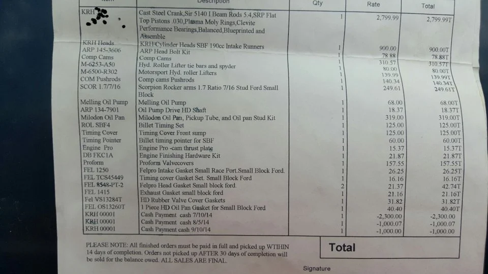

The guy is selling me the car for $5,500. The car engine is about 1.5 years old, and it seems really clean, I'm going Wednesday to check it out and hopefully buy it. I've been wanting a manual gt for the longest and chose to get the fox after learning great its' potential is. I'm trying to learn how to work on cars and get a wider knowledge with this one but I'm not sure if that engine build is worth 5500, or w.e, just need some professional advice from yall please!
No idea what KRH heads are, at $900 i'd be a bit skeptical. (even a google search didn't provide any insight)
I don't see an intake listed either.
If your question is, is that engine worth $5500?
I'd say not even close. I certainly wouldn't have dropped over 5 grand to build it (unless it was a 347 with quality heads and intake).
If you like the car, it runs right and is well kept, i wouldn't let the engine keep you from buying it, but IMO that engine is not a selling point either.
Depending on the heads and intake, it may be no better than a $500 junkyard gt40 explorer engine.
I'm wondering since the intake is left off the list if this car is carbed or has a stock intake?
I'd say not even close. I certainly wouldn't have dropped over 5 grand to build it (unless it was stroked with quality heads and intake).

Is the car worth 5500 from just the picture?
For sure at that price you aren't stealing it.
For hp, not sure if he's quoting flywheel (probably is to hype up the numbers) or rear wheel.
Regardless it doesn't meet that number at the flywheel and certainly not at the rear wheel.
Slice off 15% of flywheel to get close to the rear wheel.
A realistic rwhp number with a 331 and quality parts 375rwhp (some guys do better, some worse)
Skimp on the heads, cam, intake and that number could be 300rwhp or less.
I think you are really going to have to see this car and feel out the guy. If he comes off as a BS'er, be prepared to walk.
Right now judging his ad and what you just said about his hp claims, I don't have much faith in him

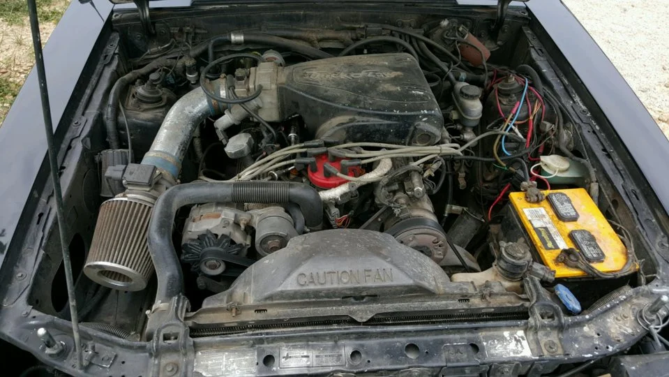

Reactions: Richard LaFlower
Ask him for a dyno sheet to back his 450hp claim. Never heard of those heads. Anyone can give you a list of parts that are allegedly in the motor.
Do the normal inspection, rust, damage, accident, fluids, etc. I would also bring a code scanner and run the codes.
I'm taking two mechanics with me to check out the car, and I asked him for a dyno, just waiting for the reply. Honestly think he's bsing the dyno, but let's see
Wow, after seeing those pics, i'm much more concerned.
Clearly the carpet doesn't match the curtains in this case.
That dirt and an open filter should be criminal.
It's pretty much a disaster under the hood.
Also looks to be a stock mass air meter (I could be wrong, but I doubt it) which means the injectors are probably stock, which in turn means the fuel setup probably supports less than 300rwhp.
