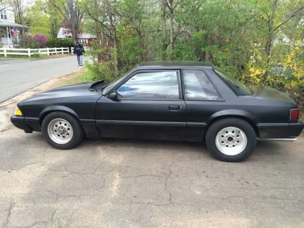

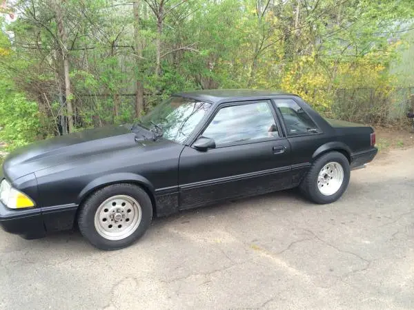

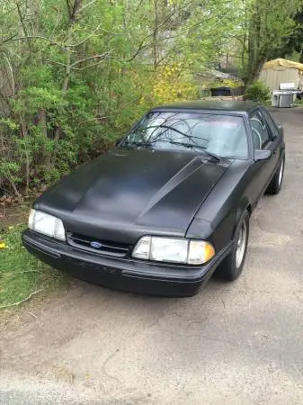

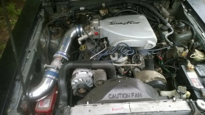

Im going to take a look at what might be my first mustang tonight and thought I would ask your opinion, its an '89 lx coupe supposedly factory v8 5spd (ill check the vin when I see it) Ive done all the research on what to look for so more or less just seeing what I should actually pay. Its a hardtop, power windows, tilt wheel, red interior which I don't mind, says has surface rust on towers but no holes and floors are solid (supposedly). Heres a list of mods:
weld in connectors, headers, full exhaust, e cam, trick flow intake, afr heads, msd ignition, posi with 4.10 gears.
Asking $4500. original color was grey, its currently flat black with weld wheels. don't know the mileage. Says needs minor work, what do ya guys think...

To me in the picture the front fender (lower part) where it meets the front bumper looks pushed in. Something looks off as well where the lower part of the drivers door meets the fender. Could just be dirty and i'm seeing things.
Also, what's up with the window, is it off track? Doesn't look right at the top where it meets the weather stripping.

There is a fender piece that's suppose to be there..... its gone
Thanks, I see where the fender looks a little funny and the glass looks off track. I'm not afraid to work on stuff and I don't care about a/c etc. Basicly just wondered if the parts and basic platform was worth it. Im waiting to hear back about the mileage , I'm also a welder so that's not a real big issue if it needs fixing. I am worried about it being tweaked just by the way the fender is, also there seems to be a small gap between the fender and a-pillar but I see that on almost every Fox I've looked at. Trying to find a good v8 coupe around my area is a needle in a haystack, even a hatch is hard to find. Dam small towns.
Mileage would be a deal breaker for me even though these cars have 5 digit odometers. The fender isn't tweaked, there is a plastic body piece that bolts on that is missing. That gap, is really not a gap but more the way the light is shining on the rubber from the quarter windows. Take a look, you might change your mind
Looks like a new alternator, probably 3G if it has e-fans. Has a Summit aluminum radiator, the AC lines are still there hanging around. Ask him if he still has the compressor for the AC. They did the AC delete that moved the PS pump up. Engine bay doesn't look rusty to me, just dirty.
