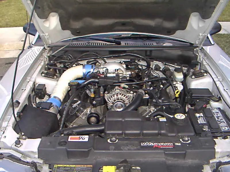

A better idea would be to get a hacksaw and saw off the 90* bend that everyone bitches about and attach the filter right infront of the MAF
You mean like This ......
My Car Runs Alot better now ........

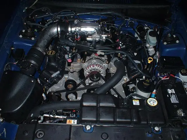

I ordered a cold air tube from Roush ($65 shipped to me in 3 days), attached it to the stock MAF w/o screen, and then hooked it up to the stock airbox housing which I all but cut away except for one of the rubber stop things on the bottom of it. I Needed to buy a foot of some fairly small diameter rubber hose, make two 1/4 inch spacers out of some 3/4 inch tubing, and had to purchase two smaller size hose clamps to get everything to fit like a glove. I spent a little less than $70 total for the whole cold air intake. IMO, I think it would work great for anyone with the C&L or Dragon plenum who's looking for a cost-efficient alternative to a 150 to 200 dollar plus cold air kit and doesn't want the look of a "plumbing style" 100% homeade CAI. I ported and polished my upper plenum and added a UPR o/r x-pipe and the car sounds like a friggin' Harley at WOT. Much more of a snarl to it than a rasp. Absolutely wicked:nice: I'll attach a picture of my cold air intake below for y'all:
