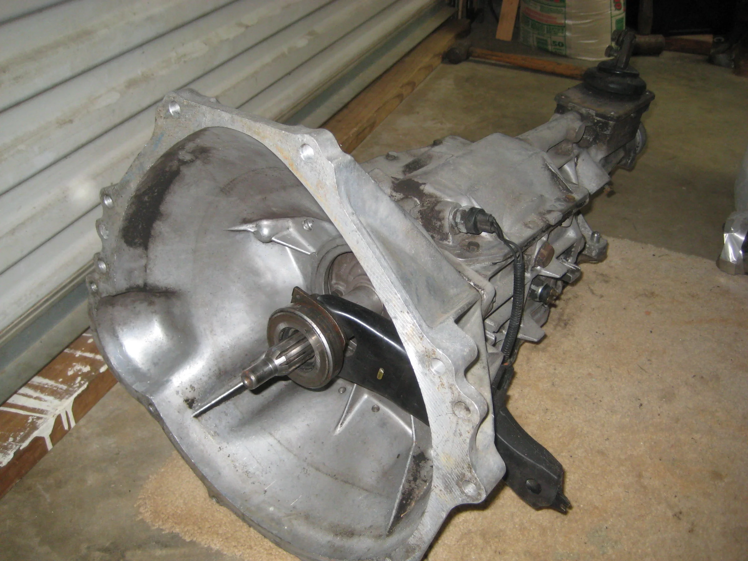

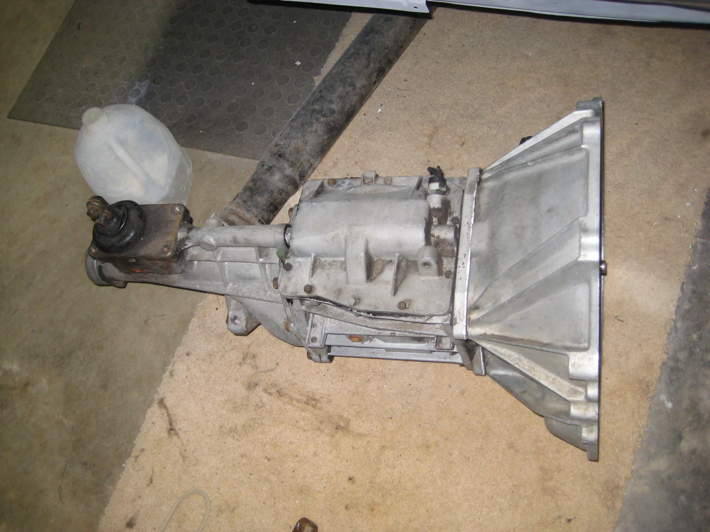

I've been contemplating installing the 84 Mustang GT T5 trans I have in my daughter's 66 convertible. It has a 200 6cyl in it with a C4. I'm about to pull the drivetrain and try to get some body work done as time permits. While the engine is out I'll try to freshen it up, that's when I was considering installing the 5spd. Actually the 5spd supposedly came out of a 66 V8 Mustang, it has the adapter and bell attached for a V8.
Some of the questions I have are:
Where can I find a bellhousing at a decent price to work on this swap. From what I read the two bolt starter bell is the one to use, for it will take the 9" clutch. I'll need to get all the clutch parts and flywheel. I have 289 and 302 bellhousings, and sure would like to do some trading.

too bad you are not near me, i could use the T5 bell housing, and i have teh bell housing you need, a 2.77 bell from a 64 falcon. unfortunately it is still in the car, and i am in no condition to pull it. check over at fordsix.com as there are guys selling the bell housing you need all the time. you also need the flywheel that goes with it. the problem you have is that unless you have a dual pattern bell housing block, you will need the smaller bell that uses the 8.5" clutch. and there are good solutions for a good 8.5" clutch as well, you can find them here;

check your bell housing bolt pattern before doing anything, if you see a total of four top bolt holes, two about an inch above the lower top bolt holes, then you can use the larger 3.03 bell housing. check here for more information;

The bell on the T5 is the standard one off a 289, it has the adapter for the trans. I do have a 289 out of a 66 fastback, was considering rebuilding it and dropping it in. Only concern is the vert does have some issues with the sheet metal (rust and bondo from previous owner) and I don't want to put a ton of $ in it.
