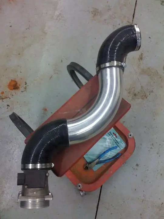

I need to see or get some ideas from those of you running a N/A motor in the fender CAI,that have a 90mm throttle body and 90mm MAF also please state the size of your pipe and where you got it and used. i'm thinking of useing whats pictured below after i cut and weld it back together OR buy some 4" exhust pipe? The stuff below is 5" and i have 2 pieces the same lenth and design.peace

i just use an AFM 4" powerpipe, pretty simple, If it was me i'd stay away from using that 5'' pipe, seems a little big, and its going to dwarf the throttle body.

cobra dustin your right! i wounder why they say 90mm then when it measures 4"? in mm thats like 102/105mm. so 3.54" is 88.5mm. i was thinking the same thing that 5" is just to big and bulky looking under the hood. i'll go look for the AFM pipe. got any pics of it? peace

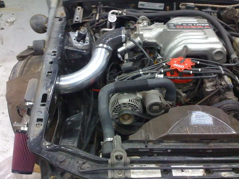

got everything from ebay. 3.5" system, pieced it together for right around $100 for everything including silicone elbows, pipe and K&N filter. i modeled it off of one of the AFM power pipes because i couldn't bring myself to pay $180 for something i could build myself for cheaper. if you decide to build it yourself like i did, you can get everything in a 4" diameter for the same price.
We have used the 4" intercooler tubing kits from ebay for around $100. We have also mocked up what we needed and then went to the local exhaust shop and bought 4" exhaust and had them do our bends(our shop has a mandrel bender and not the crappy kind like most exhaust shops use).

GTO thats the plans to make or get a new one,do you have pics of the pipe you are offering?bubba-dough yeah thats peobably whay i'll end up doing.going to the exhust shop and getting like a 2' piece of 4" and then i'll go to portland rubber and get the elbows there.i would cut and piece together the pipe and weld it myself or take it to the exhust shop to have them bend it.peace
