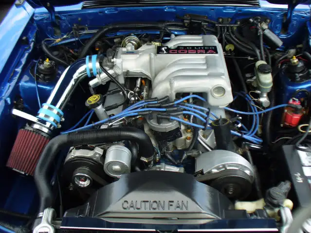

94/5 gt. You should be able to find them under 50 dollars. Post a pic of your set up.

No kidding. I should also mention I have 19# injectors and planned on switching to 24#. Figured it was a good idea. So that MAF probably won't work then. I don't have any recent pics on my phone but here is one when I still had ported heads and stock valve covers

You don't need 24s with your mods. 19s will handle that quite easily. As far as a shield goes you can try to find one that's close to your dimensions and make it work or just fab your own. If it were me though a 3" hole saw will open that filler panel cleanly enough to run an intake tube through. I made my own out of silicone bends and aluminum turbo piping.
