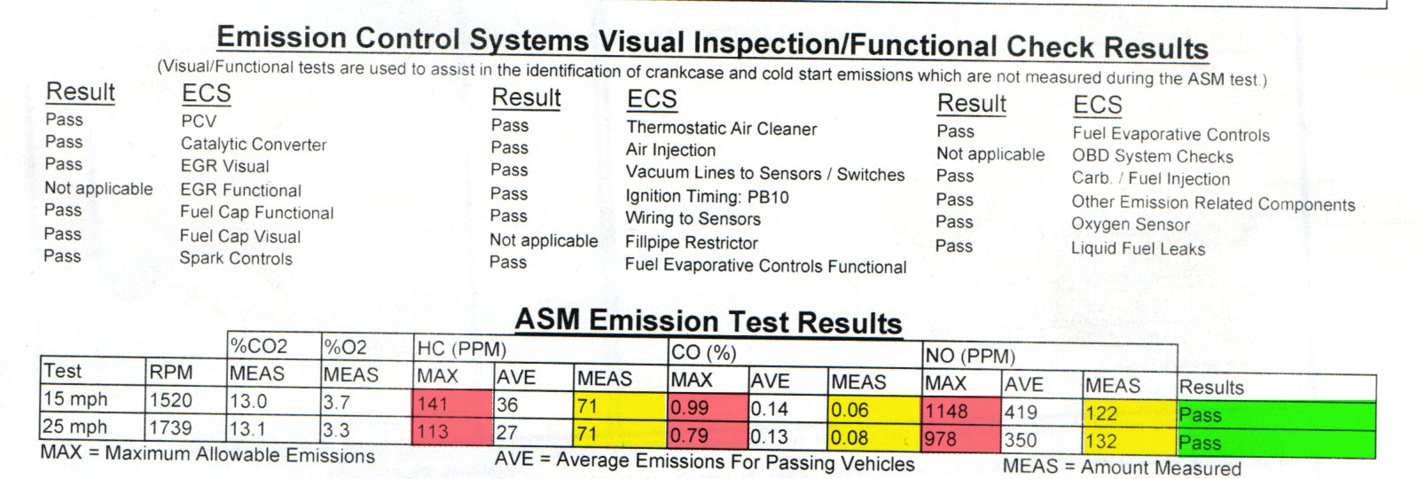

So had to smog the Capri since Cali still requires it and this is my results from today.
Red is max levels
Yellow is my levels
Green PASSED!!!! :)

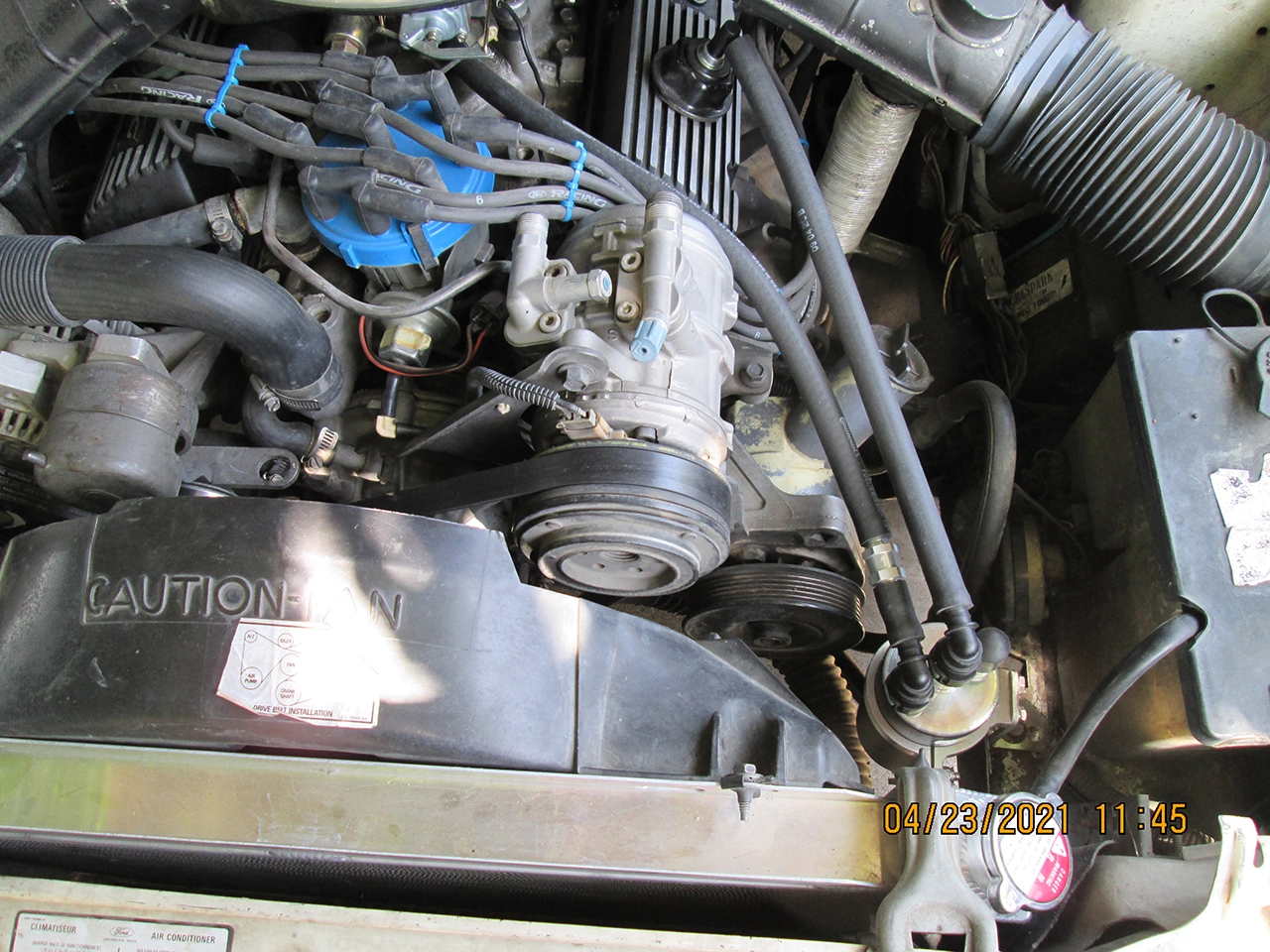

The usual stuff like a tune-up, change oil, filter, and reconnect the EGR valve. Also leaned the carb a little, usually one turn in each air/mix screws. Run a couple of tanks with fuel/carb cleaner. One thing that really cleaned up the test was a catch can on the PCV. That made a world of difference from the smog check I had two years ago. Even the Smog guy was impressed.

Forgot to mention that he has two smog machines, one for 75-99 and 2000+ for the other one. He tested a few late model cars on the 75-99 machine and failed the tailpipe emissions even though they passed the 2000+ machine. Those cars were usually double the output so we were thinking it's all rigged on the new cars since they can't pass emissions anyways.
