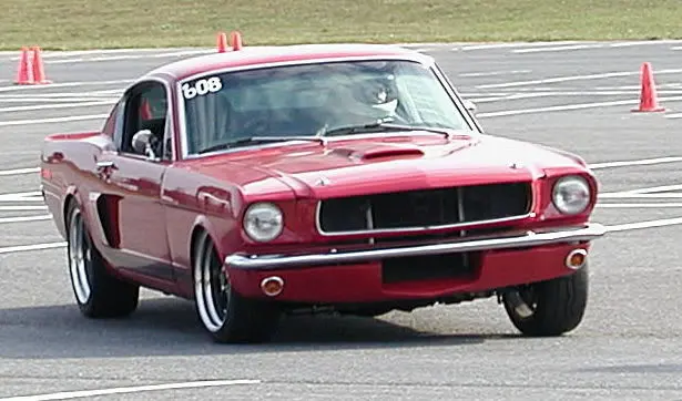

Autocross

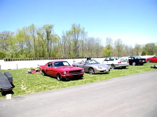

Open Track Event at Summit Point - http://www.summitpoint-raceway.com/
