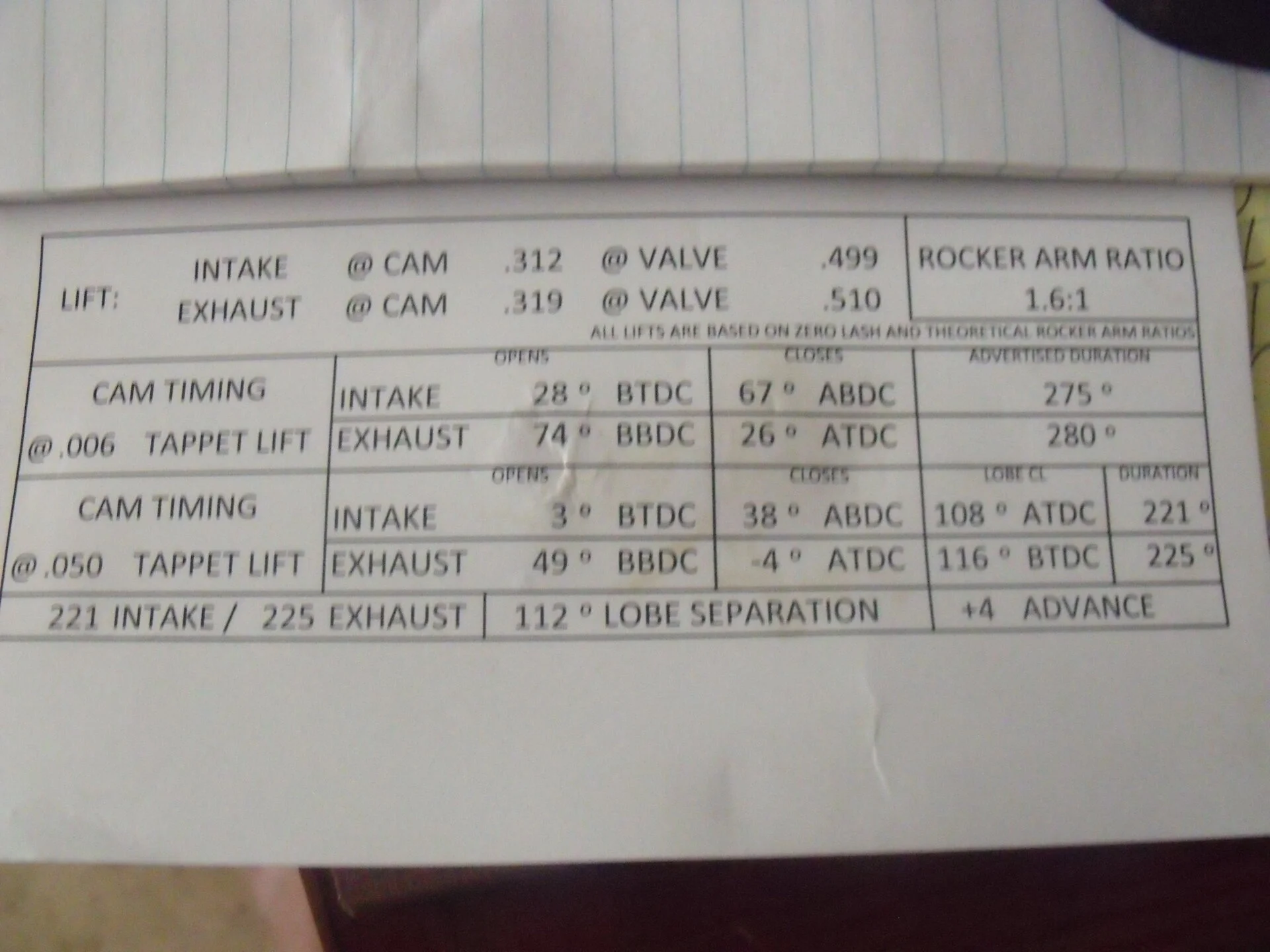

limp wrap a little cheese around it and its a done 5 Year Member Oct 4, 2020 5,518 2,941 173 Florida Jun 2, 2021 #1 Jun 2, 2021 #1 My cam just came and I am confused with the cam card... Bottom right square says +4.... Does this mean that this cam is designed to run +4 degrees?
Mustang5L5 That is…until I whipped out my Bissell Mod Dude Feb 18, 2001 43,349 18,085 224 Massachusetts Jun 2, 2021 #2 Jun 2, 2021 #2 Means the cam has 4 degrees of advance built in. Will favor power in lower RPM
limp wrap a little cheese around it and its a done 5 Year Member Oct 4, 2020 5,518 2,941 173 Florida Jun 2, 2021 #3 Jun 2, 2021 #3 Mustang5L5 said: Means the cam has 4 degrees of advance built in. Will favor power in lower RPM Click to expand... Thanks so much, just what I want.....
