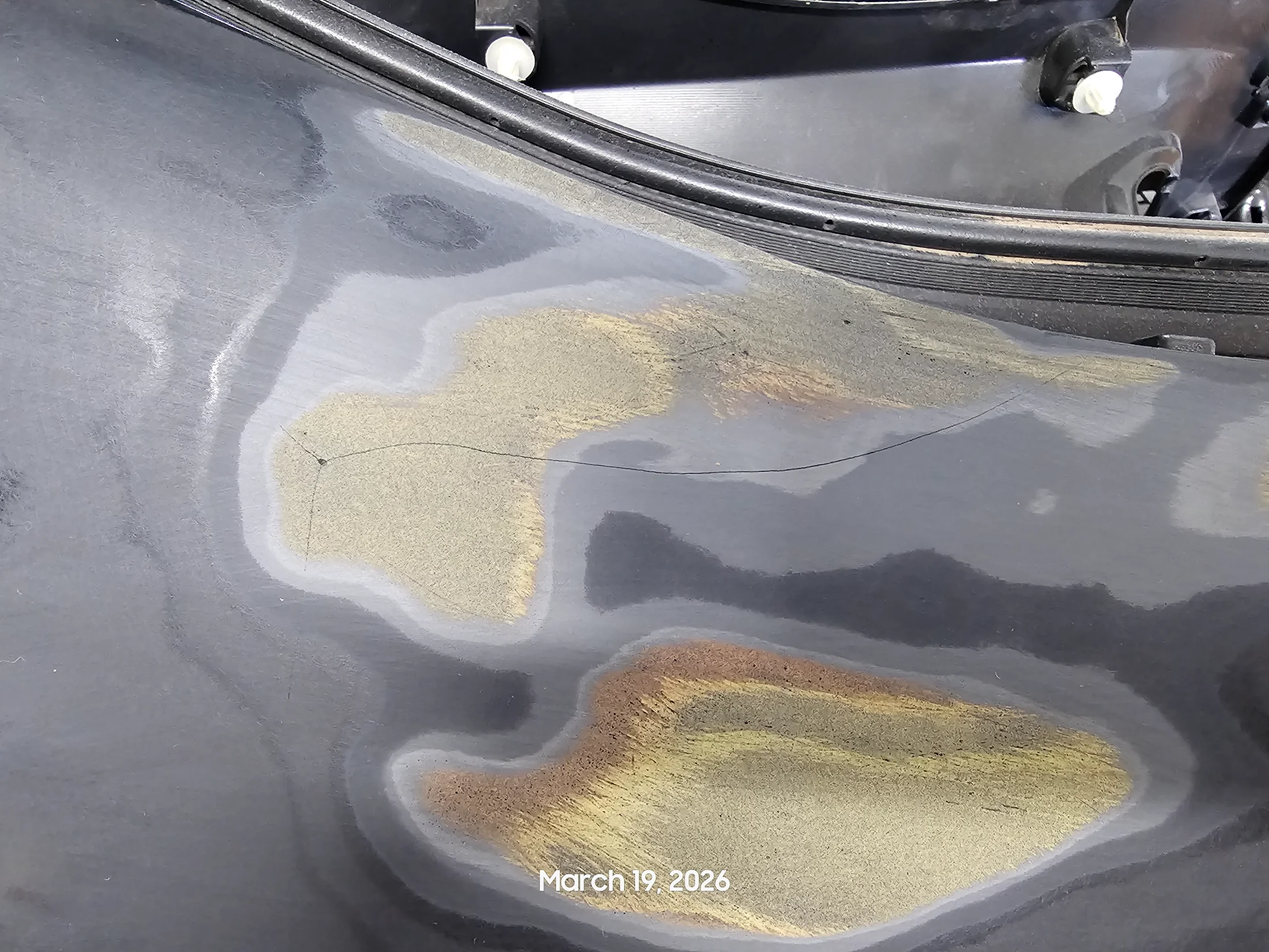

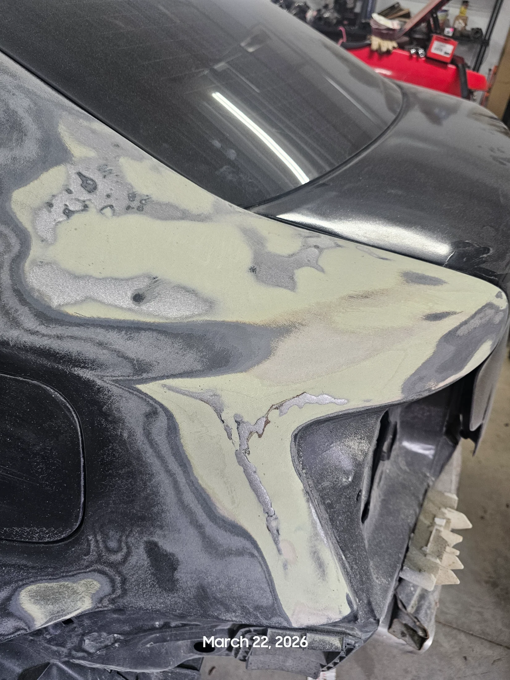

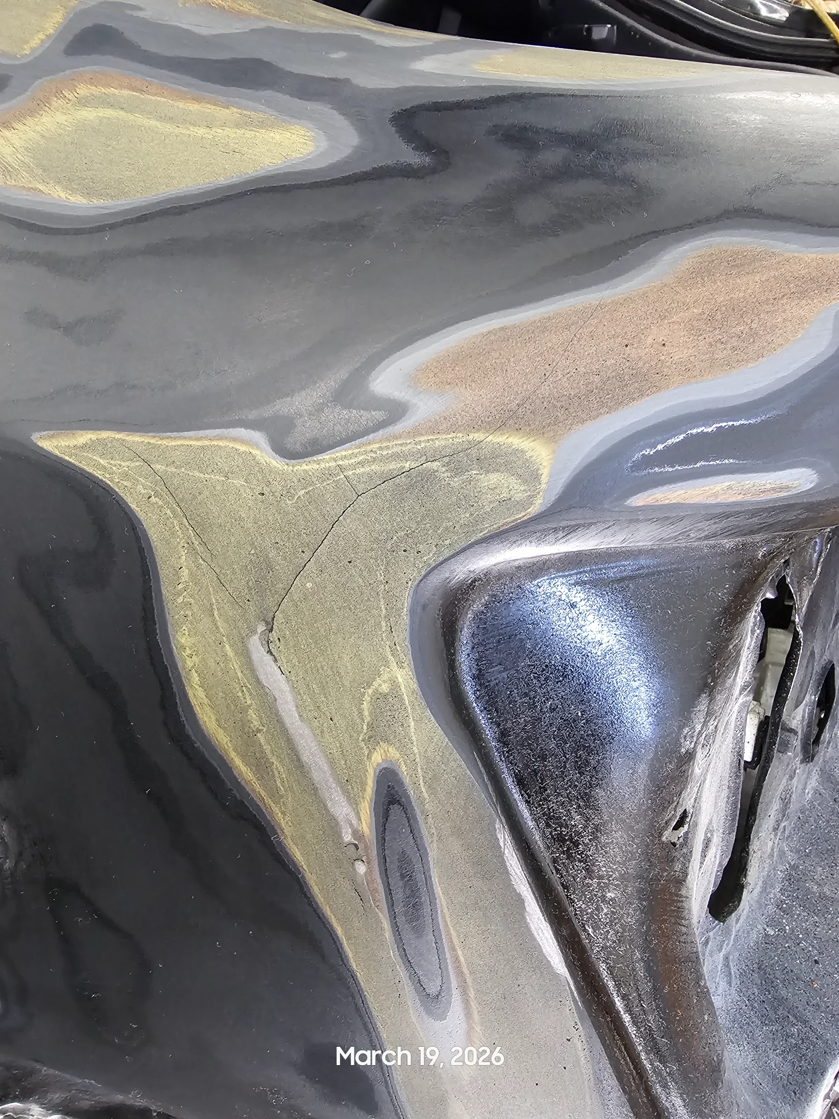

I suspect that it's kinda thick, but don't really have a good estimate. Was thinking that if I would have to grind it all away if I shouldn't use fiberglass reinforced filler before using a skim coat to finish it off. Seems like that would probably be the best approach.Grind it out or it will come back. Gotta be pretty thick cracking like that on sheet metal quarter panel.
