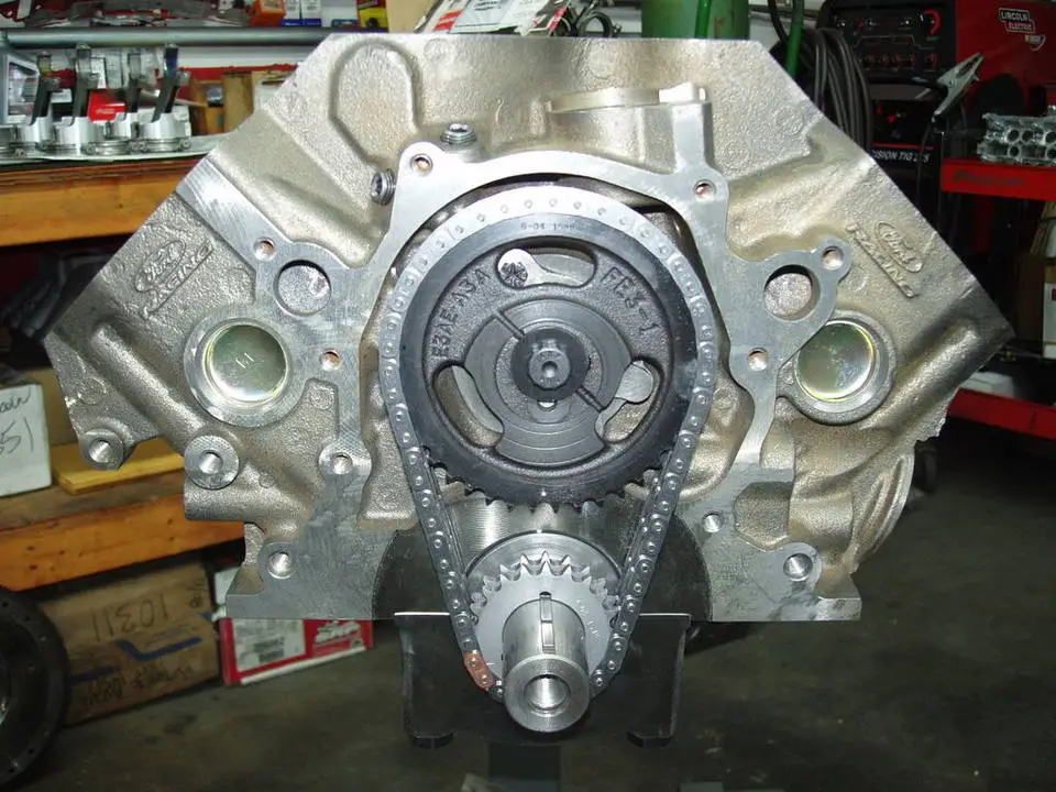

I am trying to put the camshaft timing gear on for a Comp Cams XE270HR-14 cam. The pin is in there, however, the essentric that holds the pin in seems to not sit flat on the surface of the gear itself. Can anyone comfirm that:
A. The dowel is too long
B. Its normal and ok to run like this
Thanks!
If you're running this in a 94-95 with EFI, lose the eccentric. It didn't come with one from the factory. Otherwise, you'll need to grind down the camshaft dowel, so the eccentric is flush with the sproket, or you may end up rubbing on the inside of the timing cover, if it'll fit behind it in the first place?

As said above, make sure it all fits flush, there are typically two dowels that come with camshafts - looks like you are needing the other. I can measure a dowel I have on a camshaft if you need measurements.

Alright, well it is a 94-95. My personal opinion is that it should have one there as what would keep it from possibly wiggling its way out of there. The problem is, I didn't take this appart, so putting it back together makes it more troublesome. When I got the engine with the cam / head installed, the essentric was not used. I then began to tear down what he built up and then began inspecting the internal workings of the engine. When I put the cam timing chain back on, I was looking in the chiltons manual and it showed this part in there. I found this part in a baggie and figured it was suppose to go back on.
Are we under the consensisus that :
A. Its a 94-95 and no essentric needed
B. Get a shorter pin so that this essentric fits. I will get measurements of the pin if this is the case.
and to answer your question Stanger007, I will get a picture of it later as I am at work right now.

And again, I would ditch it, heck, it may rub your 94-95 timing cover with it on?
