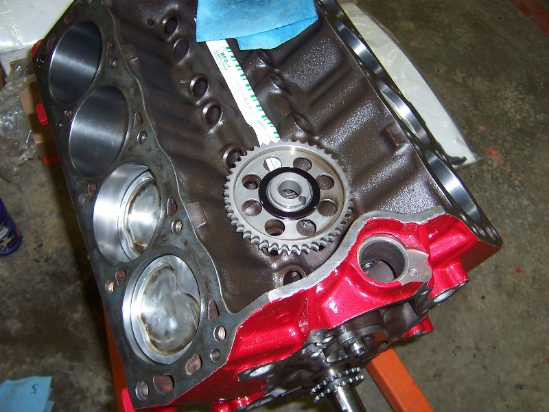

I've got something like that on my engine, but the bearing is attached to the timing chain gear instead of the cam retainer.
Here's a pic
