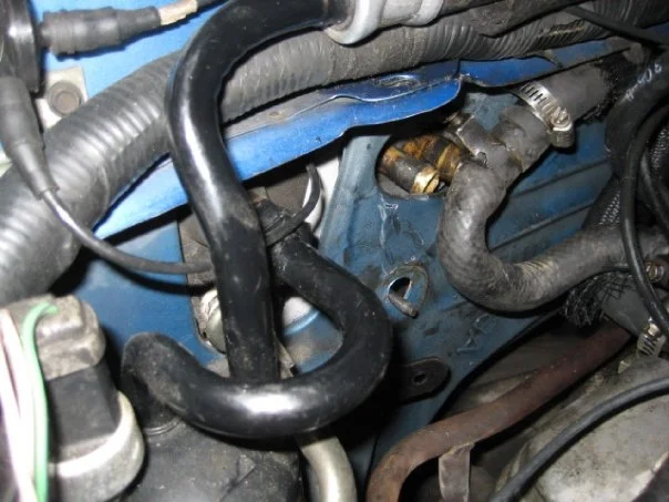

You're already aware that hot coolant flows through the heater core. There is a restrictor stuffed inside of the inlet hose (remember this). Engine coolant flows through the heater core any time the engine is running. The heater [blend door] (operated by vacuum) mixes heater core air with cabin/outside air.
You have two options: Replace the heater core or bypass it.
Since you're in Virginia, I would suggest replacing it but doing the bypass until you have all your [collective stuff] in one sack to do the project. It's a weekend deal.

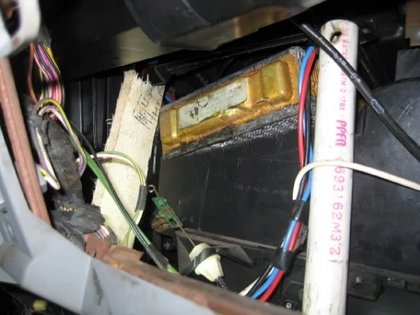

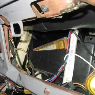

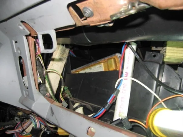

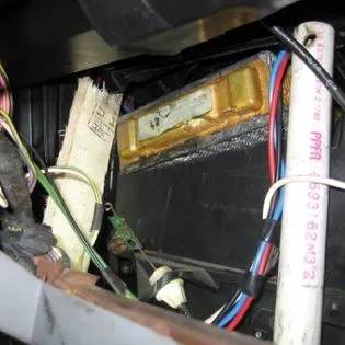

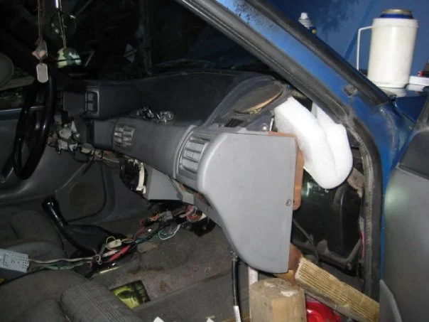

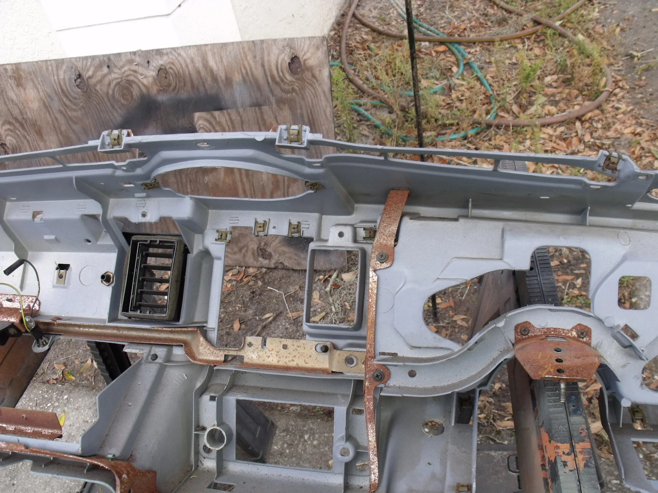

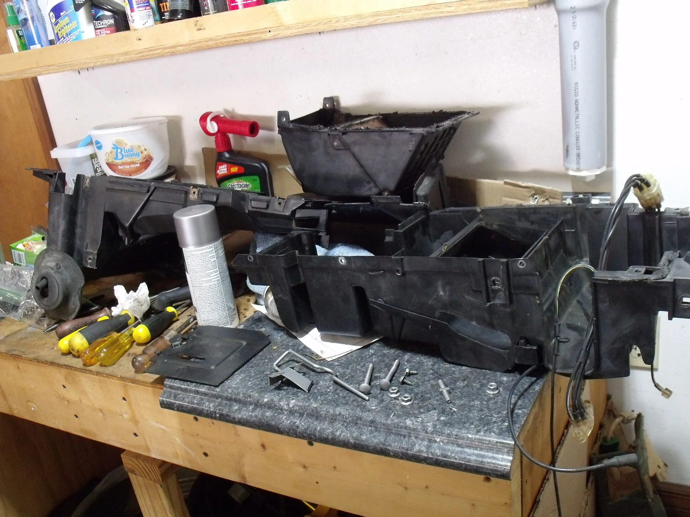

Its a fair amount of work replacing the heater core, this coming from a first time doing this newby, but if you take your time and have some patience its not horrible... Now if you get into a " this begats that" ( like taking all of the surfaced rusted metal bracing off the back of the dash, cleaning sanding and painting it ) it will take a little bit longer.... Pictures really helped me put it back together..
This is a 6-8 hour job the first time if you are mechanically inclined. It's a well documented process that does not require completely removing the dash.

this is some BS... !!! i did mine years ago and went with motorcraft... !!! to hell with pulling all that crap off... !!!

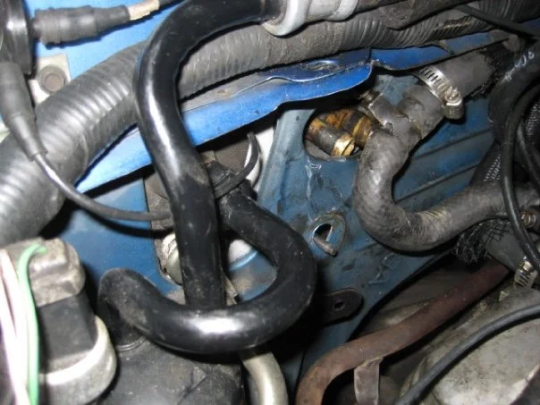

Any way you chalk it up its a pain in the ass. Be sure that you have the pressure restrictor installed or you will stand a good chance of popping the new one.
