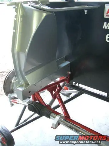

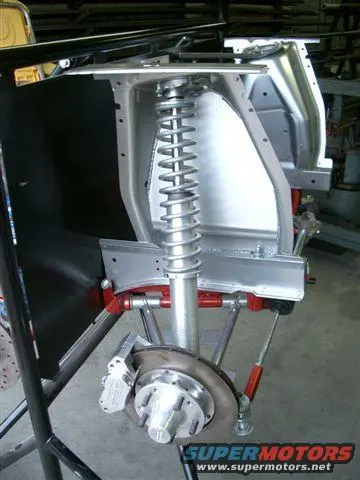

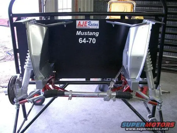

1320stang Founding Member Nov 13, 1998 4,329 23 89 Edmond, Oklahoma Mar 2, 2007 #2 Mar 2, 2007 #2 You can use the E-brake handle, there's a thread here with a link. Guys use the 8.8 rears in the classics, I don't think the front brakes or hubs will do you any good, well, unless you use this: Attachments aje1.webp 34.6 KB · Views: 145 aje2.webp 21.7 KB · Views: 177 aje3.webp 16.3 KB · Views: 175
B BB1966 New Member Dec 1, 2004 297 1 0 Beaufort , NC USA!!!! Mar 2, 2007 #3 Mar 2, 2007 #3 The engine/trans are about all....I dont think any Fox stuff will fit that front end,its all custom.
