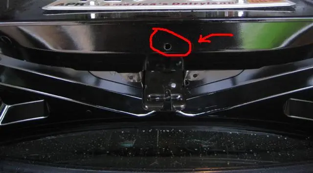

I have been trying to track down a rattling noise in my trunk for about a week now! I have only had the car a few weeks and is been there since the day I bought it. I have removed all the mach 460 stuff, the spare and jack, the insulation an everything else I can see. Its still there!?!!?!
Is there supposed to be a rubber stopper or something in this hole I have pictured?
I only get the rattle when I am driving over bumps, I can hit or shake the trunk lid all day long and I cant make it make a sound. It shuts firmly and is not loose once shut.
My lock is off-center also, but I cannot figure out how to get at it or remove it to check it any further.
Any ideas guys?

A lot of time rattles are not coming from where they sound like they are. Have some one drive around while you sit in back, see if you can tell where it is coming from...
I doubt it has anything to do with the trunk. Maybe there's something loose under the car. That sounds about right considering you hear it after bumps and such. Maybe the 02 harness is a little loose or something and its hitting a pipe. That keyhole is off center from the way they manufacture cars in mass amounts. It's no worry.

I have already put the back seats down and laid on my back with my head in the back of the trunk while my wife drove a few blocks :rolleyes: Yeah you can laugh it felt kinda silly.
It's definately coming from the trunk area somewhere, or DIRECTLY attached to it. It's not coming from way underneath the car. Sounded like it was within 6 inches of the latch area on the trunk, hard to tell from in back (I hear about 100 little noises when I am back there)

A while back, SEVERAL people were complaining about a rattle near the trunk with the SN95 model. It was later discovered that the "C" pillar had a portion which seperated from the rear quarter panel, thus causing a rattle and/or squeak. Remove the inner "C" panel pillar interior covers (rt/lft) and check where the weld is on the rear quarter panel. Look for any wearing and/or chipped paint, it should be near the end corners. This may be your problem.

It could be coming from the trunk. I saw a thread on this about 2 years ago. Bear with me. The rear panel that holds the speakers can sometime develop a crack at a small weld. Look very carefully around the speaker holes in the trunk. Use a mirror. Inspect anything that looks like a tac weld. If you see a break, you will have to repair it with something like JB Weld or another product. Good luck.
I had a similar problem, the catback pipe was occasionally bumping against something mounted underneath the trunk, made it sound like an aweful rattle in the trunk. It was the catback pipe on the passanger side where it goes over the rear axel. All I had to do was loosen the catback from the mid pipe, rotate it a little and re-tighten.
