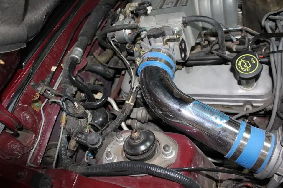

Car runs top notch from what I can tell. 15k miles and only mod is BBK cold air intake. I am thinking maybe this has something to do with it or else the MAF sensor?? I took the sensor off and cleaned it as best I could (there is a little bit of white residue, but not much).

P.S. - One thing I noticed... My Dad and I installed a BBK cold air intake in May, and 9k miles later, the filter (under the fender) is not dirty one bit.. I am wondering if the whole thing is even setup right and if this could be causing a problem? The light just started coming on a month or so ago, so it has been on with no problems...

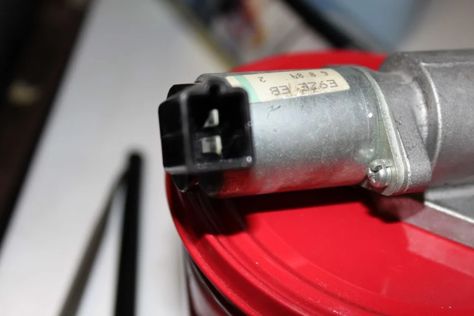

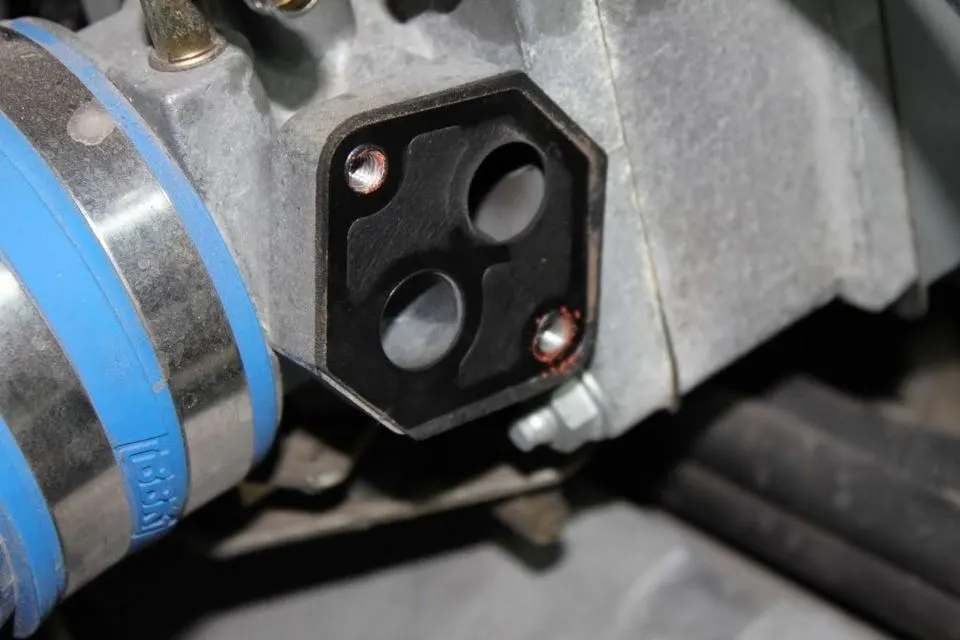

I took off the IAC - looked pretty clean - I wiped it out as best as I could - I even took it apart to clean in there as well. I looked for problems with vac lines. There is nothing apparent to me.

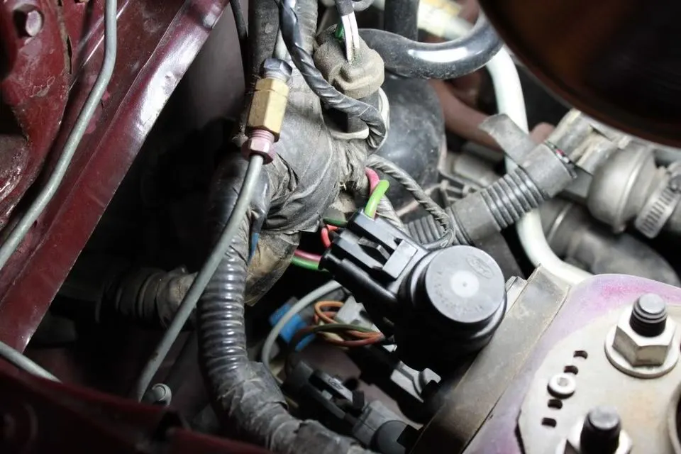

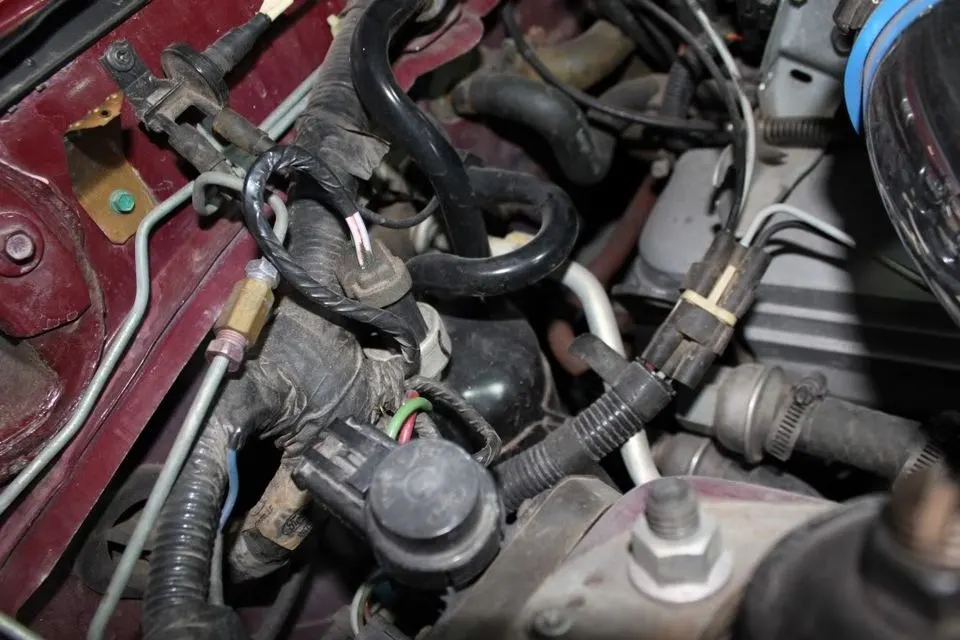

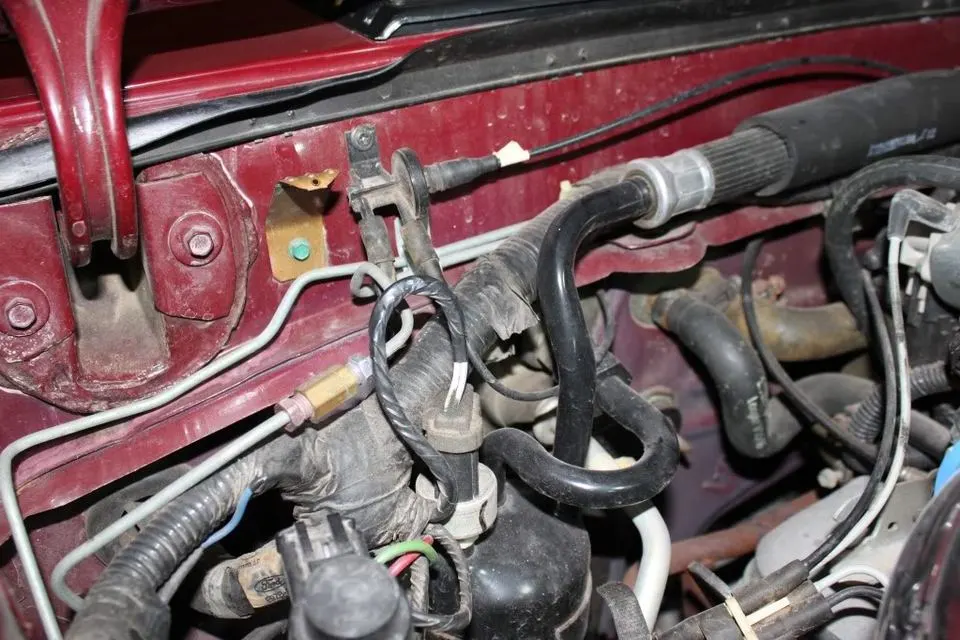

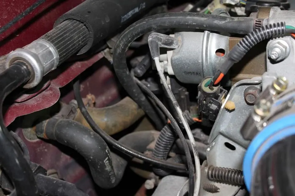

While those are excellent pictures, the main concern with the hard plastic vacuum lines is that they tend to crack in the bends and that connection points. You will need to do a touchy-feelly examination of them.

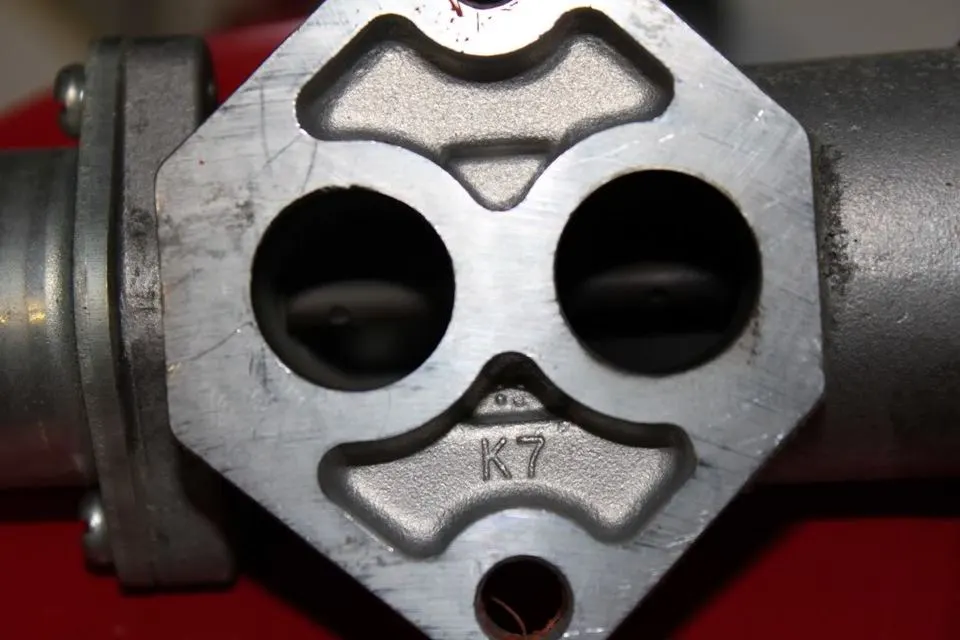

And a 12 is pretty much the same as a 13 so maybe I will do the same.. was your iac dirty? Mine wasn't too bad.
Well, it was pretty nasty. However, the bad one measured 10 ohms, and the new one did also. My indicators that it is fixed is the car seems to idle better (hard to detect since it is running rough), and the code went away.
You will all get a laugh at this (or tell me how stupid I am)..

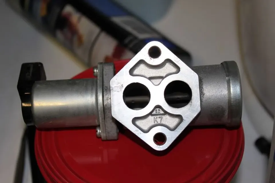

I bought a new IAC from Autozone (Duralast). JUNK. My car idled up and down between 550-700 or so. I took it back.

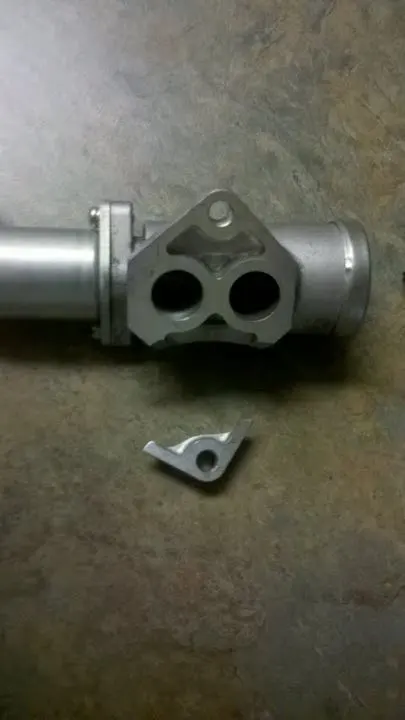

I put on my old IAC and this is what happened when I tightened it.
So I just now bought a Motercraft, so I guess I will see what happens when I put it on. This blows. Maybe everything will be fixed in the end. I sure hope.
