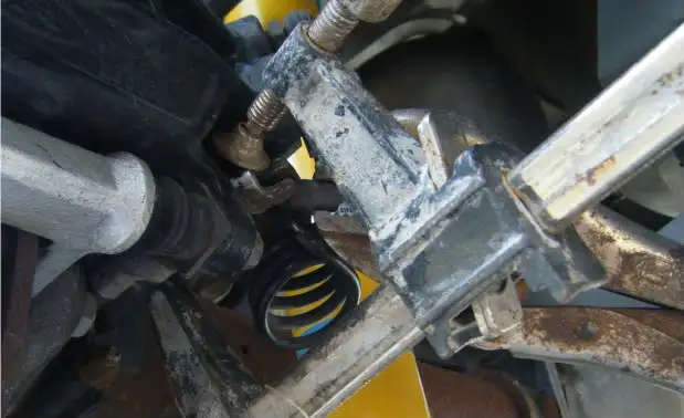

I did it with a clamp, vice grips on the cable too. Use the clamp to compress the spring back a bit. Works like a charm. I think I have a pic
don't mind the rusty tools... Seen some action.
