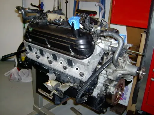

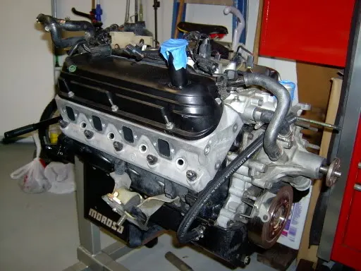

I have a Moroso pan, and I'm happy with it. They're all pretty similar I think
It's does hang down below the K-member slightly, but I've never had any issues with it in 4+ years of daily driving. My car has Eibach drag springs, so it's maybe 1/2" lower then stock, not much. Pretty much all the different brands of drag race oil pans are 9" deep like mine. The road race pan with the kickout sump might be a better option if ground clearance is an issue.

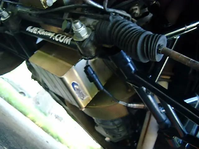

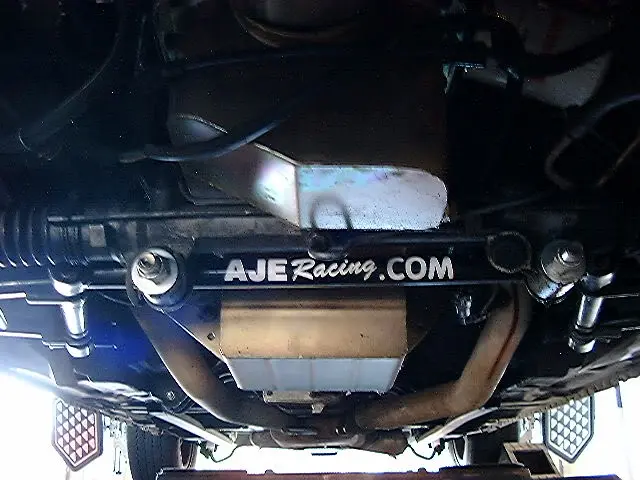

My car is lowered 1.5", I have also dragged my aluminum deep tranny pan a time or 3. I may need to go with the kickout.
Thanks,
Lems
I went with the pro power with kickout, it also has a crank scraper. I am going to try to get a windage tray to fit with the girdle. I might end up having to make one. Looks like a good pan.
