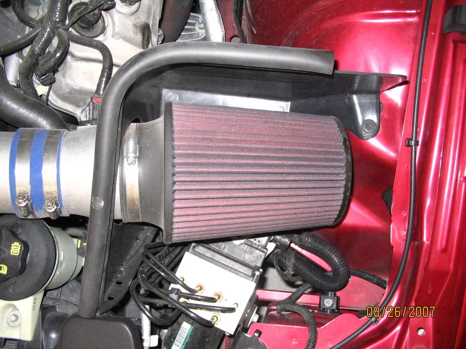

ABS: Look under the hood, front left(drivers side) and you should see a bunch of brake lines going in and out of a pump. That's the ABS pump if its there..

Here is an image of the ABS Pump:
