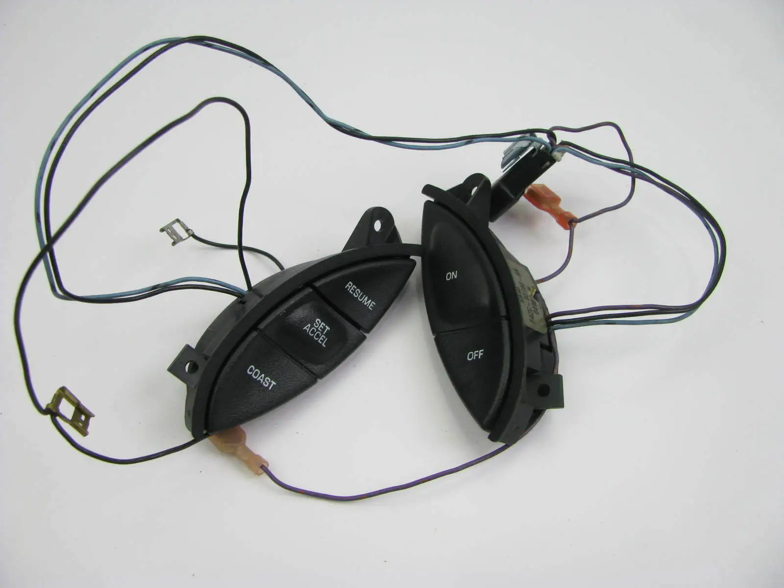

Factory controls, same from 94-04

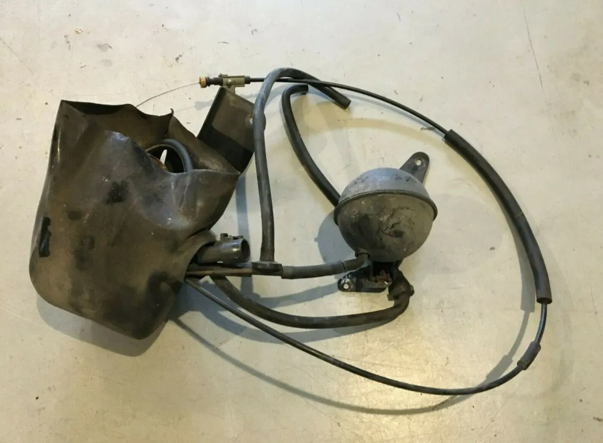

The 94/95 cars had a split design, so I'd need the electric actuator + vacuum reservoir and linkage cable

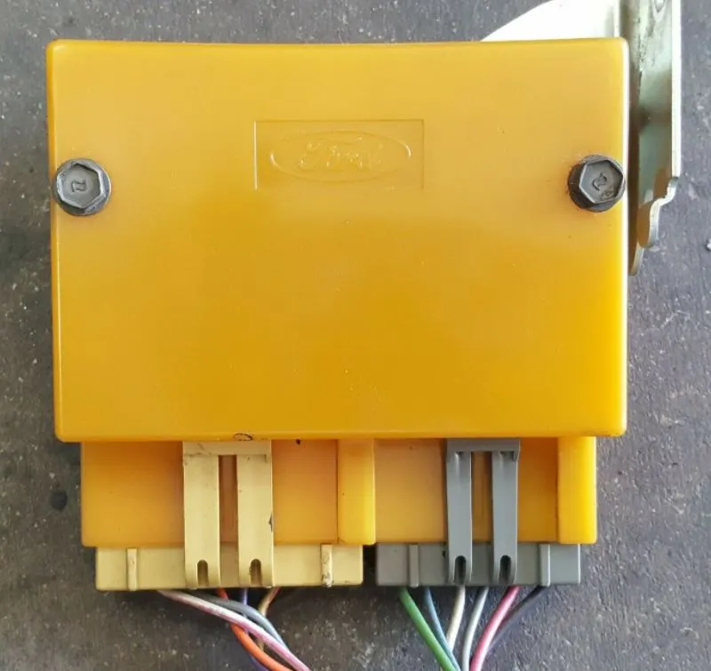

The module, brain would have to be installed. Presumably it goes under the dash somewhere?

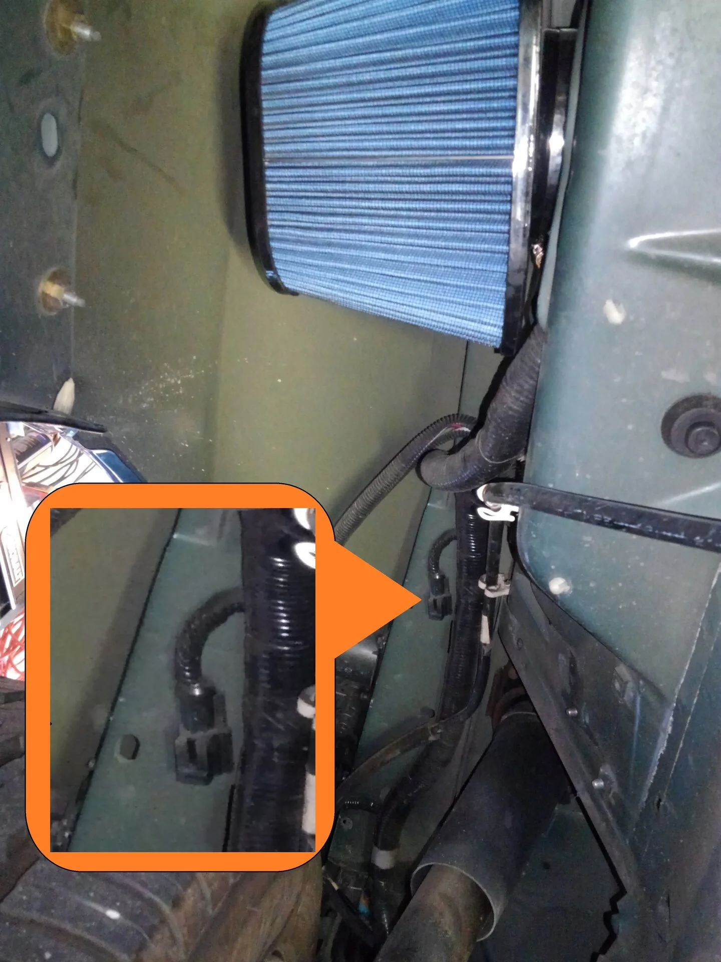

And last but not least, which side of the car does it install on? I thought I read Drivers side. But about a year or so ago I was under the Passenger side and noticed a misc plug that seemed to go nowhere. Wasn't sure what it would normally go to, cruise or abs??? I've yet to have a looksee under the Drivers side fender liner so I don't know what's up there yet, if anything

here’s my info on the 86-93 cars. In terms of how those were setup, the servo was in the drivers side fender. The wiring passed into the pass compartment where it plugged into the cruise module. Under the dash was a single body plug that plugged into the module.
I needed to add the vacuum dump and clutch cancel switches to the pedals. I’m fairly sure SN95s used these as well, so you’ll need to source them.
