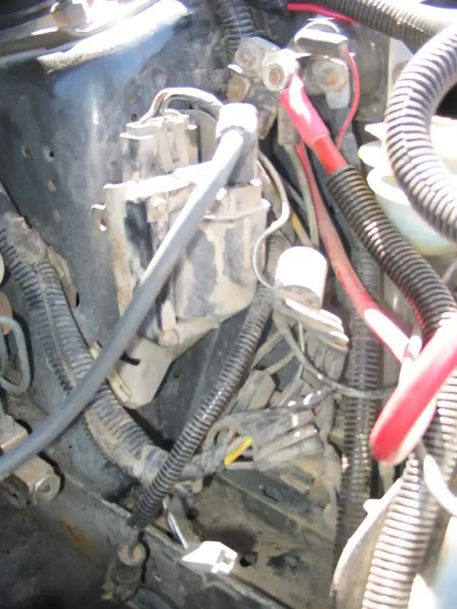

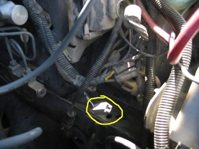

Still troubleshooting.. while checking near the coil I found this wire hanging here.. anybody know what is for? I can't find it on any wiring diagrams. The picture is looking from the radiator toward the coil (see the batt. cable, etc in the picture.)
bump .. anybody know what wire that is?
those wires... when i did my harness swap i tagged everthing not connected. that connector was one of those that isn't connected to anything either on mine, i have an '89 lx 5.0. i wouldn't worry about that cause it's part of the entire dash harness. if you find another connector on your engine and looks like it fits to it... maybe it does. but on my 89 it wasn't attached to anything. don't worry about it.
