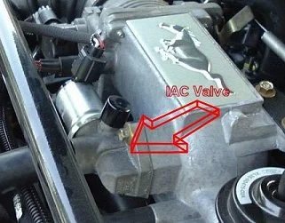

replace the IAC. easy fix and not very expensive to fix. i've had to replace mine 3 times already :nonono:

i just replaced mine and it died yesterday when i was taking it to a hobby shop to work on it. i almost wrecked too. this sounds like a problem that ford should f^ing fix. i'm suprised nobody has sued cause of it. what else could be the problem?
