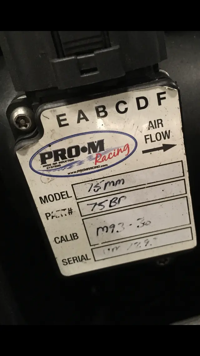

It's important for the MAF to be calibrated for the specific size injectors you are using. Post a picture of the numbers on the MAF. Sometimes the numbers tell what it's calibrated for. Mine does. In this pic you see M93-30. I have 30lb injectors.

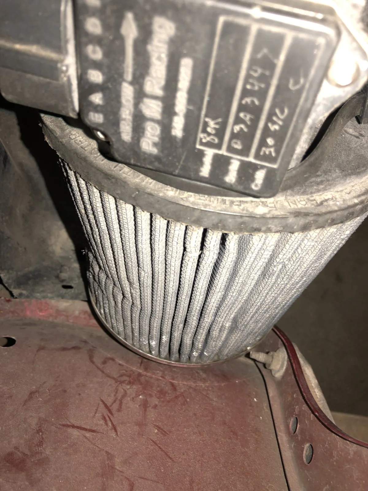

I don’t remember it having a sticker or anything like that, but I’ll send a pic when I’m home from school. Thank you!

That looks like a 30lb MAF to me according to the labeling anyway. With the SC you'll need bigger than 24lb which you currently say you have. I have 30lb on my setup and they're maxed out. It's not the recommended setup but I am cheating by turning up the fuel pressure. I've been lucky to get away with it so far.
You might want to go with 42lb and a calibrated MAF
Okay. So what kind of 30lb would you recommend? And thank you a lot for the help.

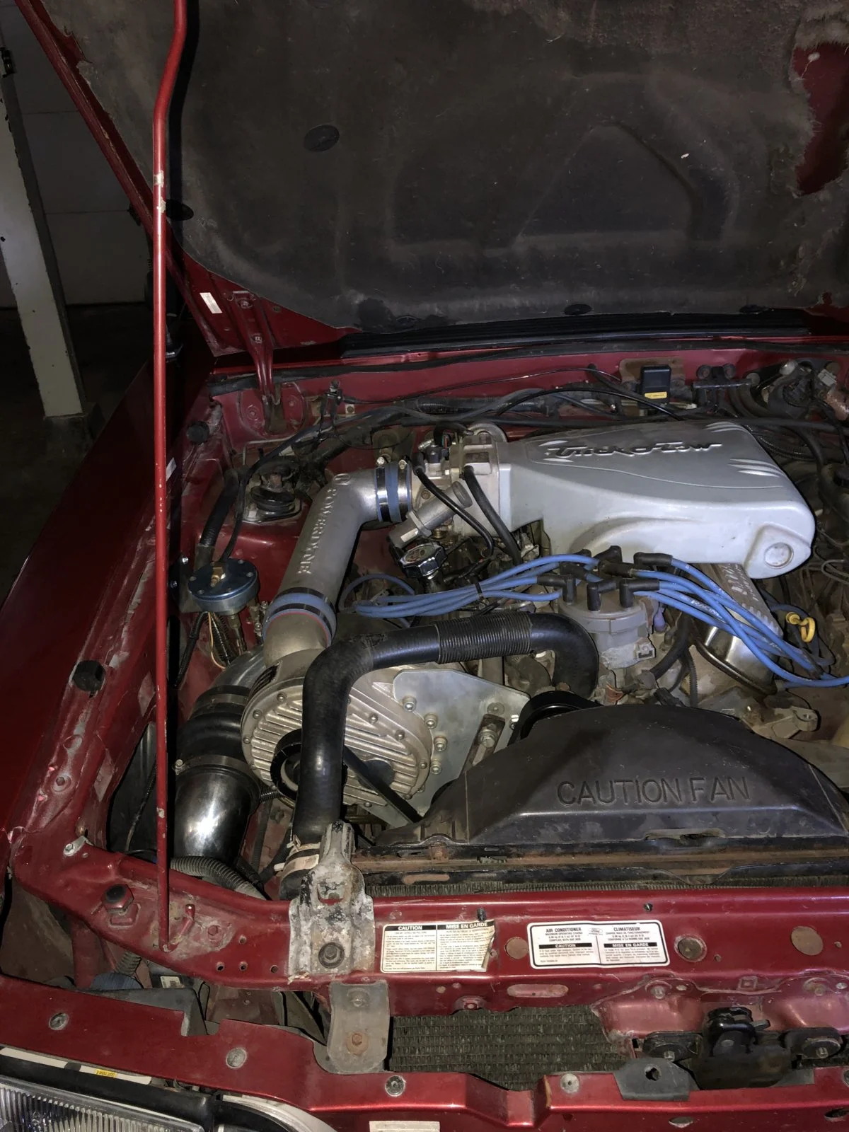

First of all, I’m not ready to recommend 30lb injectors. You may need something bigger, maybe not.
What is the rest of your engine setup and how much boost do you expect to make with that blower?
No matter what size injectors, I see another potential problem. You have a cone filter attached directly to the maf inside of the fender. That’s turbulent air at that point. Some mafs are designed to be used like that and some not. Some need to be further up the tube.
Where did you get this stuff? If you bought used stuff you don’t know for sure what you have. I’m not the best for giving advice on these matters but even experts would be chucking darts if they don’t know what you’re working with, or what your expectations or goals are.
What about your head gaskets? Are they up to snuff when it comes to significantly increased cylinder pressures that boosted engines see? My head gaskets failed repeatedly until I pulled the engine, decked the block, heads and used Cometic gaskets with ARP head studs.
I’m sorry to complicate the matter for you, but me throwing darts on injector size is sketchy at best, and only a small part of the big picture even if I was correct.
It all depends on the power out put planned for the car. If your looking to swap a pulley and push some boost through it and break stuff then you will need to toss the FMU, 24lb injectors and MAF for some 42lb or 60lb injectors, maf and a tune.. and like mentioned above the head gaskets will be your failure point. Plan to eventually experience the thrill of replacing them.
If it's a simple stockish street cruiser with out of the box powerdyne, then you should be able to get away with the FMU, 24lb injectors and calibrated 24lb MAF.

The no cone filter inside the engine compartment is one of the big "No No's" given in the checklist. You should thank @John Dirks Jr for noticing that problem.
