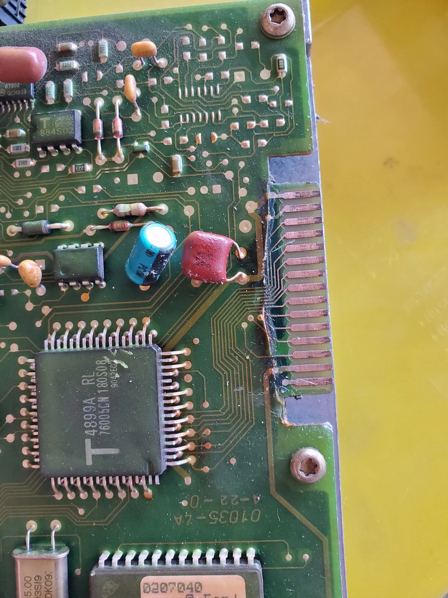

I pulled the codes but was told with a Quarter Horse tune / chip it may prevent the computer from communicating correctly and dumping correct codes. The code I got was 15. The ECU board where the Quarter Horse tune was dark so I thought the ECU was fried. I tested a second ECU I have with the Quarter Horse chip in it and the car ran the same. Any ideas?

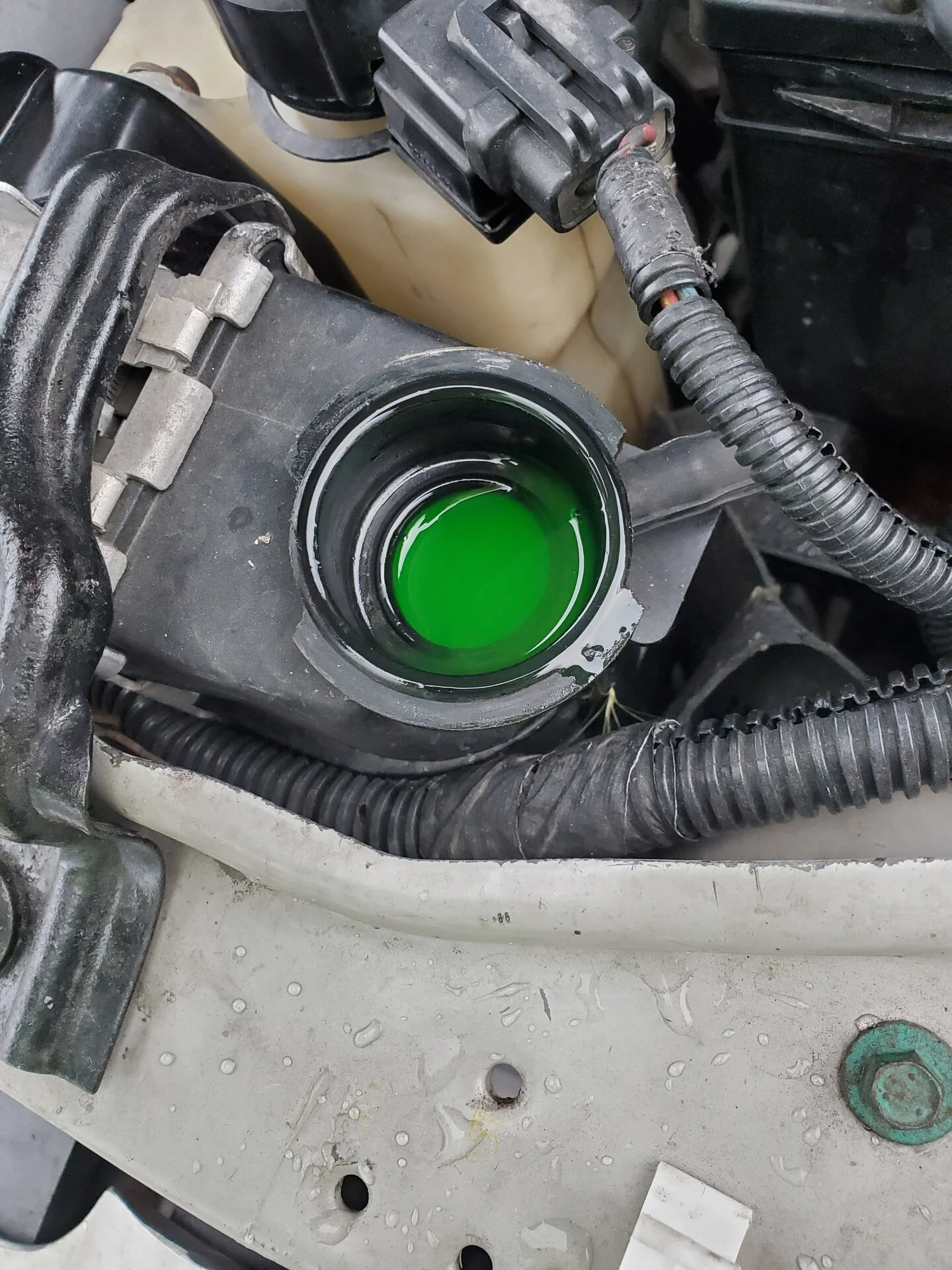

White smoke is generally an indication of burning coolant. Did you look inside the radiator? I suspect a blown head gasket. What were you doing just prior?
Literally just slow stop and go traffic temp got up to halfway but that it.
I didnt check the coolant, i checked the oil but it looked fine. I'll check the coolant today.

Ok so... I pulled KOEO codes and got 85 and 15. Great! Bad ECU right? Not so fast!
I pulled the ECU out and swapped it with a spare I have. I only did KOEO and only got code 85. I put the Quarter Horse chip in the second ECU and the car ran the same. I pulled KOEO codes with the chip in and it threw code 85, not 15. I did the KOEO codes again and got 85 and 15!
I'm not sure if the Quarter Horse chip is married to one specific ECU which would not allow it to run with the new ECU. I was told the Quarter Horse chip can prevent the ECU from throwing codes.
I pulled the ECU out and dropped it off to have the Quarter Horse chip checked the make sure it isnt bad.
