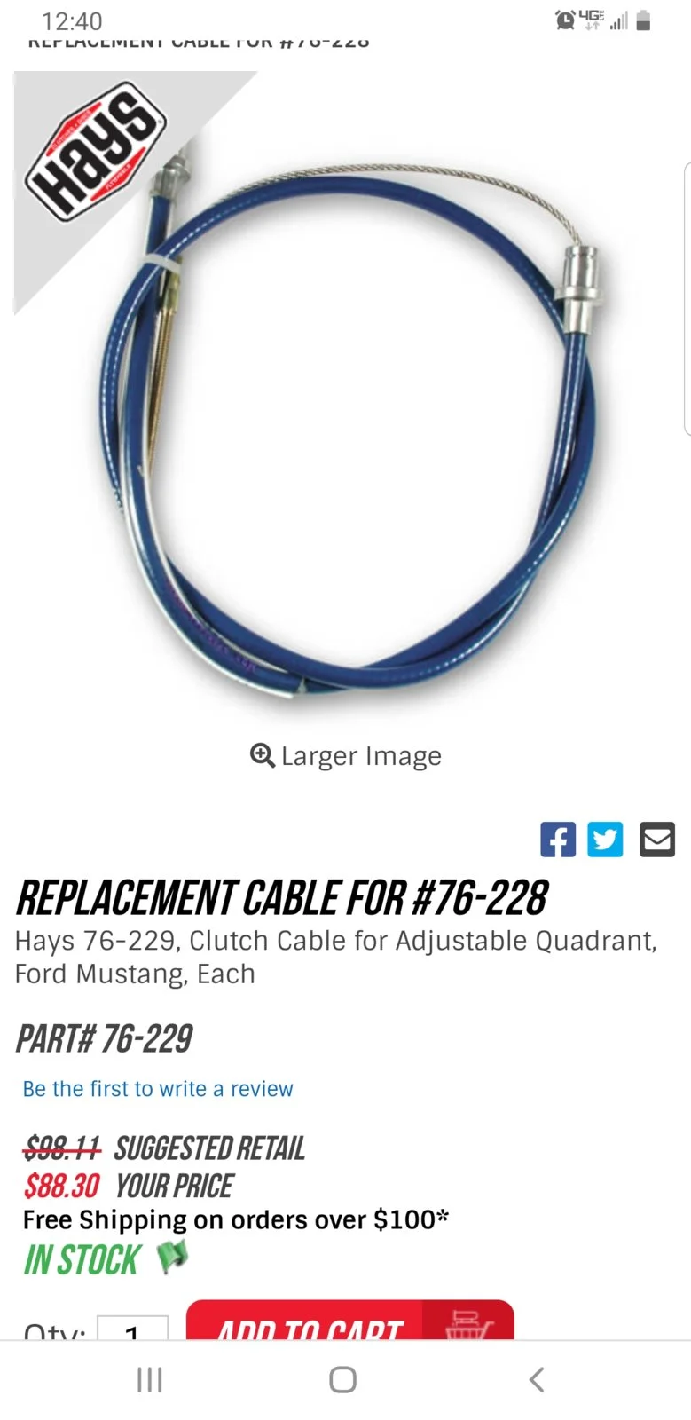

The way I can instantly tell a good cable from a cheap one is by the color of the plastic ends. If they're black its cheap... if its cream colored its good to go ( generally ).
This is a good cable
So just a update, I got the ford racing cable and installed it today and first off the pedal feel is 10x lighter then the brand new cable I had in it. And the problem of being hard to shift after the car warms up seems to have vanished now. So I guess there’s some truth in you get what you pay for. Now I just have to add some heat wrap to the headers. I also have the heat shrouding sleeve on the cable as well. Thanks for the suggestions
