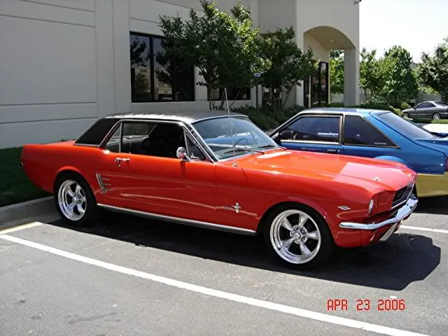

Here was my car kinda cleaned up at the Mustangs Unlimited car show this past weekend in Lawrenceville GA.

The great thing about it is I bought it looking just the way it does (minus wheels) on ebay 2 years ago for $4000. And the interior is in as good condition as the exterior.
I just put a roller 302 block with Scat 347 stroker crank in it with KB hypers
and XE274H flat tappet cam (long story)
AFR 185 heads
Professional Products air gap intake
C4 Trans.
3.55 gears
215/60/ 14 BFG drag radials
It is a very fun car and is still a little scary with all the extra torque the 347 produces over my old 306. After my first trip to the strip the other week I found I have to address my traction problems. Stock 40 year old leaf springs with no traction bars and KYB shocks and 620 lb/in lowering springs do not really help my little BFG's hook at the track.
