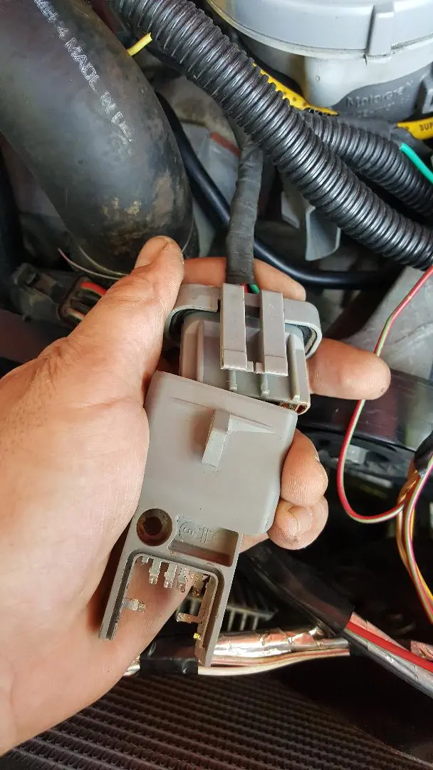

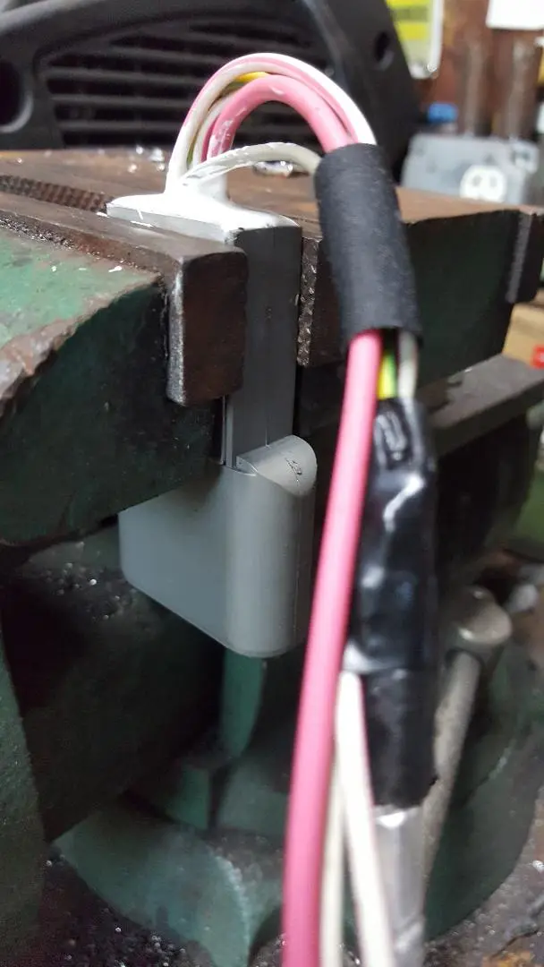

Took the column wrap off. Grabbed the connector and there's zero movement between the two halves. What do ya think?
Nothing jumps out at me as a "yes you need to replace that" based on photo and lack of movement. Unplug the connector. How do the connections look? clean and free of burns?
I'd probably save my money for now...but keep it in the back of your head

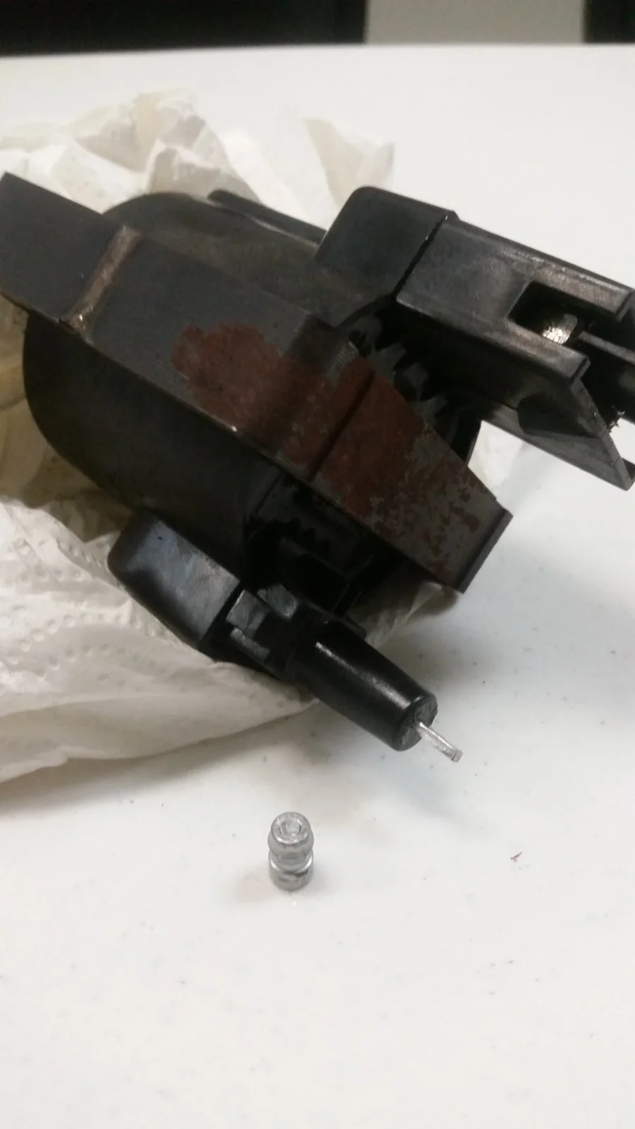

So last year was when I bought that cheesy distributor and ended up taking it back. Not really because it was not a quality piece but because it didn't fix the car back then. I was fiddling around then and took the coil wire off the coil and the stud or post had just broken off the coil. That was giving me the shutting off deal back then. So I put a new coil on it and it was good. No more issues.
Fast forward to now. As you can imagine, the first thing I checked a few months ago when the shut offs started happening again was the coil. Nothing found. I decided to forget it and move on....I mean, it's NEW. So today before I head over to buy the distributor, and after talking with you guys, I started having doubts. Nothing new for me since I doubt everything...lol. Just in case, I removed the coil wire again. Post stayed in place and didn't move when I shook it....much. Got to my friends car lot where I was going to swap the distributor. There's a nice shady spot in the very back and new asphalt. No dirt! A buddy of mine happened to be over there and he walked over to see what I was doing with the hood up. I told him what I was doing and just for giggles, told him to remove the coil wire and see if he saw any movement from the post. The thing came apart again just like last year!! Junk parts I'm telling you! I can't see up right now on my phone but whoever posted that the word NEW means nothing anymore was exactly right. Dave!
Here's the good news. Lifetime warranty. I took the coil off and ran over to O'Reilly. They looked it up on my account since I didn't bring the receipt with me and gave me a new one...No charge. They said BWD, which was the one I bought last year, was bought out by Standard Motor Products. So the new one is the Blue Streak Standard Motor coil #FD478. I put it on and the car started up but it always did that. I'll drive it for a few days or weeks and hopefully this particular problem is fixed. Thanks for all the help. If it weren't for the discussion today making me pause a moment I'd have bought the distributor already....May still have to but we will see.

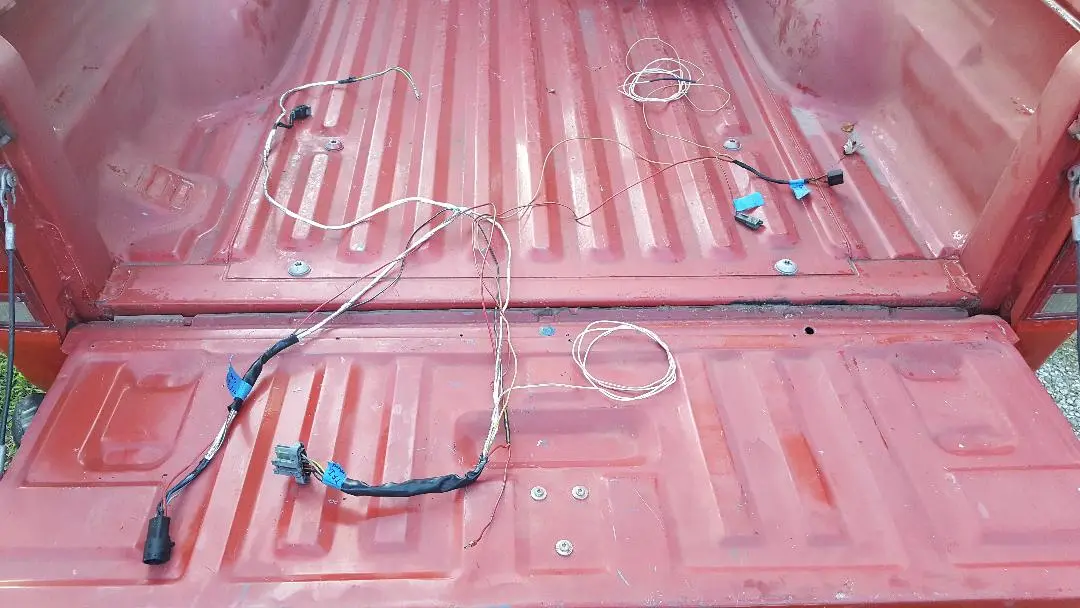

I drug it home and I installed the closed bowl type of distributor (SN95) with a factory PIP in it, and butchered an old 92 Thunderbird harness for the TFI wiring and relocated my TFI to the core support. I used an old no-name brand TFI module from the junkyard and cut it in half to make a connector because my harness has been wrapped to where my TFI connector won't reach anywhere. After soldering I filled the "connector" with marine grade high heat epoxy.
It's been reliable so far, but I've only put about 200 miles on it. I will say the TFI module and heatsink, after being relocated, doesn't even get warm to the touch now.

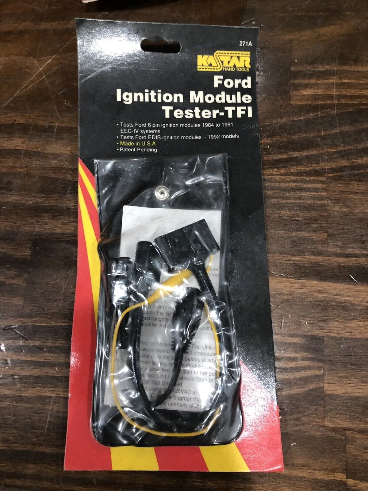

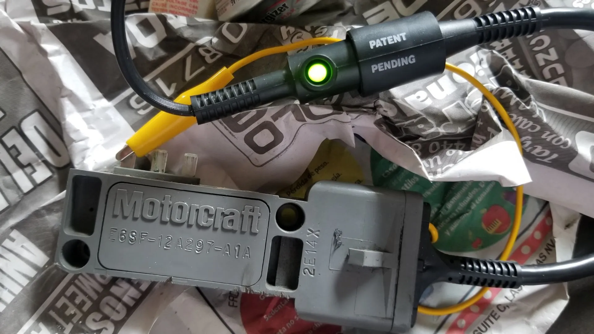

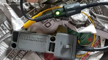

you need to buy this to check your TFI Module https://www.ebay.com/itm/2555371810...d=link&campid=5335821607&toolid=20001&mkevt=1
you also need to buy a 9volt battery, this TFI Module tester works amazing and comes with instructions on how to set it up and use it, 0nly 9 left in stock. no more buying dud TFI's, bring it with you while your at your auto zone parts store to test before you buy.
