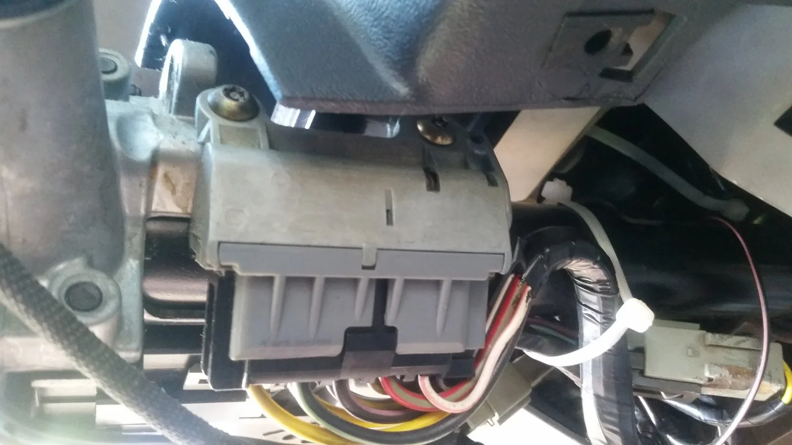

Are you 100% sure its the distributor? This does sound like a classic case of the ignition switch. I just replaced mine again this past weekend as it was starting to separate a little bit. I didnt want to have a future issue personally on mine.
Easy to check them to see if they are coming apart or not. I have had them do funny (not hahaha funny either) things before like turn signals not work, or stop running while driving, or just no start bc it broke in half.

Can you take a look at this part?
Do you see a noticeable gap forming between the metal and plastic? Was yours replaced in the recall years ago or have you changed it since?
Well...I'll have to get stuff out and check it but I think I'll go do that now. First though, do you honestly think it could be losing ignition and not affect the dash lighting or gauges at all? I don't see how that's possible. And I'd have look on my chart to be 100% but I'm pretty sure I replace that switch because I remember taking one apart to look at the inside.
Took the column wrap off. Grabbed the connector and there's zero movement between the two halves. What do ya think?
The ignition switch has multiple contacts on it so it doesnt mean that you would get a flash of your lights. As I mentioned, I had one go out and it only effected the turn signals. The test it do as mentioned above to see if there is a gap between the metal and plastic housings. You also should not be able to push the two half together in/out.
No movement at all.
