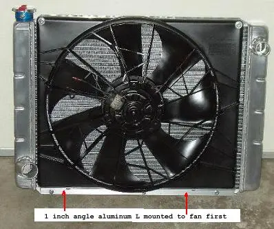

It is your fan most likely. I have a 393 stroker with a 3,500 RPM stall speed converter. I drive it on the streets with no over heating at all. I have "2" B&M 24,000 GVW trans coolers in front of the radiator to keep the trans from over heating, and with all that heat and the heat from the enine, it has never gone past the N in Normal evem in stop and ho traffic. The stock fans are just able to keep up with a stock engine, and the Black Majic fan even say for below 250 HP use. Get a Mark VIII or a Ramcharger fan, and forget your cooling problems. I payed $30 for my Mark VIII at a junk yard.
The Mark VIII has 4,500 CFM of air flow. Heck, I think it may even cool it with out water as air cooled :)
