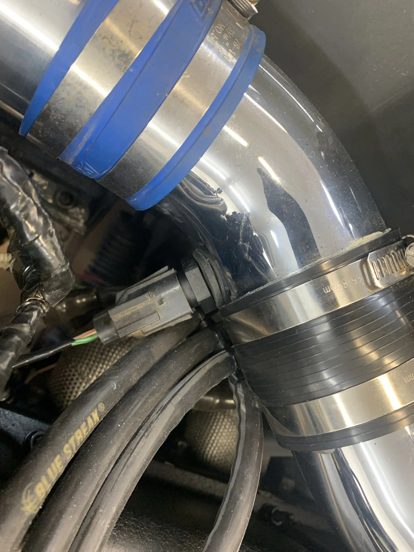

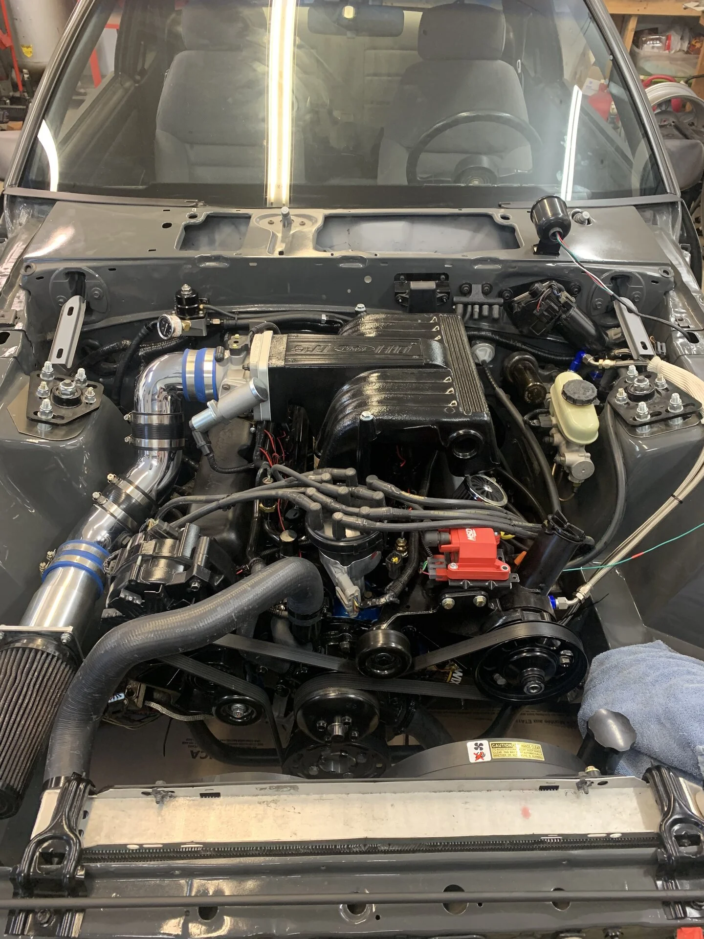

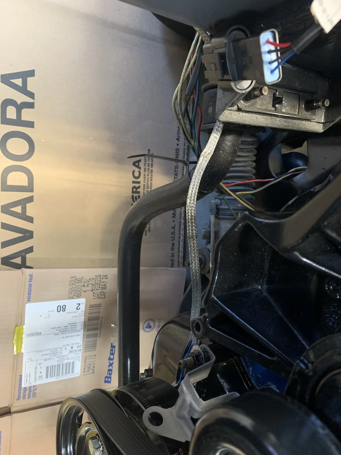

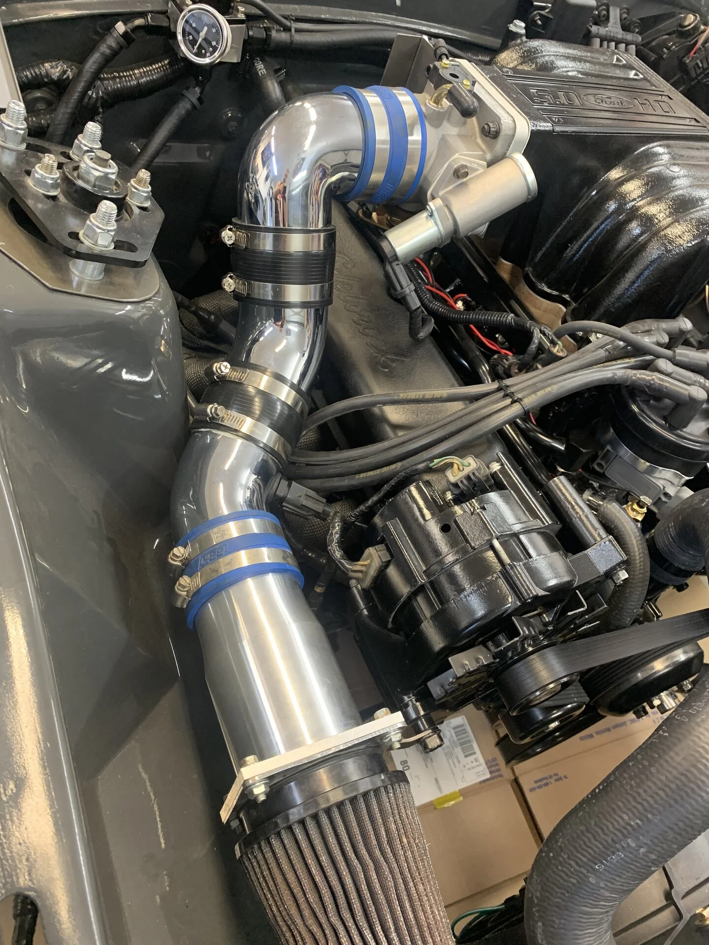

The maf matches, as far as I know the grounds are in place. Isn’t there only the one ground right next to the ecu in the pass. Kick panel. How many other “ECU” grounds are there. And the custom part is that it just has a collection of couplers and 45s from the parts store. I drilled a spot for the ACT also.
There’s a couple pics, not sure if that’s the stuff you were after but I can always take more
Where is the maf?

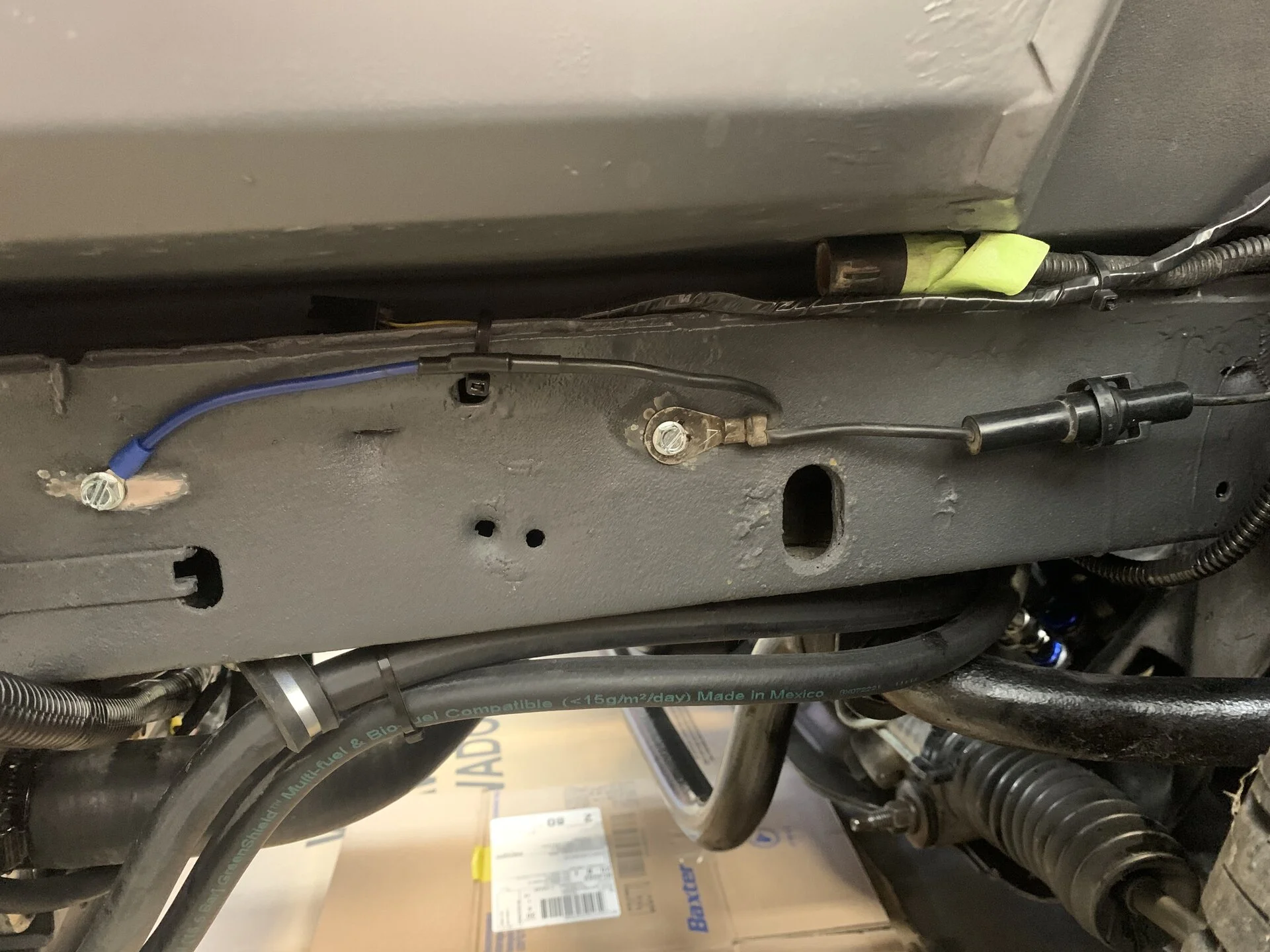

there is a ground in the injector harness, I think it is orange, bolts to the back of the passenger side head, also a ground from the drivers side head the the firewall. Appears you have the computer ground from the negative bat cable to the inner fender by where the solenoid would be and then connects to the cylindrical (black) connector in the harness under the solenoid area.
Reactions: manicmechanic007
88 should have the body and processor main ground out by the battery
Round connector to start with, big black wire about 10 or 12 gauge
Bolts to the radiator support on most car lines
Maybe the fender apron on yours
