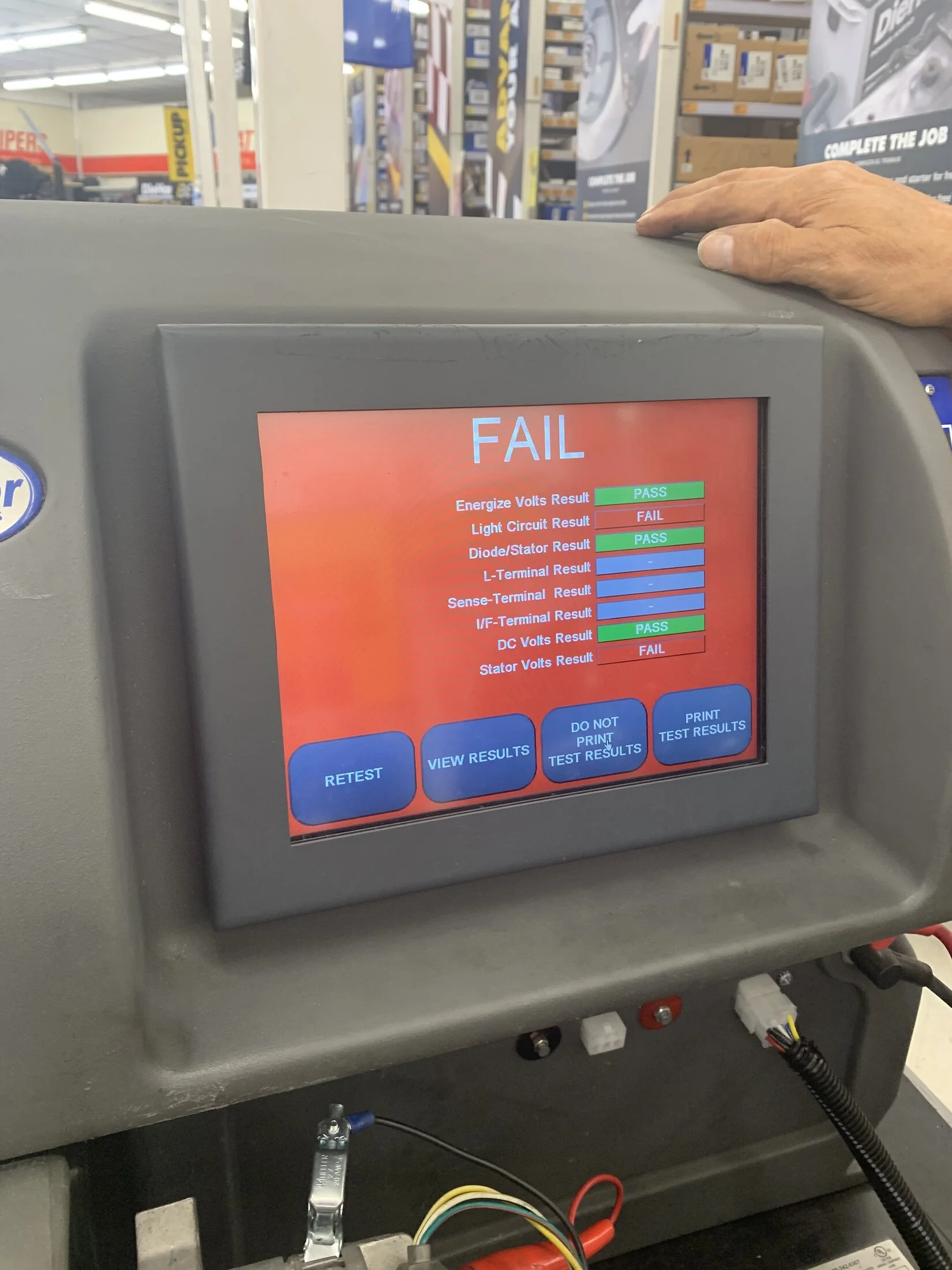

Update! I removed the alternator to have it tested & it failed. I know we are thinking it might be the tfi/distributor wondering if it was the alternator reason why it didn’t want to start then shut off on hiway & then kicked back on again?

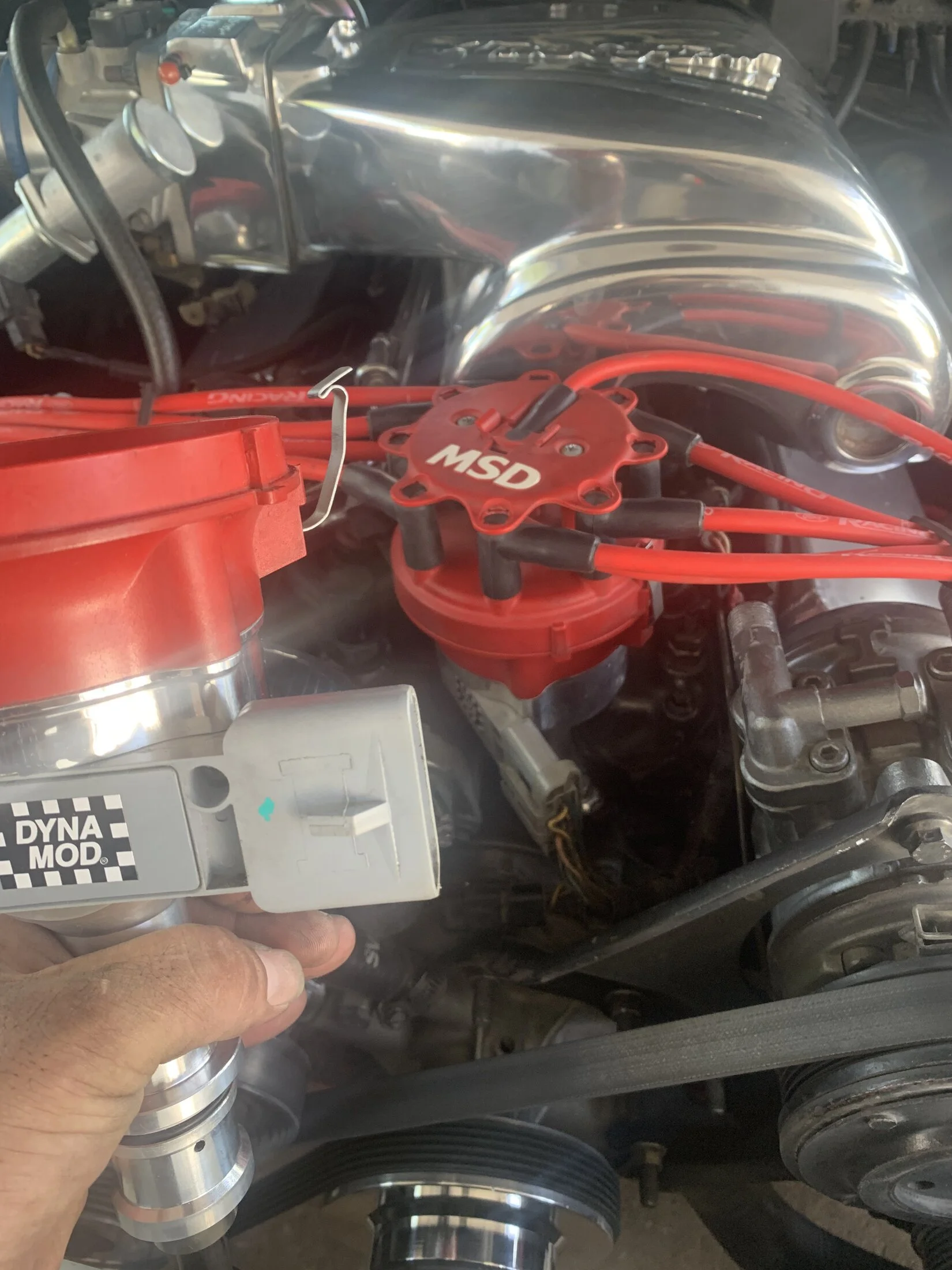

I just swapped to a different distributor still wants to stumble shut off. I checked coil has light both sides key on. I’m gonna swap the fuel regulator see if that helps. I also have had a raw fuel smell while driving. I removed the vacuum hose off the regulator don’t see fuel. Only other thing I can think of is ignition switch or fp.By the way the distbutor in my hand I just removed it and that’s the one that car was shutting off with and backfired on me this morning

Check the computer ground by battery. A bad fuel pump relay or pump can cause cut off issues but not common to fail that way. TFI usually has to sit and cool down before restarting. If your coil is shorting you should be able to see it in the dark reving engine. Sometimes you can see spark jump. Usually, will cause weak spark or no spark. I'd ohms test the coil and clean all the ground connections. I'd also check the ignition switch wires and switch body for looseness or overheated contacts.

How can I see it in the dark for the coil? What is spark jump? Fuel relay I bought 2 weeks ago along with o2 sensors.ignition switch was swapped about 6 months back along with sp wires. Now one thing I will say o know car running lean cuz I see it on the plugs and I have been driving with bad afr gauge sensor but not sure if that’s why it’s cutting off and that’s why I was suspecting the fuel pressure regulator
I'm inclined to think it's a connector or loose wire/ground somewhere also.
Probably not going to be fun to track down.
The reality is that it would be easier to fix if it was plain old broken.
