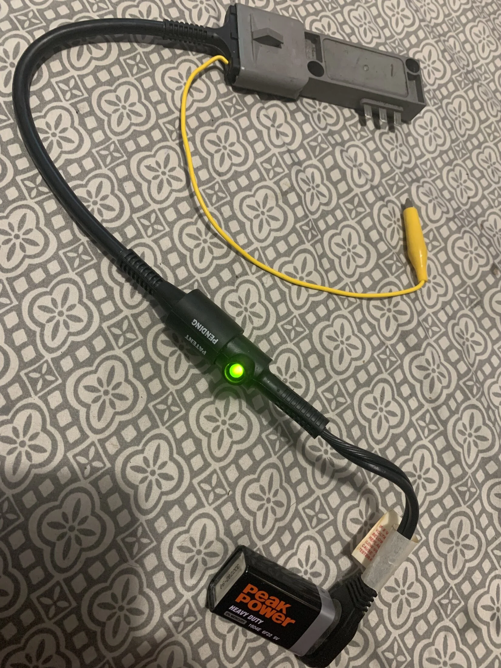

Brother I got it in the mail is I know your supposed to connect the yellow to the #7 top one but it’s already lit

That is what it is supposed to do after you connect to the 9volt and you connect the plug into the TFI the light will turn green then when you connect the yellow to the #7 top one on the TFI the light will turn bright green meaning the TFI module is good. And if the light turns off the TFI is fried.

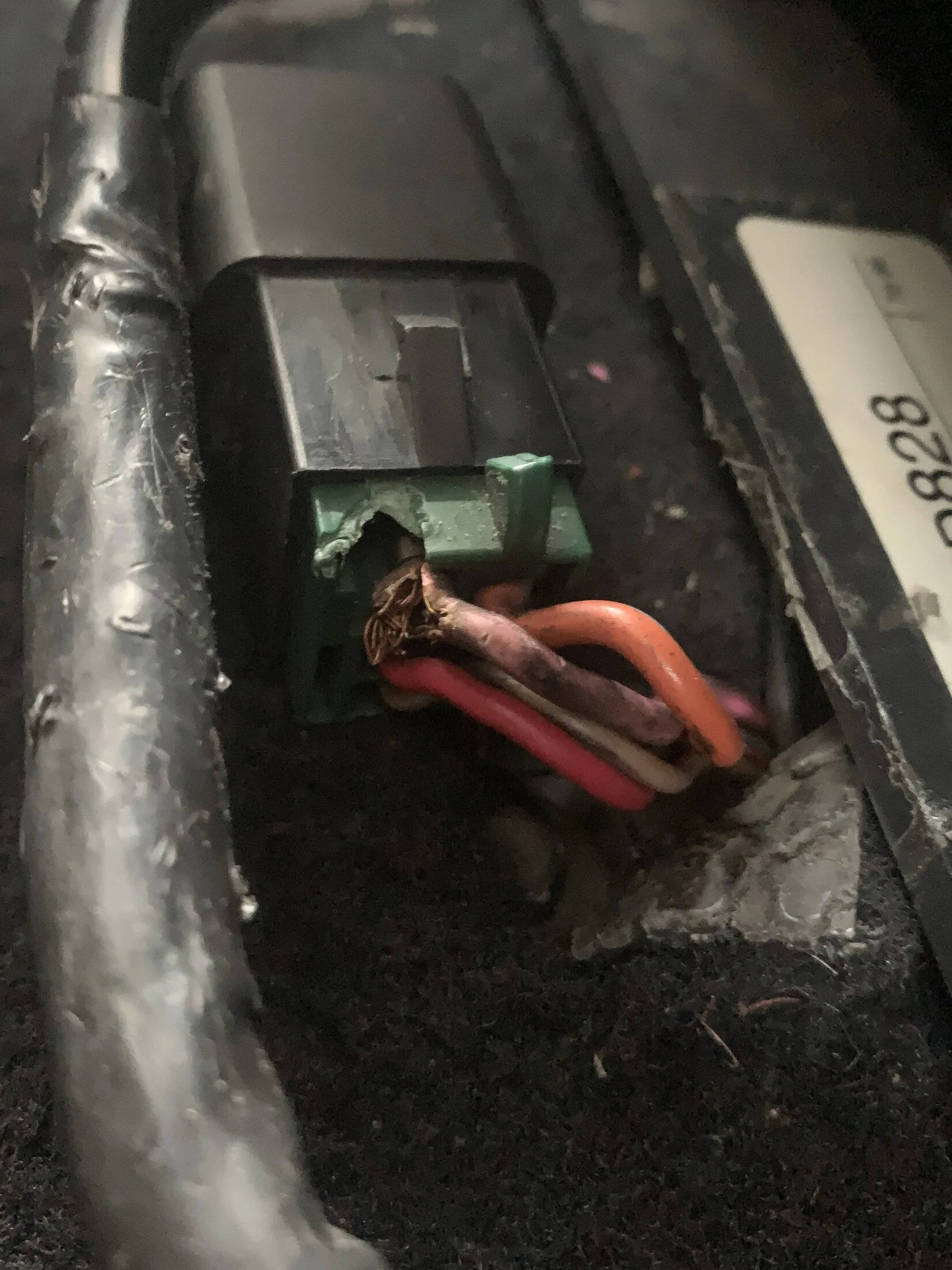

Yes before and after. Starts stays on idle for a while maybe few min then shuts off. Janet had issues or done anything to it. Fist sign I had a problem I saw a battery symbol while I was driving. Had alternator & battery tested cleaned all grounds ran fine then Sunday last week it did a crank no start. Called tow truck while waiting I tried starting and it fired up drove on hiway and it shut off engine. All lights on still kicked on drive it fast home. Ever scince i start it idles a while & cuts off. Ran codes getting 85,10,18. Replaced new fp,fp regulator,fuel filter,replaced fuel relay,used mood light(blinks) tested tfi I actually swapped distbutor noid lighted both they blink tested both tfis, swapped coil plus tested 3 that I have 12v both sides of coil used test light neg side coil blinks when cranking. Replaced cap,rotor,ignition switch. 12 volts injector connetor,tps set at 1v , cleaned maf no maf code just wanted to test. I removed the pump shut off switch in truck and spliced wires together so no worries on that . Swapped ecu from my other car same thing.Swapped map sensor still did it. All vacuum lines look good I only see a little arching on spark plug #1 and on a wire #8 just a little . Car is due for spark plugs thou but not sure if that would cause crank no start. Now when it does do crank no start I need to test coil but I get caught off guard not expecting it. O the iac I bought few months ago new along with ecc relay and wot relay. Test light on 3rd wire on tfi connector lights up. Now I do have one other issue other then spark plug wires and plugs(waiting from lmr to ship) the fuel pump relay connector is messed up and the black pink wire is iinfa hacked as you can see. Ordered one from lmr to just waiting.Ive been outside trying anything that comes to mind past week
