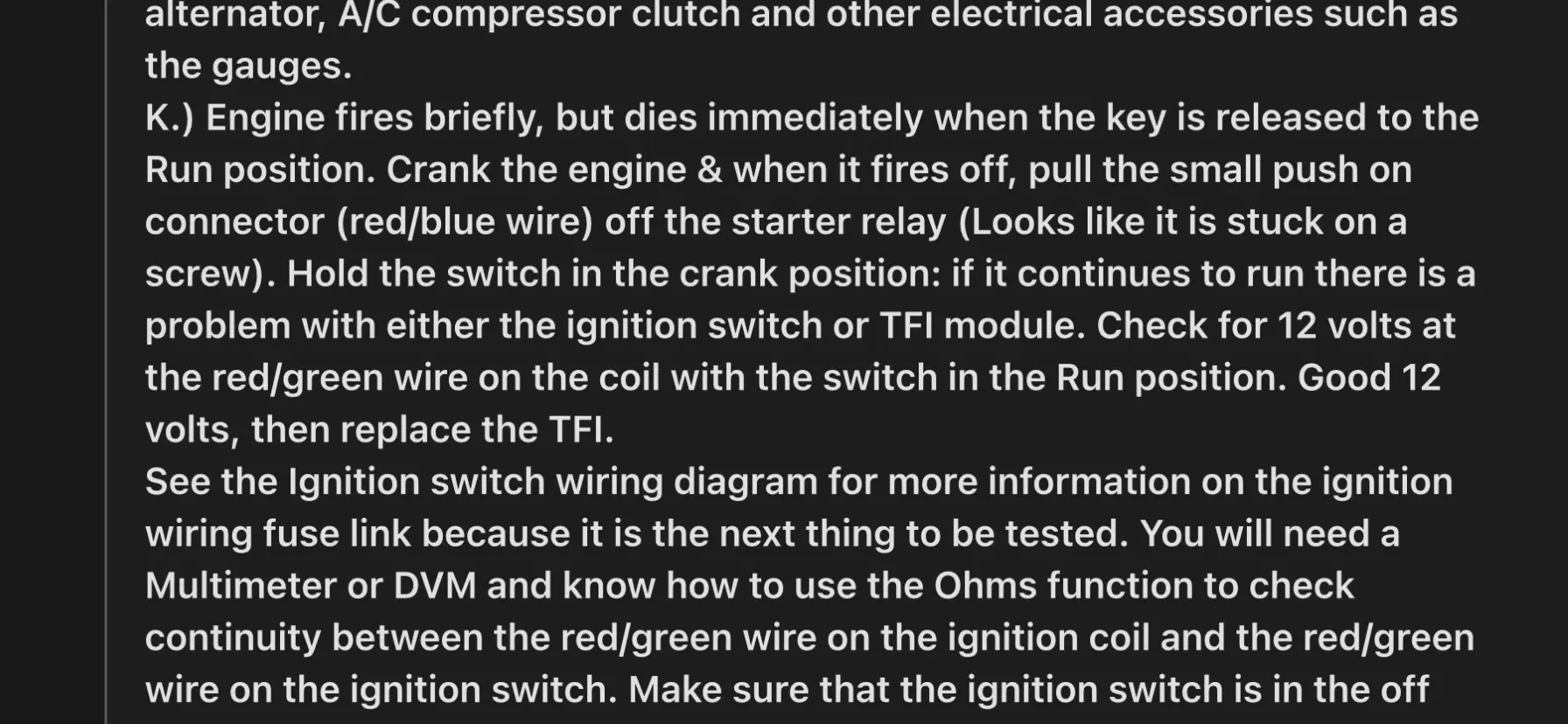

Ok on k in the crank no start it says key on check for 12v on the green/red wire at coil ,Good 12 v replace the tfi. Is that correct? I know your supposed to have voltage there shouldn’t it be 12v?

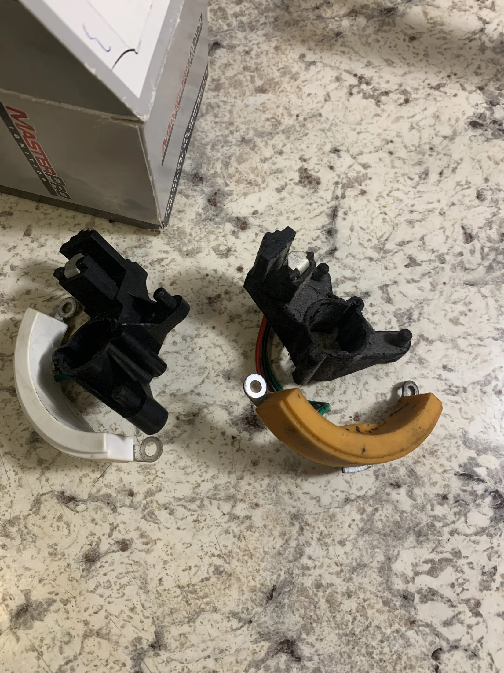

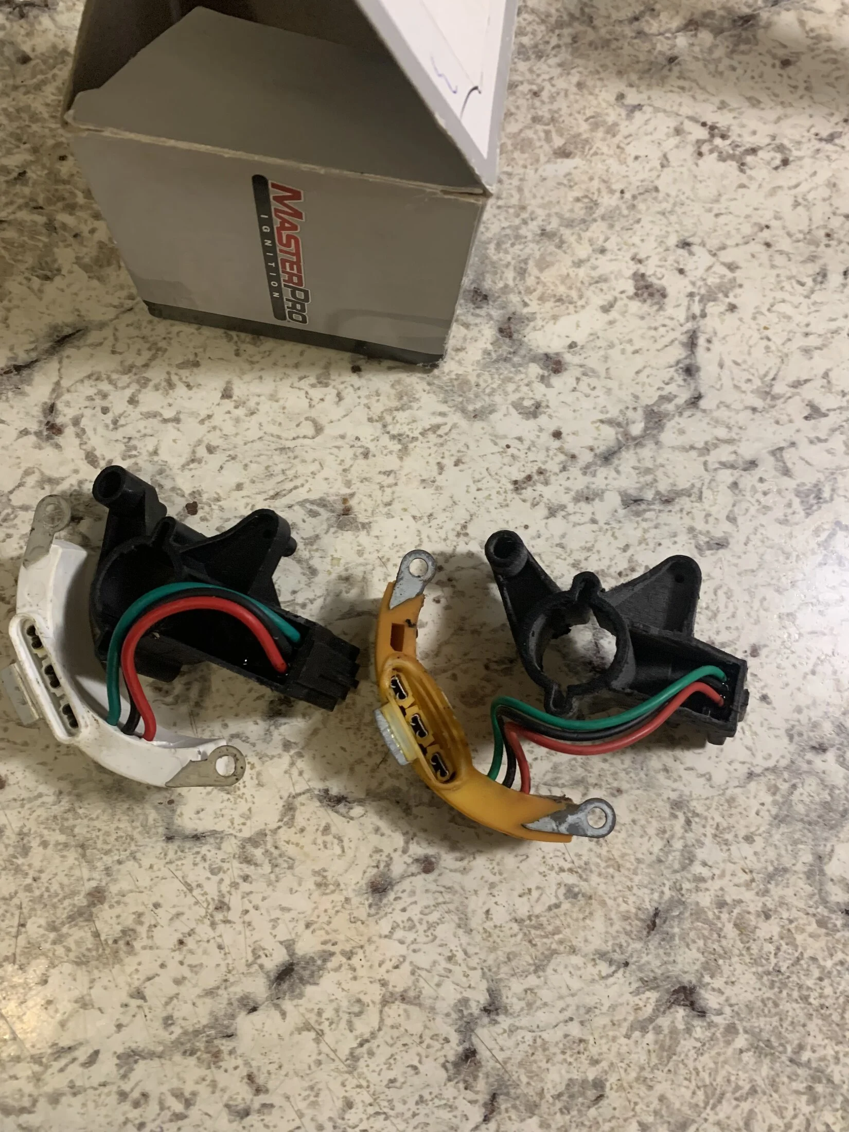

What brand distbutor are you running? Did you or have you been noticing the battery symbol comming on?In my case I cheaked everything! Had both battery & alternator tested 2 different places just in case bought fp,fuel filter,regulator was on warranty swapped it,have extra coils,swapped them,swapped extra iac,cheak tos voltage,Charles both sides of coil for 12v,bought new ignition switch, swapped ecu from other car, have spark cuz I see it but I think it’s intermittent issue with the pip. I also swapped ecc relay,fuel relay,needed new plugs & wires. I bought new pip from orillys swapped it now I’m just waiting on tfi from lmr Tuesday. I also contacted d.u.i performance distbutors & they are sending me a pip & tfi even though it’s way past warranty. Asking what distbutor you got cuz the dui the gear can easily be removed without a press.What I do is I leave it idel outside few times to make sure it dosent shut off. Towing is expensive. Then when I feel like it’s ok I’ll go up the street for gas come home let idel then drive around my neighborhood few times. When I feel like it will be fine I’ll cruise it hiway till it’s safe. O & keep running for codes

mow one thing that I like about the aftermarket ones is the they add some sort of rubbery coating on the pip. The new O’Reilly is the white one the yellow one that I suspect is bad has the orange coating. I think it helps with the heat to protect the sensor. I have 2 distbutors from dui & I’m gonna fix both with new pips & tfis. My car did crank no start then it shut off while driving hiway. What its doing I start it let it idel and it just shuts off hope this is the issue little by little I hope I figure it out

I think you are heading to success, this is the last O'Reilly one for me, ill look out for a sale on a aftermarket upgraded one.
