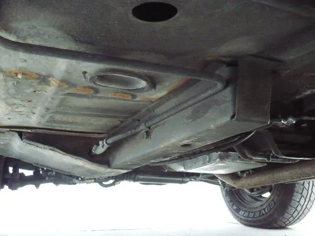

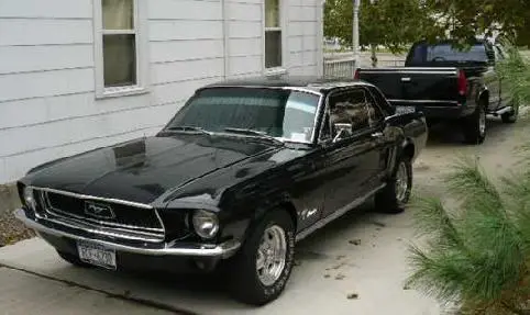

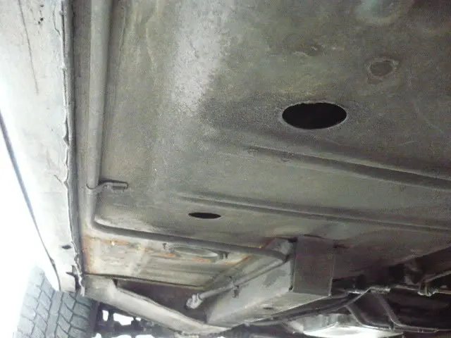

Car's for sale now if anyone wants a Nevada basically rust free car for 5K w/90% new parts, would make a good V-8 conversion.
Will post and add later in the classifieds here, car is in Binghamton, N.Y.
