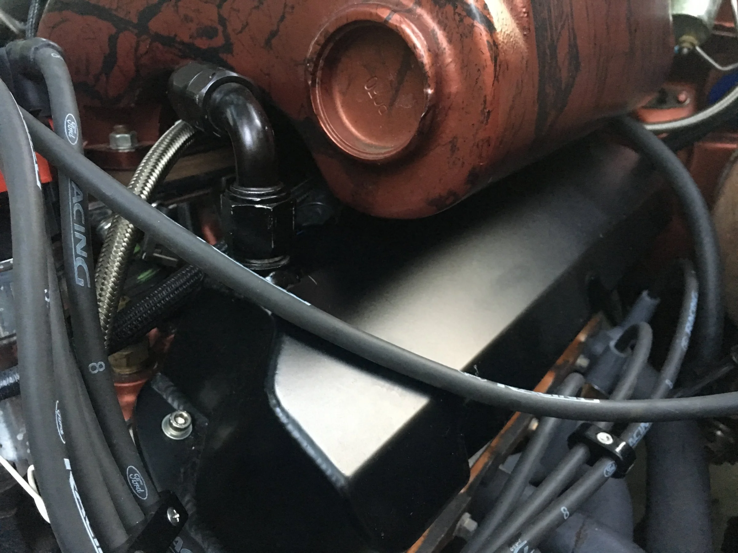

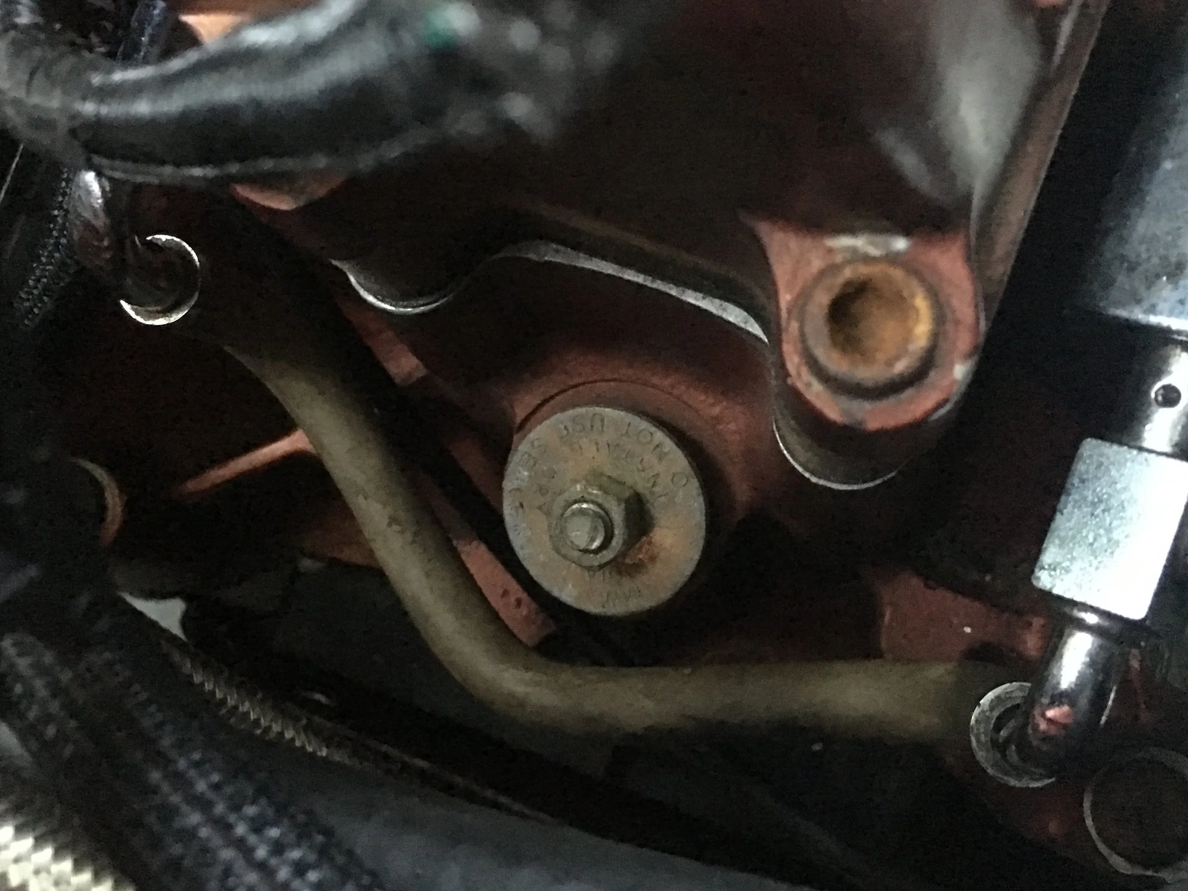

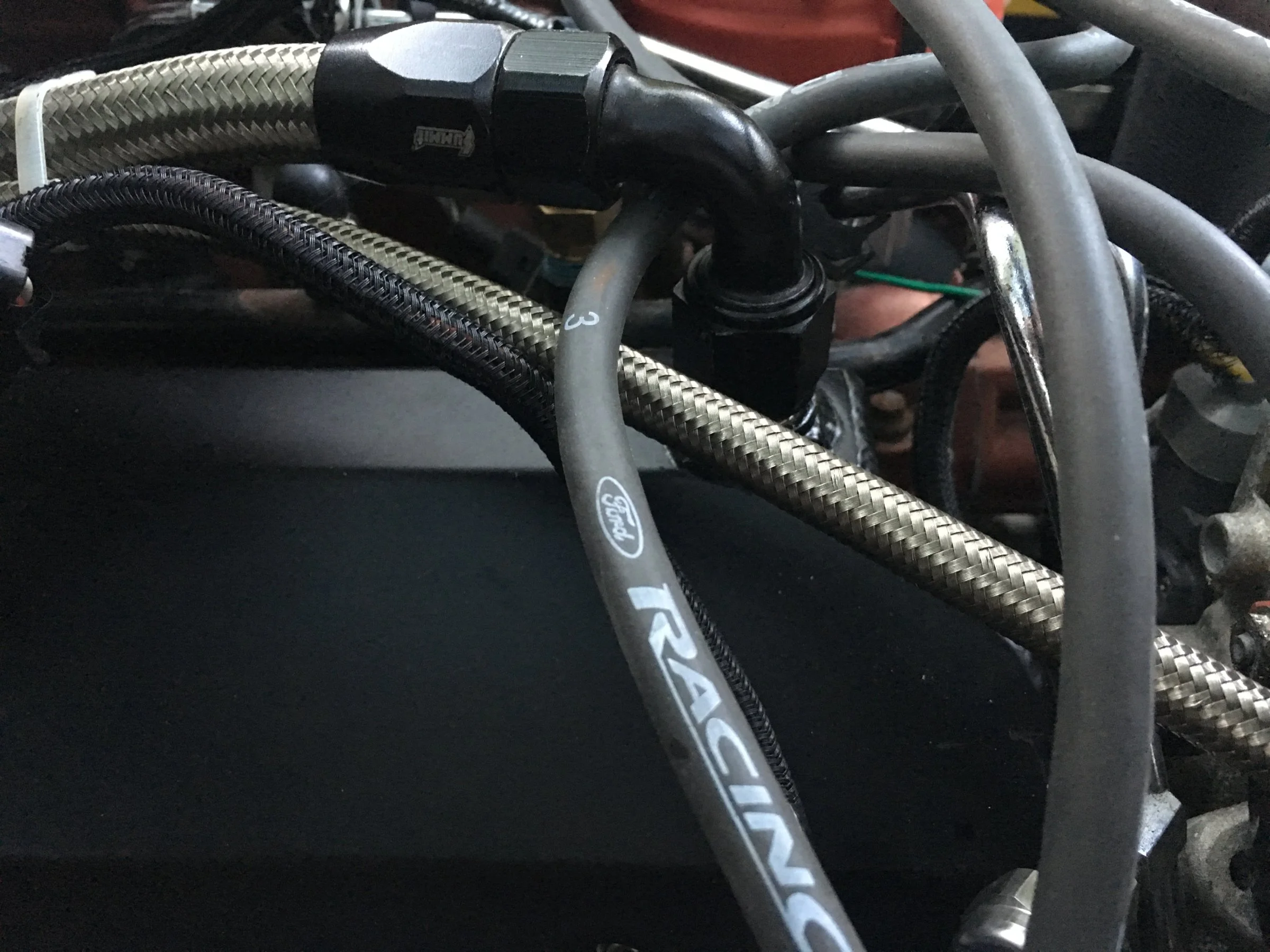

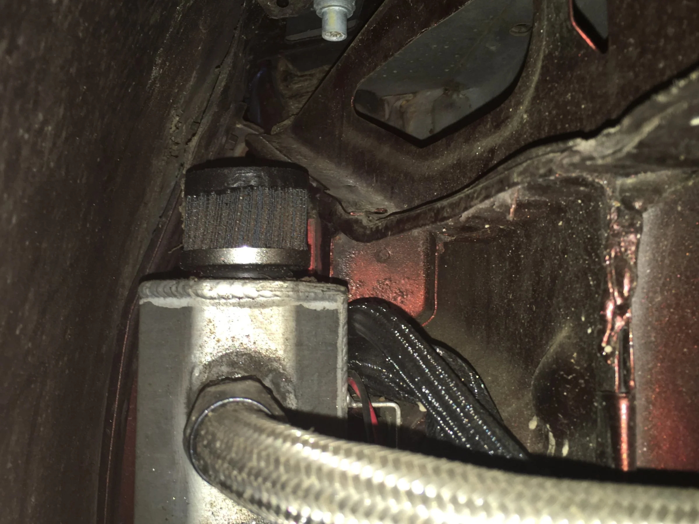

You are EFI right? Is your PCV in the back of your intake manifold present and functioning? I believe most boosted applications people are plugging off the PCV in the back of the intake, capping off oil fill barb and leaving oil fill cap on the neck, then installing bungs into each valve cover and running lines to a vented bottle/catch can. A lot of people have success with this method. Some still see some oil in the catch if they are in boost a lot.
@TOOLOW91 @MikeH686
Yes with my car i had the pcv plugged and two -10 bungs welded to a set of aluminum valve covers and they run over to my catch can in the fender well.

Did all this - Tried to keep the stock PCV with a turbo coupe substitute and it didnt work out. Plugged pcv and ran an open breather on the valve cover oil fill cap with the stock motor with the A trim making 7.5 psi -This was fine. Once my 363 went in and i started making some real pressure i began to sling oil out. Tried open breathers and had the same thing. END game was the same setup mike has. You could weld fittings in the back of your valve covers and use black woven hose to hide it as much as possible. My catch can is behind my pass head light in my bumper you cant see it.
