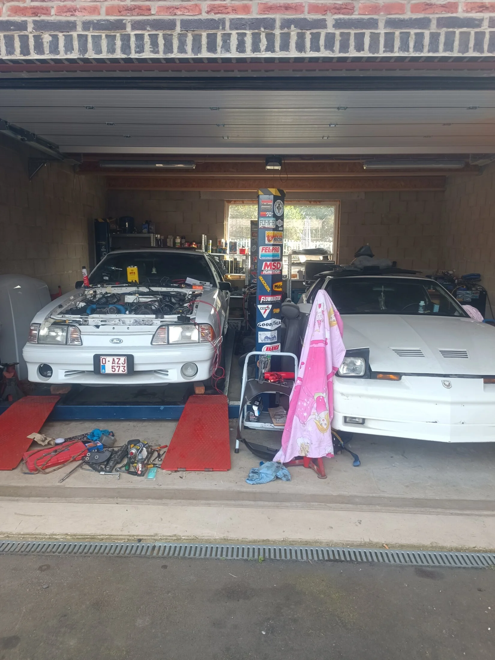

When are you going to post images of the rest of the car?
Its nothing special just a white hatchback beside the engine nd exhaust everything is stock
Do you see what these things are selling for these days? It's crazy but it is only the start. They're catching on like 50's Cadillacs for some reason but it's still 30 years too soon.
The same is probably true for that Pontiac you got sitting there too. Is that a T-Top car?
Yea thats a t top firebird trans am gta,
Here in europe they are both still fairly cheap
Both around 6-10k

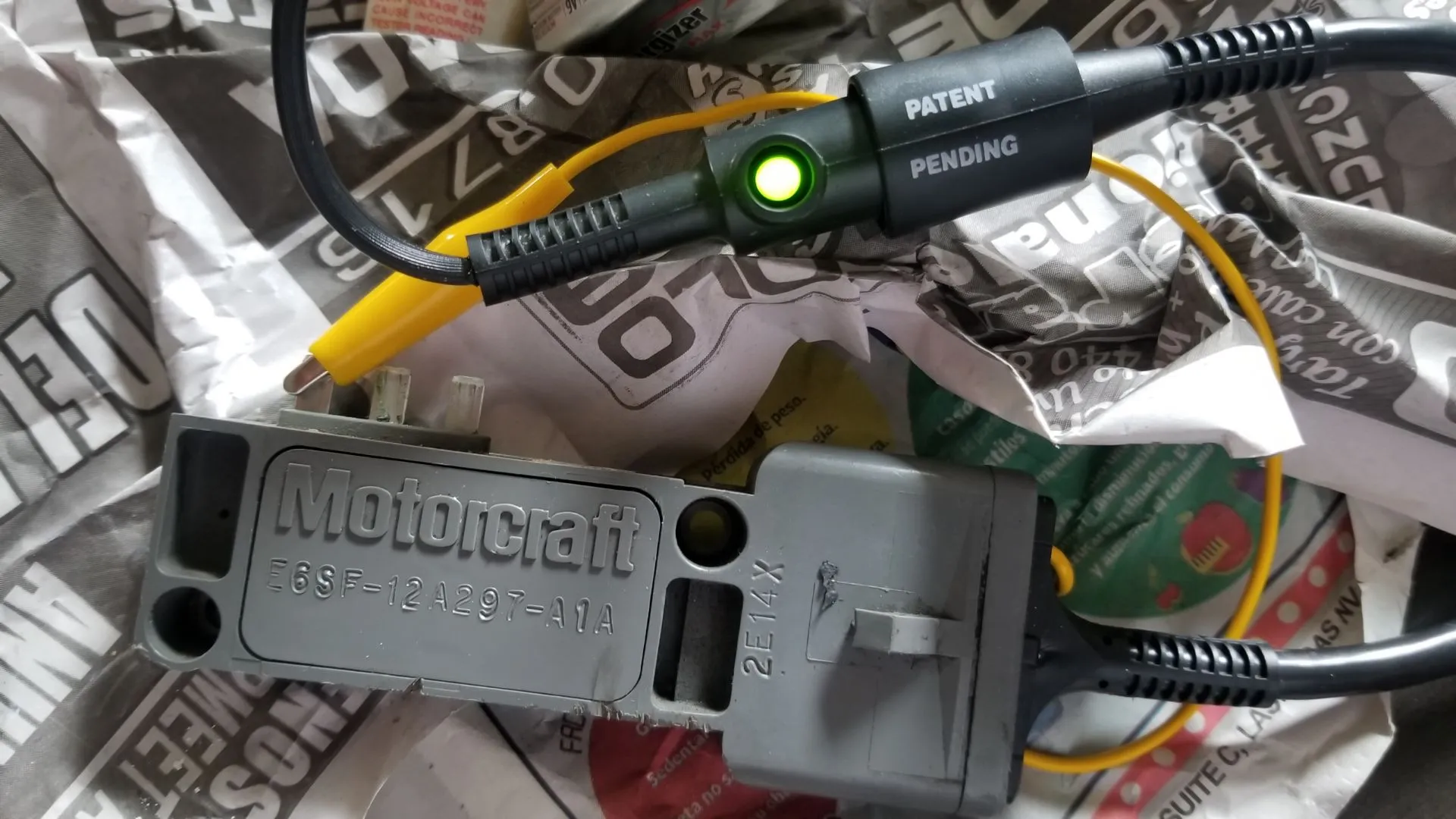

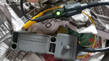

check your TFI Module with this kit its awesome... don't forget you need a 9volt battery to.
