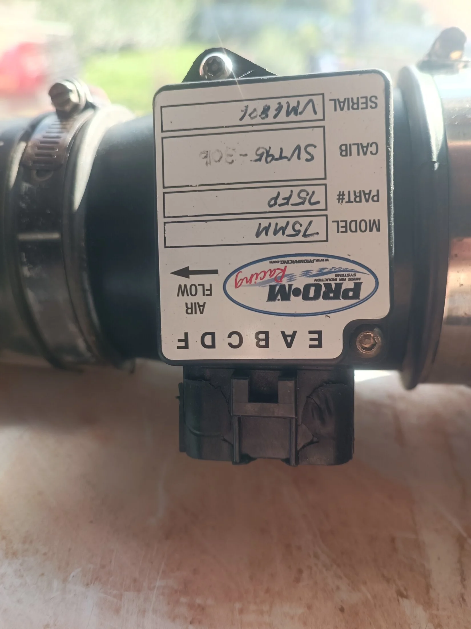

Wel i put 30lbs on with maf from pro-m for 30s for my hci swap but now im putting the originals back on with the original maf

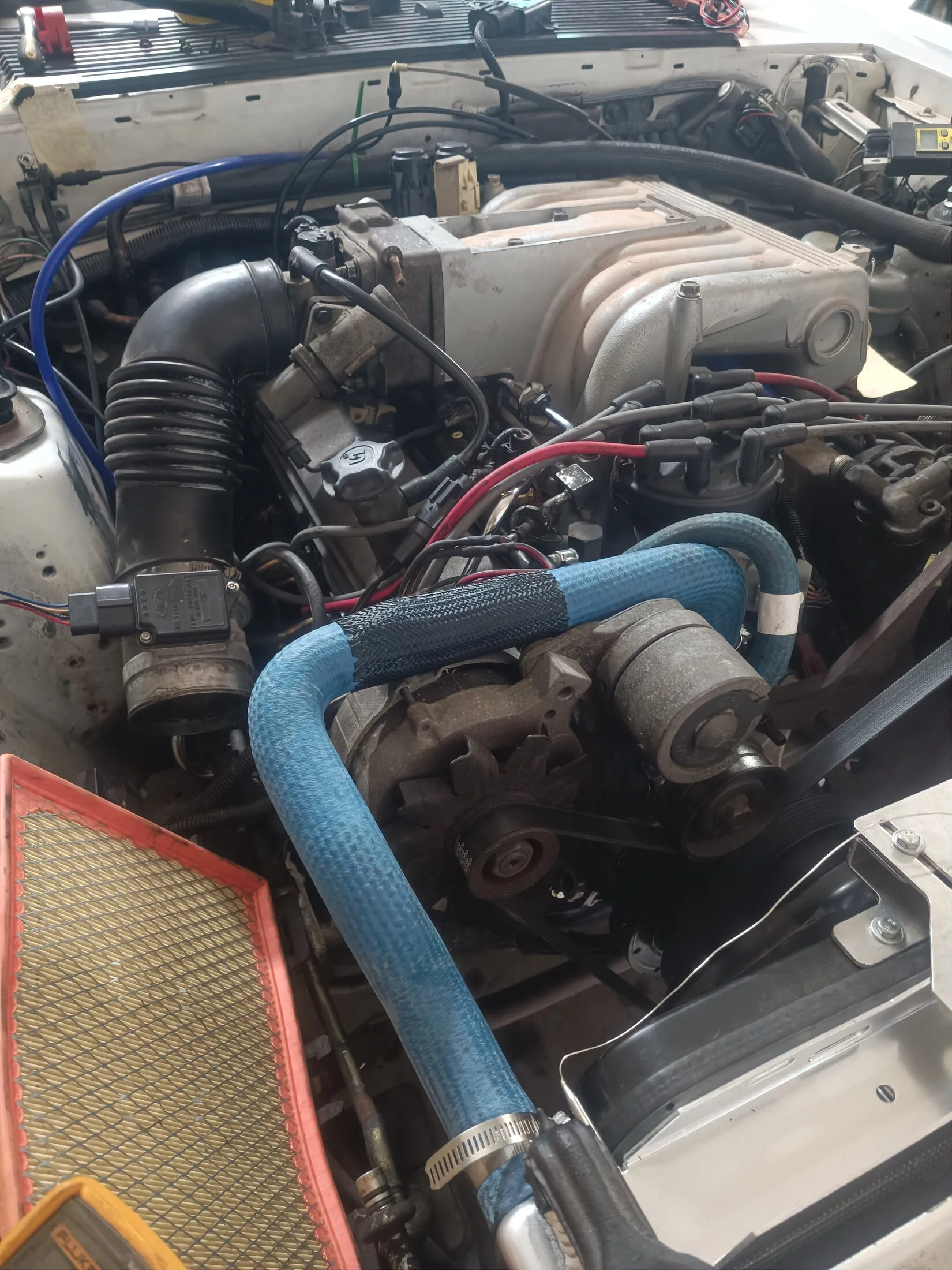

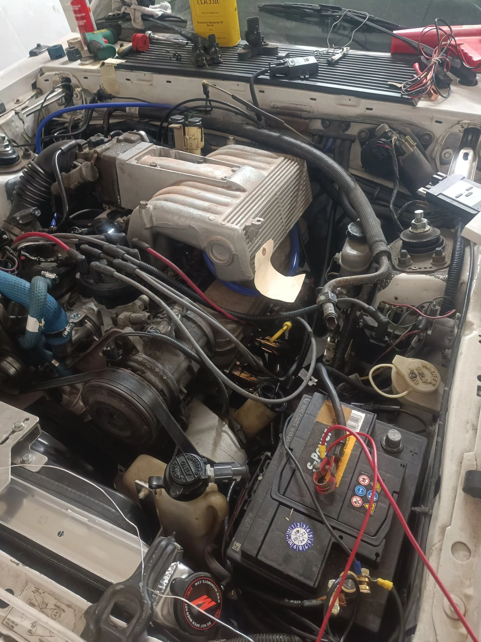

Post some detailed images of your engine bay when you get the chance including some close-ish (not too close) images of your new parts.
I had to go back and re-read your first post now that I understand a little better about what's going on.
30 lb injectors with just a Pro-M is stretching it. I've been down that road and you really should get it tuned. That new MAF will compensate with an approximation of voltages but it cannot compensate for the fuel ramps (The EEC still thinks you have 19 lb injectors, mind you.)
Reactions: Noobz347

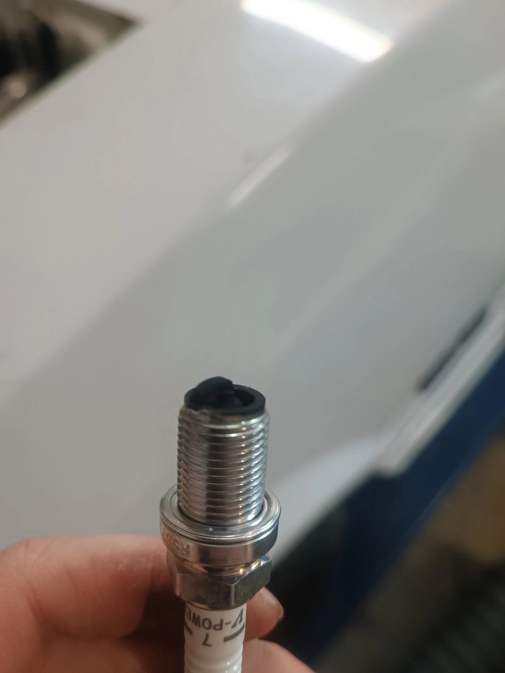

Have you peeked at the plugs since the time it idled?

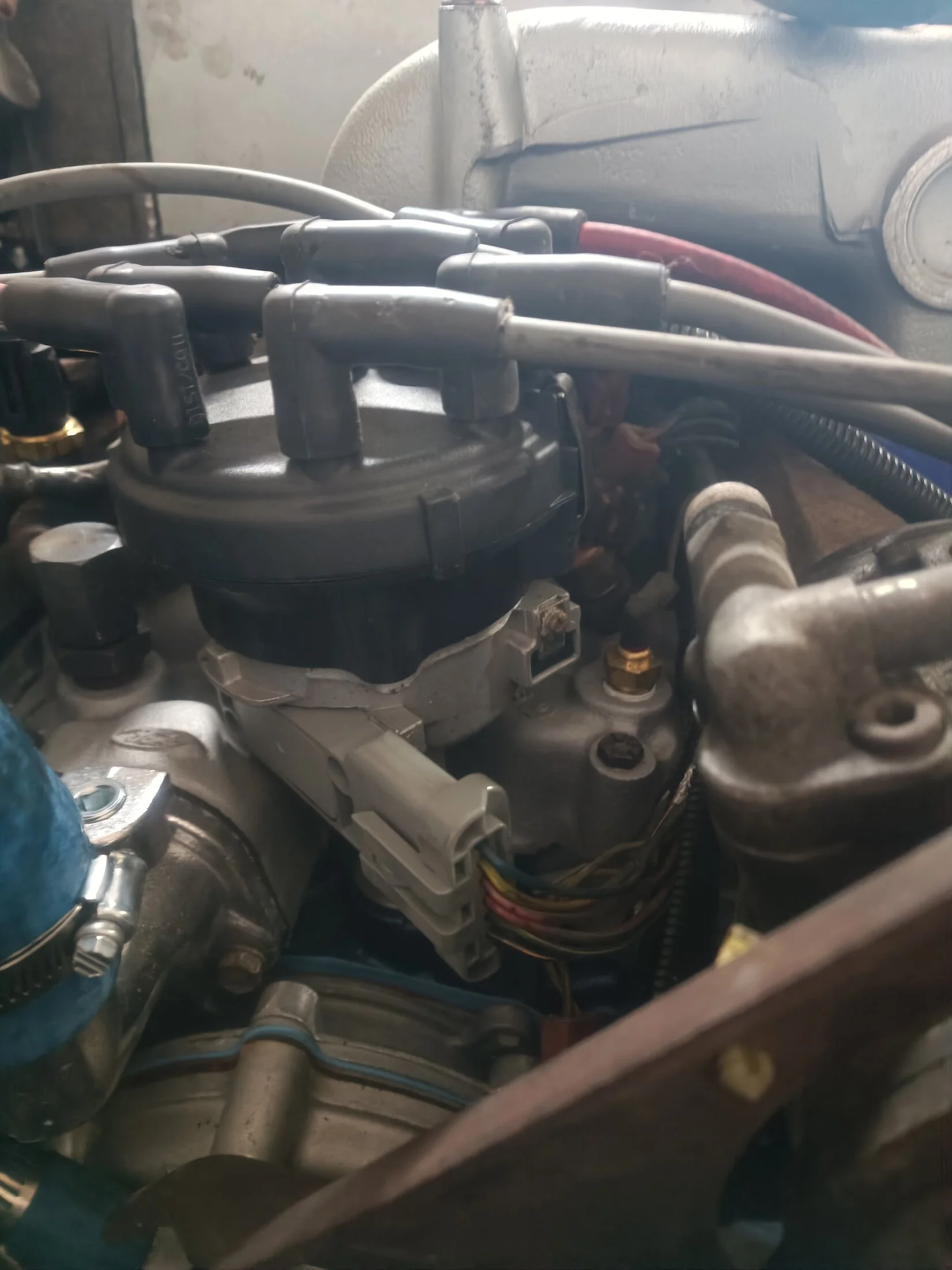

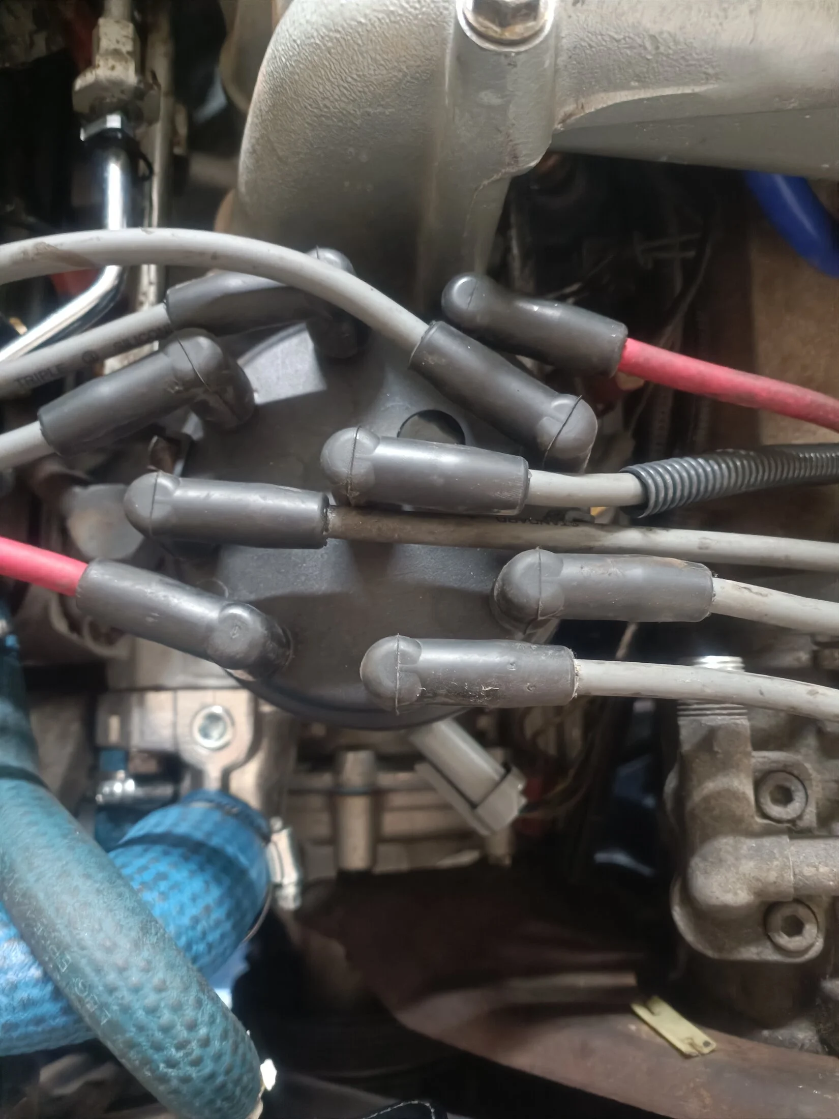

Also double checked the firing order and the distributor looks right and not 180° turned
Let me understand this, the car ran out of gas, would not start, then the engine was rebuilt and updated with what appears to be some great go fast goodies?
Still will not start. It apparently ran for a minute from the looks of those plugs, I bet you change out those plugs, with 19 lbs injectors and a matching maf that thing may just light right off.

Thanks for clearing up the order of events, I think if you swap the plugs it will run.
I think the big azz injectors introduced too much fuel and fouled the plugs,
