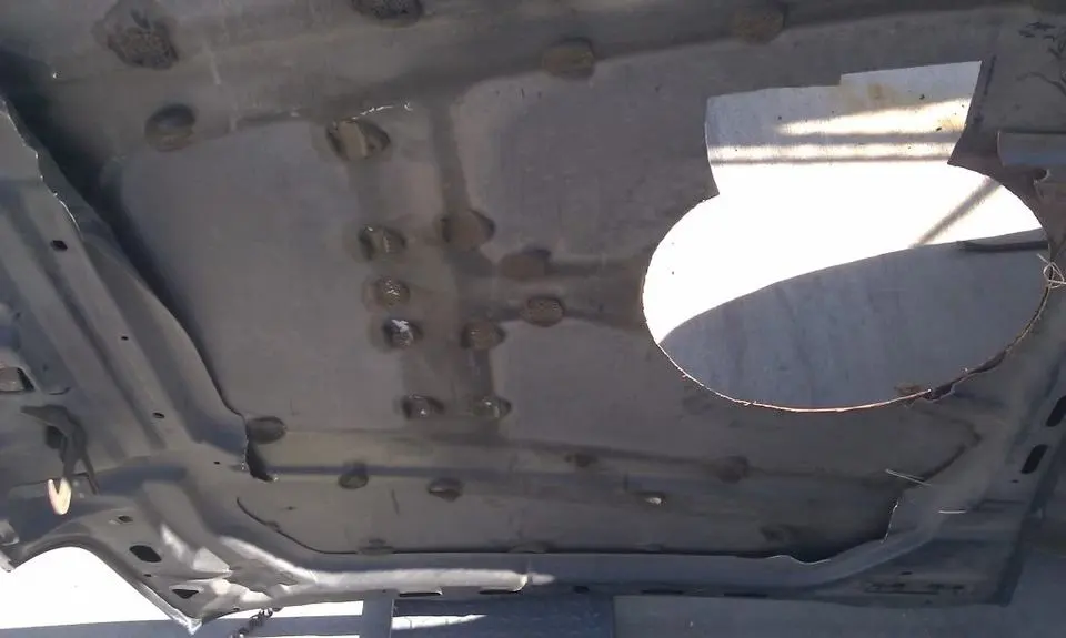

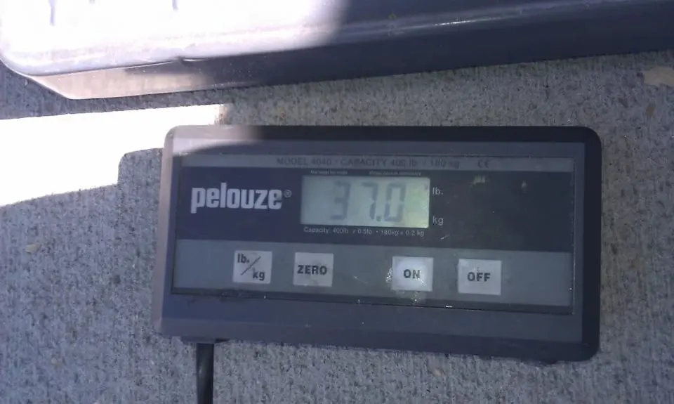

Alright, i weighed the stock hood and have pics
I also weighed a 28" piece of the support,(buyer was so kind to include it in case i wanted the "fix" the stock hood) And it weighed about half a pound. So its possible to remove another 5-8lbs i think, but the hood is FLIMSY, I could hear it oil canning just picking it up to put it on the scale.
Hope that helps, im not sure how far jeff was talking about gutting it, but I would leave at least the front and rear portions.

Shaolin Crane said:
Did you remember all the **** under the fenders? I just realized i forgot to remove that stuff, bracket for the wipers, remove an excess wiring, you could do fiberglass fenders, door skins, hatch, etc. Im suprised your car is so heavy then again the dart and blower arent light additions either. What about a sheet metal rear end? Aluminum drive shaft?
Oh yea wiper junk is gone. I wanna try to stay all steel but the hood for now I think. I thought it was heavy myself then I started adding it up. I have a denny's everything proof driveshaft, its not light but chances are it wont be breaking. The th400 has a easy 50 lbs on a T5 itself. The block is 60 lbs more then a stocker. Blower with intercooler piping bov etc is prob a hefty 80 lbs so just that stuff there is almost 200 lbs and thats going light with everything. Basicly my goal putting the actual weight numbers aside is getting it as light as I can keeping it a street car and not spending crazy money.
Thanks a lot for weighing that hood, I owe you. Probably could get down to around 30 lbs like you said. Cutting out everything besides the skeleton on the way outside. But the flimsy part is what is bothering me the most. If its not a problem I would probably just do that. The roughly 10 lbs more from a aftermarket hood I would get wouldnt be worth the cost to me. There is a local carbon hood on craigslist that Jeff mentioned that I am looking into. If I can get it for reasonable I might pick it up.

It might be possible to get it to 25-30lbs but the hood still has the bracing along the edges and the whole hood is wobbly already. Maybe JB weld some wood bars to it afterwards? Lol
I dunno if i'd want that on a 9sec car. I'd buy a fiber glass hood and cut out the underside lining in the center. Obviously more prone to cracking if someone/thing presses on it but it also wont flap around either. And will be half the weight of a gutted hood.
