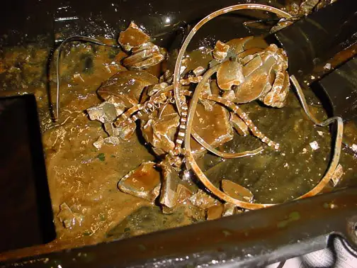

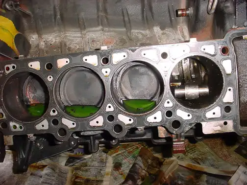

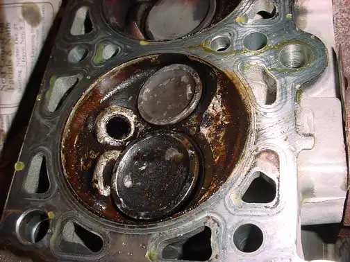

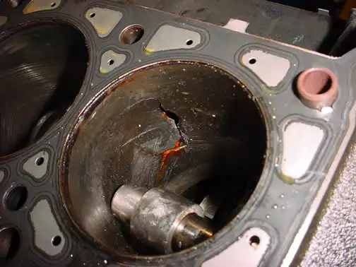

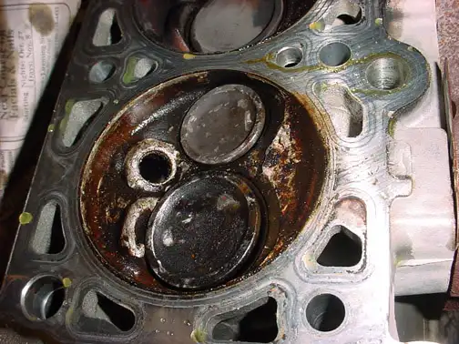

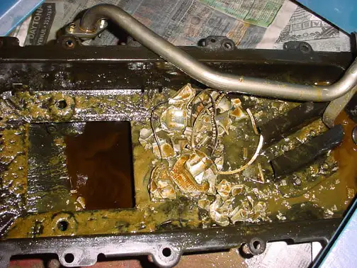

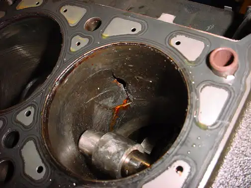

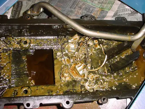

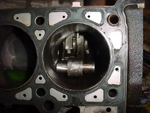

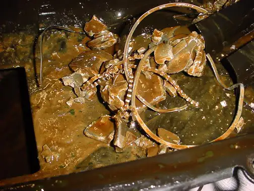

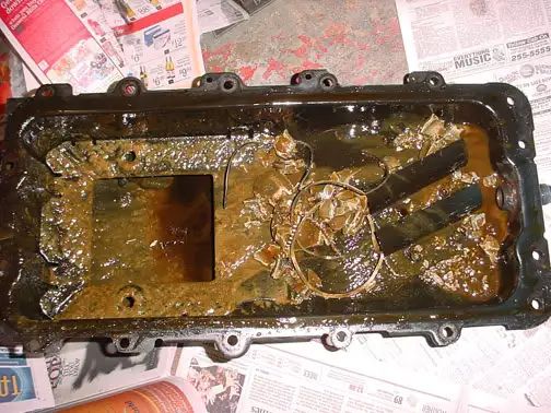

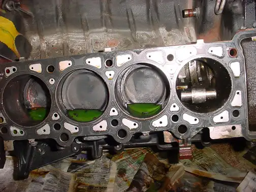

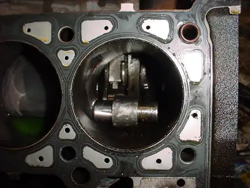

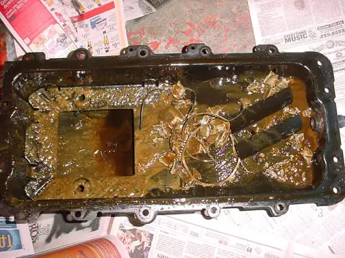

few of you probably remember the thread I had going last week.. Well I finally torn down everything and wasn't too surprised to find what I did.
Have no idea what went wrong, but something definaly did!! no detonation, 10psi or less, 1st gear roll on very easy and I get this!!

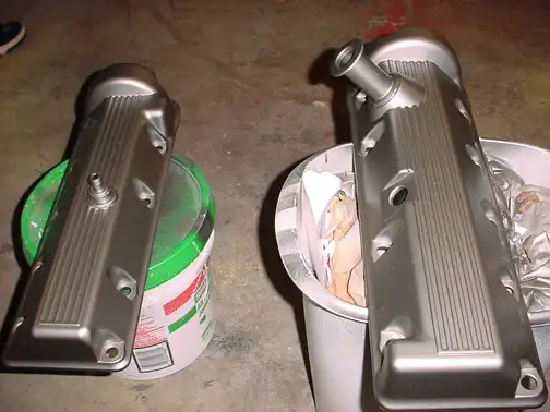

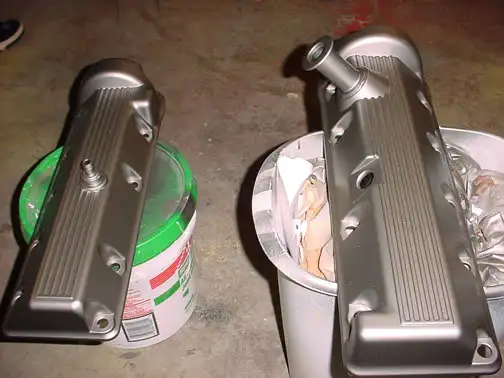

On a good note, as you see I'm already painting and preping everything to go back in.. There will defintaly be a nice surprise in the engine bay in the next couple weeks or less. Candy orange on the intake and center of cam covers, candy orange engine bay ( and exterior next month) and maybe a couple other small accents here and there.

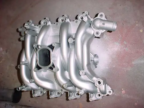

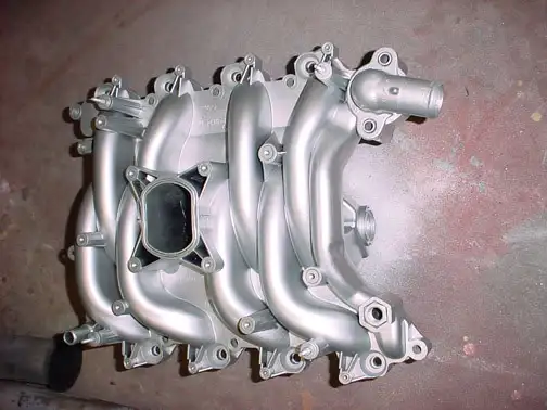

just a stock PI intake.. what you see is the silver base coat, I'm going to lay a candy orange over it. Along with the center section of the cam covers. Then paint the engine bay and car exterior the same color. ( very close color to the Saleen E orange) Think it'll give a unique look as a package.
Well, that SUCKS! Everyone take note...DONT RELY ON A MAIL ORDER TUNE! Its there just to get you to the tuners so in case you get into a little boost by accadent it doesnt let go...not WOT lol.
I learned this while N/A....my mail order "tune" (which I dont consider that tuned) made my car run at an A/F of 14/15-1...LEAN. Probably about where he was.
Well dude, hope everything goes togethor well.
