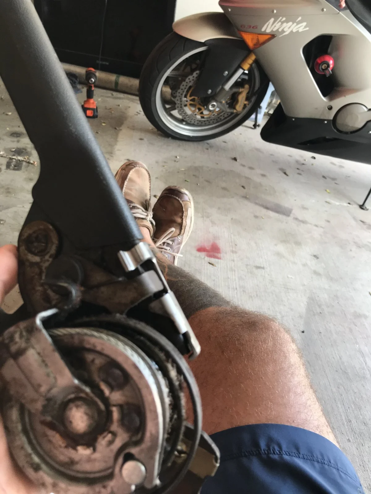

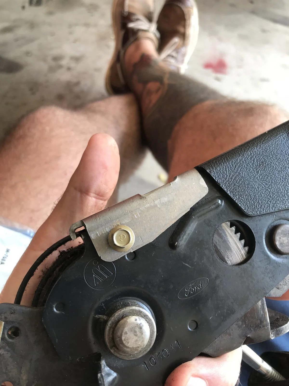

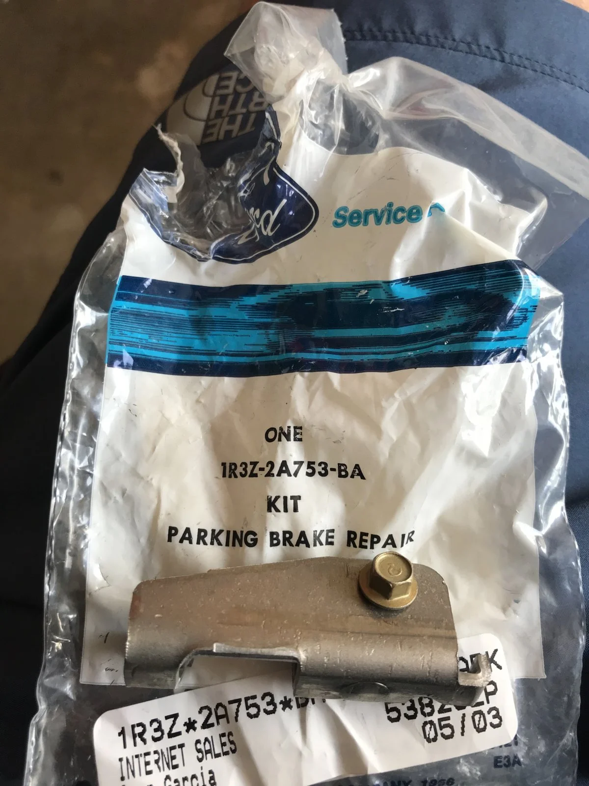

Ok so @Mustang5L5 is this little piece as simple as just placing it one here or is there more I should do? So I tightened the bolt and pulled the e brake so I could stretch the cables. Now I’m just gonna release and then tighten up the slack. How tight should this be?
View: https://youtu.be/3W87LjF_Jmk
That's pretty much all you need to do. It locks the self adjuster so the same as if you welded it.
It might take weeks for the cables to stretch. Basically tighten it up with rear wheels up to the point where the rear wheels don't drag. In a couple months you might notice having to pull the handle higher and that when you'll need to retighten.
You may want to trim off a bit of the threaded rod when you get everything set as the tip tends to bounce off the driveshaft over bumps.

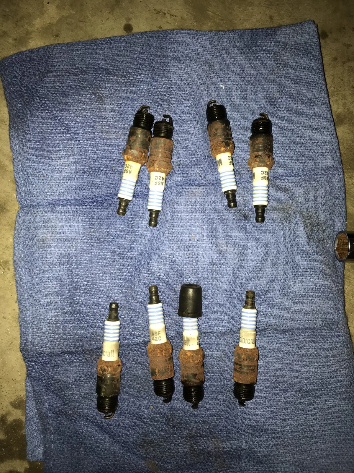

So been slowly getting this brake bleed down, kept having issues with my front driver even after I had slightly tightened up the bolt on the caliper where it was leaking. Finally tightened it up some more last night after trying to bleed it and still getting air. Think I’ve got it all squared away now. Been needing to change out my spark plugs and wires which I want to say they have been on the car since before I garaged it hmm about 15 years ago. Got them pulled out, besides the obvious rust how do I tell if there is any issues are far not burning well, etc or are these just to hard to tell. Wanted to wait till I swapped my heads to put the new plugs, wires, cap and rotor, and coil but I could tell before I started my brake swap the car was running not so great.
Those plugs will be a little harder to read because of the age. I can tell you they aren't burning right. Looks to be oil on them....

Guess they do look oil fouled according to this picture diagram. Are you saying they aren’t burning right bc of this oil on them? What would be causing that oil to be on them?
The oil on them could come from several things. I've even seen bad gas cause spark plugs to look dark and oily. If a car isn't started and driven long enough it can also cause bad readings on the plugs.
Best thing to do is to put new plugs in and drive it a bit. Pull the new plugs and read them again.
Those cylinders will need to get to operating temps and through some load cycles ( driving ) before you can get an accurate reading.
If it wasn't smoking out the tail pipes, i wouldn't worry about what your seeing on those old plugs.

So no smoke but car had been sitting for many years, I’d just crank it up in the garage to turn it over and at one pint I was surprised bc I was sure the gas was a few years old. Car traveled with me from tx, ga, tn, and now back in tx. I took it for a spin before starting this brake swap and no smoke, or any start up issues. Just noticed it kinda of boggy and sluggish with a couple of backfires, but hasn’t had a tune up since I had first garaged it back in 2003. Honestly they smell more of gas then they do oil but idk.

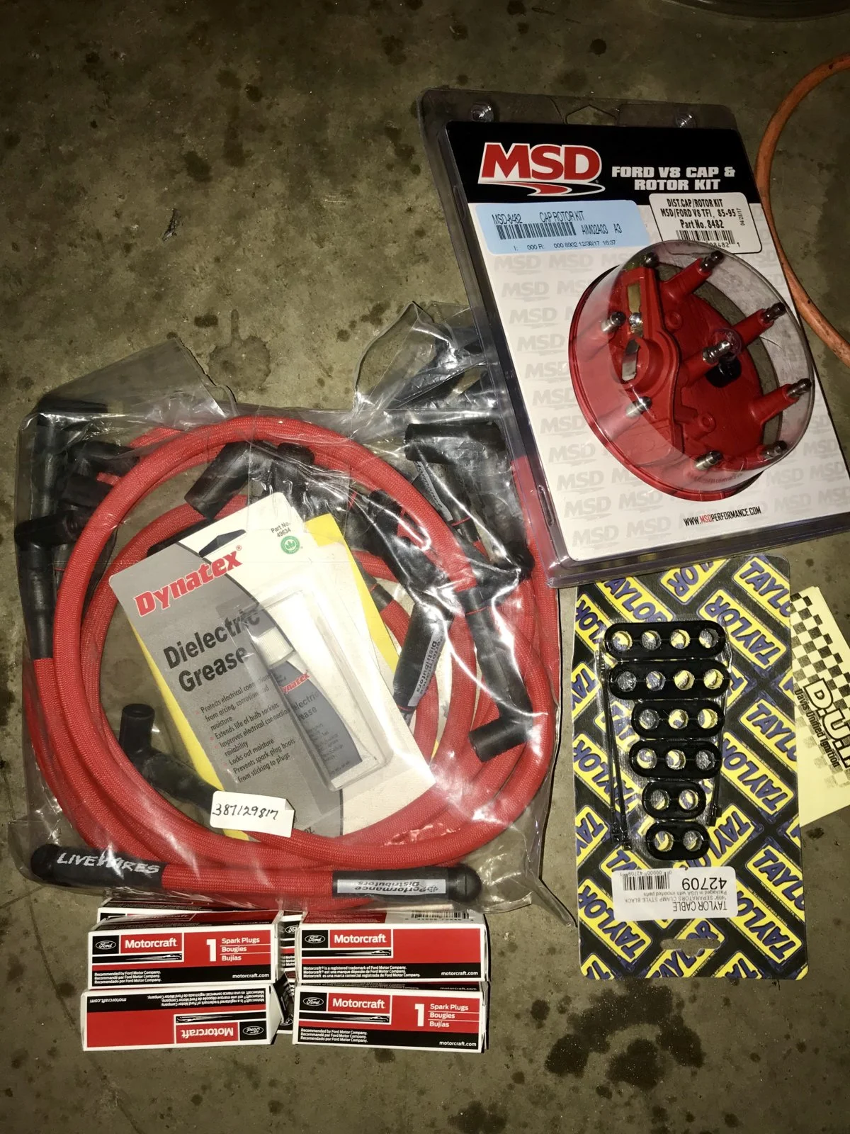

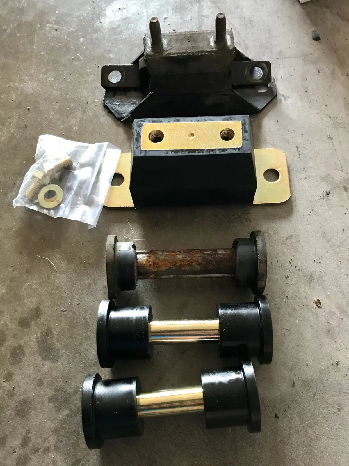

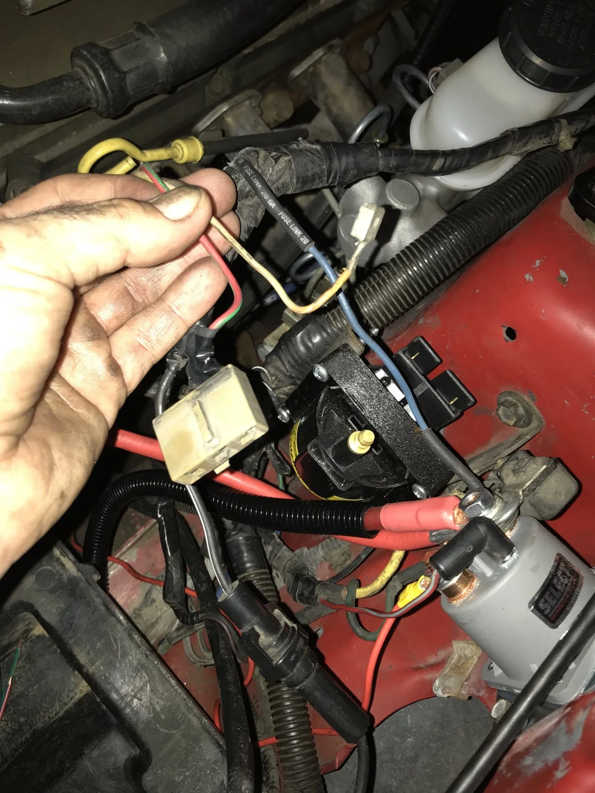

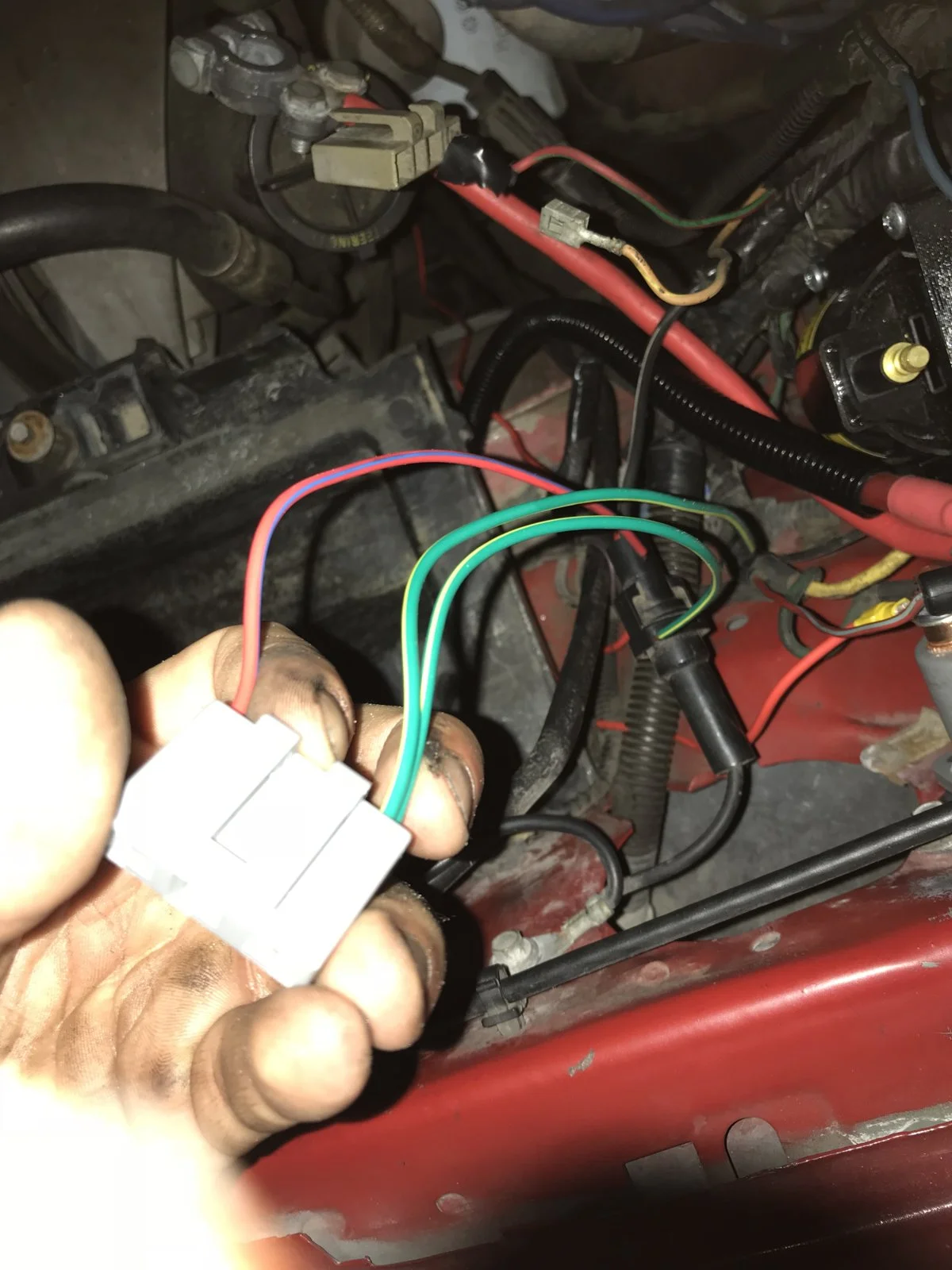

Cool guys thanks, so what I’m doing is new plugs gapped at .65 with the screamin demon coil, live wires, and a new msd cap and rotor. So my coil plug is ragged and I bought a new one from lmr but I don’t know why there is two green wires, can anyone explain that? Other than that just swapped my trans mount and cross member bushings as well while I had the car up still.
