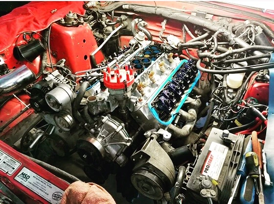

Progress Thread Cars alive again, but would these items move on marketplace?

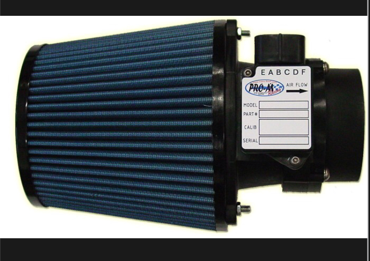

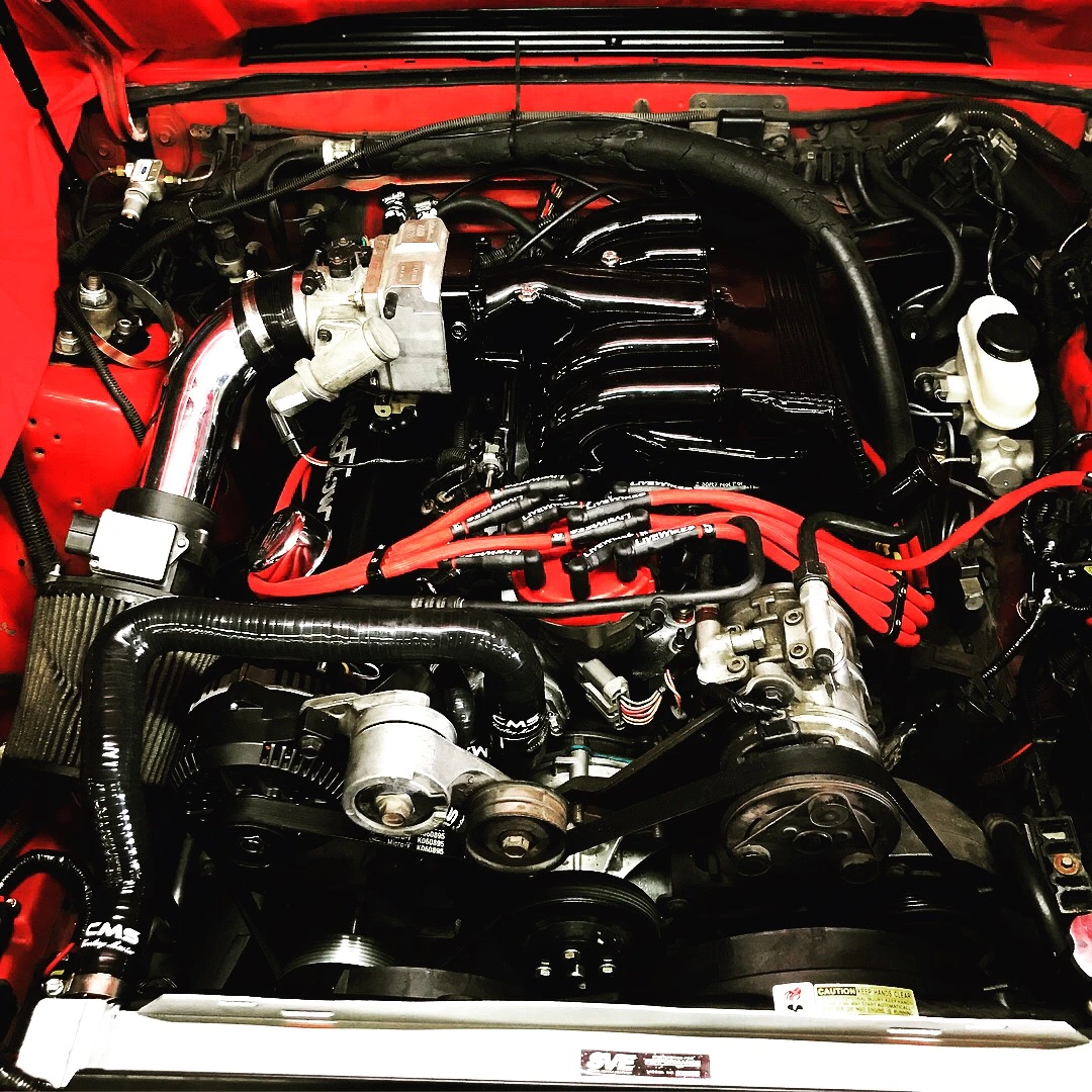

That filter should be moved inside the fender and away from fan wash. Don't know if your pro m is calibrated for in the fender filter location.

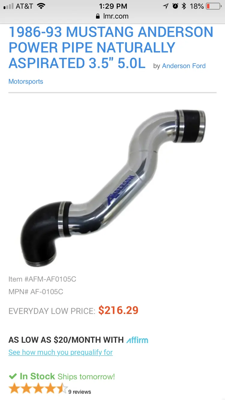

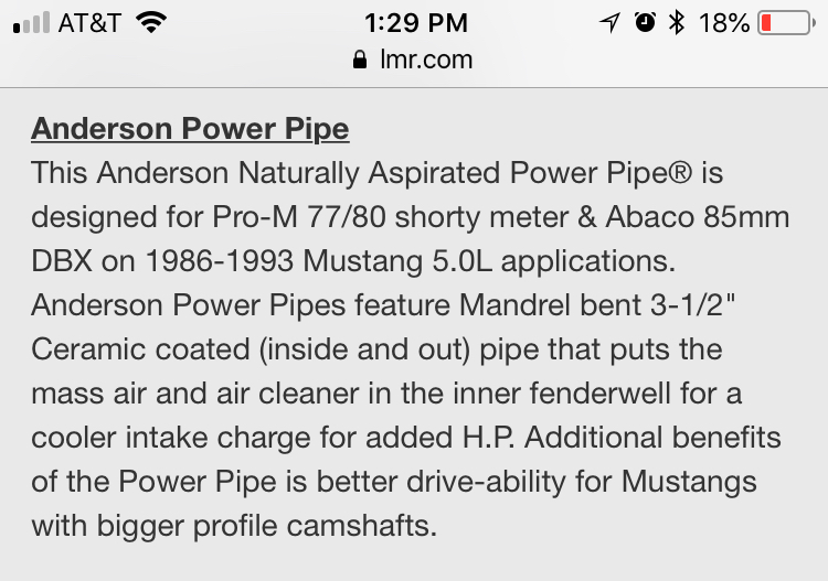

Yeah I wanted to do so but the pro m I have is mounted to the filter so I have to fit it in the fender or drop 216 on the Anderson 3.5 power pipe for NA and it accepts my type of pro m and would place it in the fender well. I just don’t want to drop that since I’m planning on a blower hopefully soon which would then make that pipe a waste for me. A2122243-7BC1-487C-9C76-20DEA9A51796.webp D2E10C3B-2868-48AE-9B5F-00C51D43DB14.webp G E3DC08BF-61DE-46FE-A43D-330AE3646F6C.webp

Wait, you're advising him to move the filter into the fender to avoid fan wash.....what about rain wash from the tire?

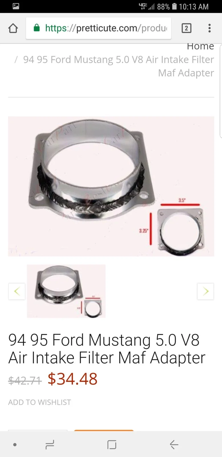

If he has a fender liner he won't have to worry about that. Or....he could build a dam out of sheet metal to keep the fan air off the filter. Testing has proved that it makes a difference. The filter would be at the same level as the factory air box inlet hole ( the big oval one ). Theres also a bolt on adapter available to adapt that pro m to cold air piping on the filter side.
