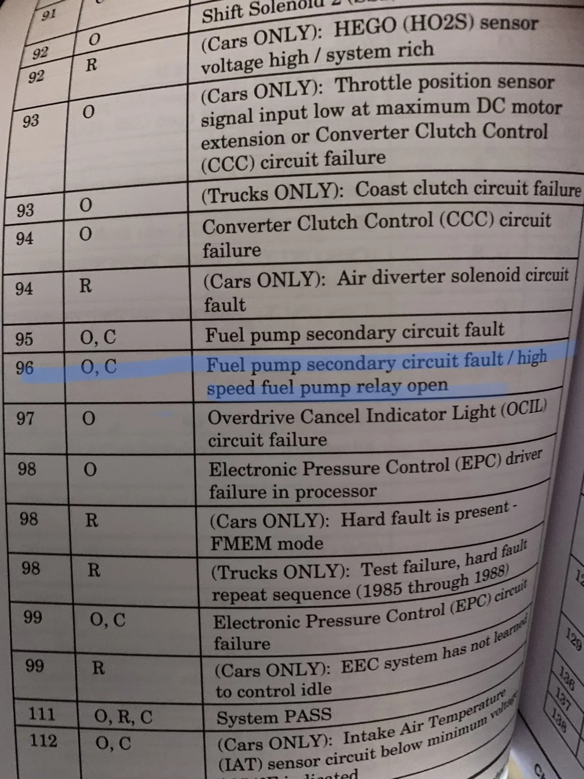

Ha that does suck. So here’s one cranked my car up was gonna head to a car meet up, and then the car just shuts off. Crank it up again and it starts and turns off. I check the the fuel gauge, zero pressure. I had to replace my fuel circuit or pump relay awhile back after checking with my scanner. So I popped the scanner back on got the usuall 15 and 85 since I smog deleted etc. but got 96 which I if I recall is what I got last time believe. So after the scan I cranked it on, starts up strong then I can hear the drop, I watch my fuel pressure gauge which was up to 40 then just dropped out to zero, car shuts off. Is it maybe a bad relay again?
or a pump that has blown the internal pop-off? :shrug:
Try the paper-clip method to run the pump and see if it maintains pressure at the rail.
The other thing that comes to mind is the possibility of a faulty fuel regulator. Pull the vacuum line and see if it smells like gas or worse, leaks gas when you pull it.
Not sure what the paper clip method is but I’m about to YouTube. I’m just tired of this car always letting me down. It’s always something, every time I’m about to head to a meet or show I back out and basically can never get anywhere. I always have that unease of am gonna leave pint A and make it to b-c-d and get back to point A. I just want it to be reliable and after all this motor work, fuel upgrades etc it’s just been a PITA instead of running dependably. I’ll check the pressure reg which is new to and a an adjustable kirban.

It’s a pain man and can really get in your head. So I went and bought another relay, noticed the one I had in seemed to have a lot of play in the housing, wiggled a lot. The new one I picked up didn’t. I also pulled the line off the fuel pressure reg and nothing spilt out etc. so I pulled the old relay out, dumped the codes plugged this new one back in and cranked it up. Letting it run and smooth out then I’ll take it for a spin. Hopefully that was the issue, but now I need to also fix my coolant leaking issue. It never ends!!
Never mind car warmed up, backed it out, let it idle for a bit and it got funky, hoped out looked at my gauge and it slowly lost pressure!!! :dead: That’s me hitting my car!

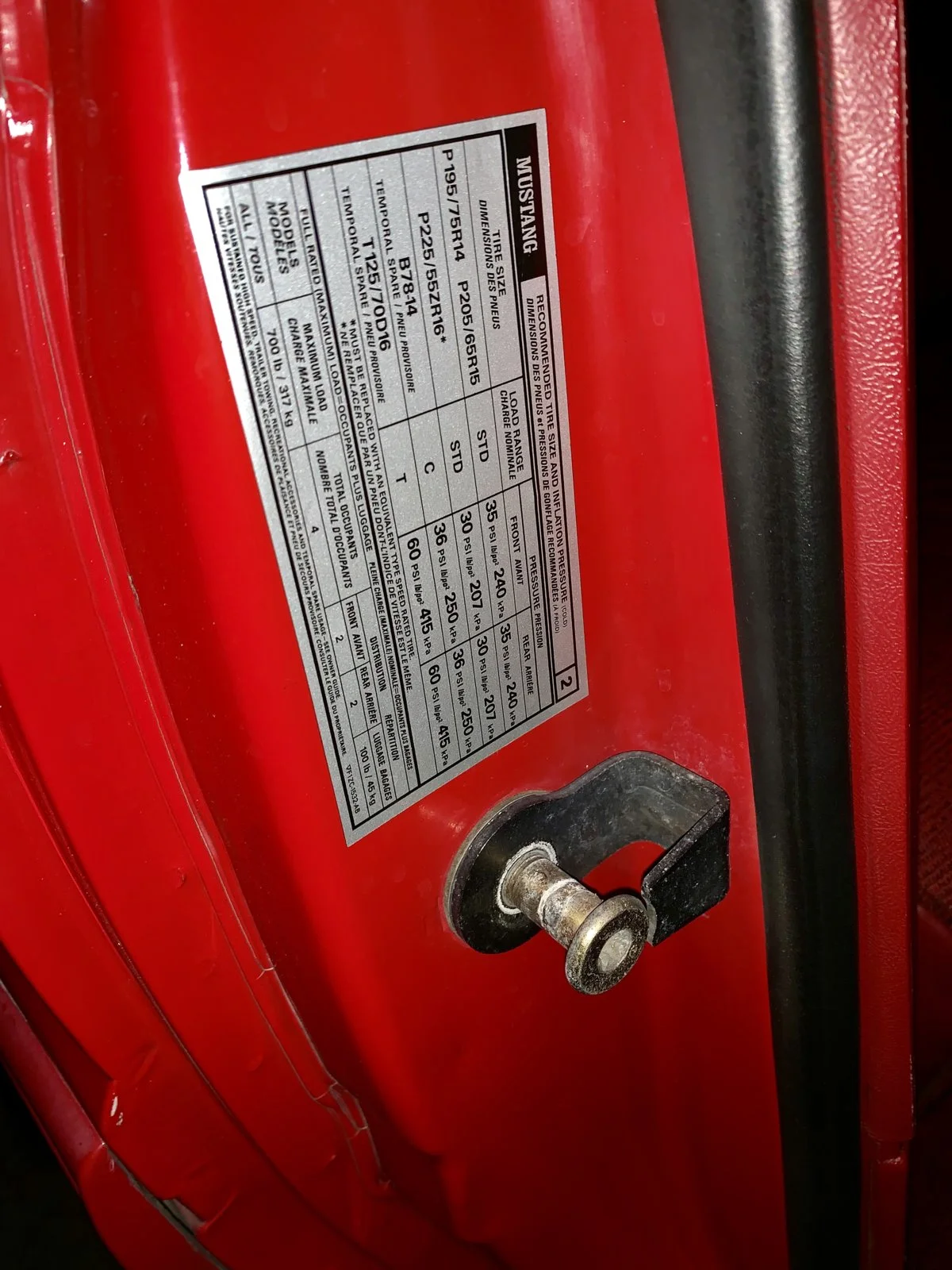

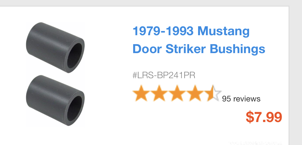

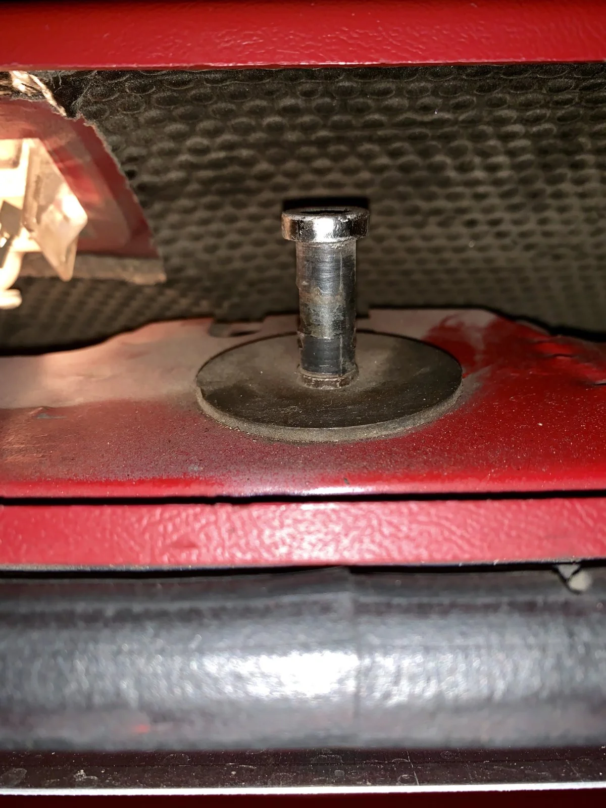

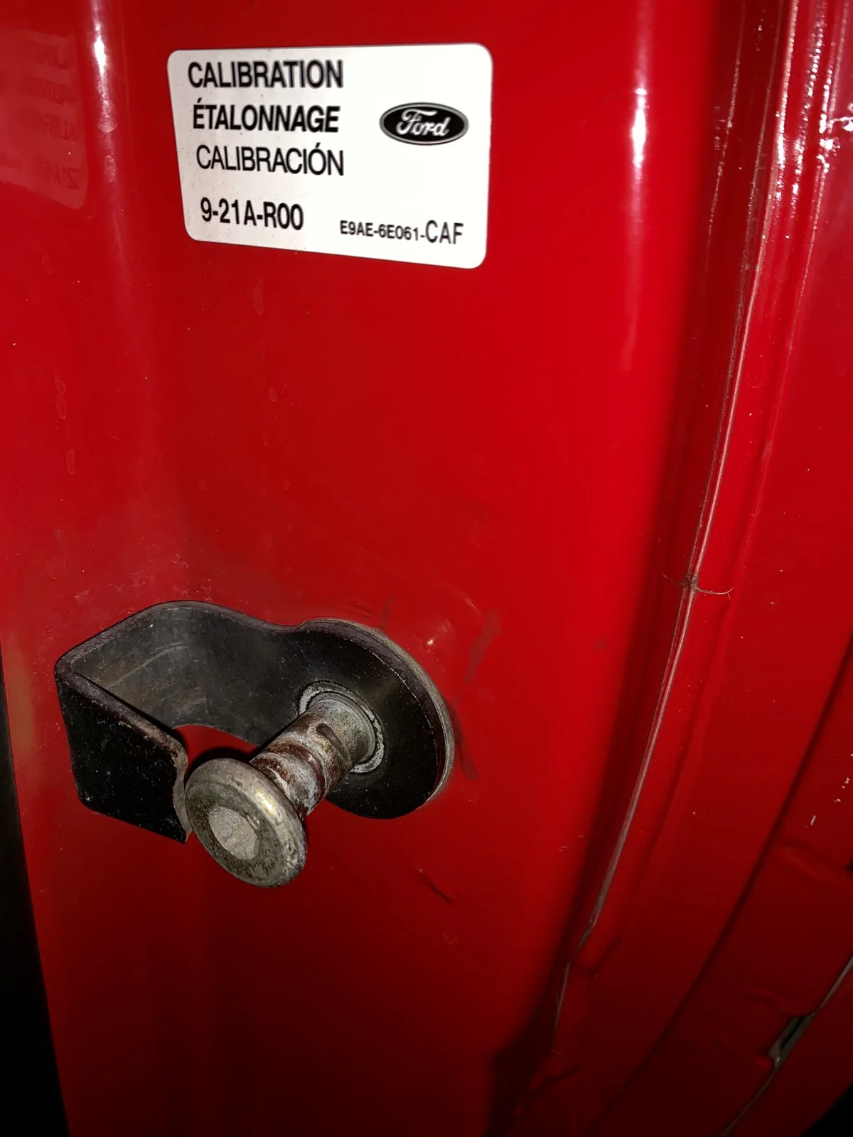

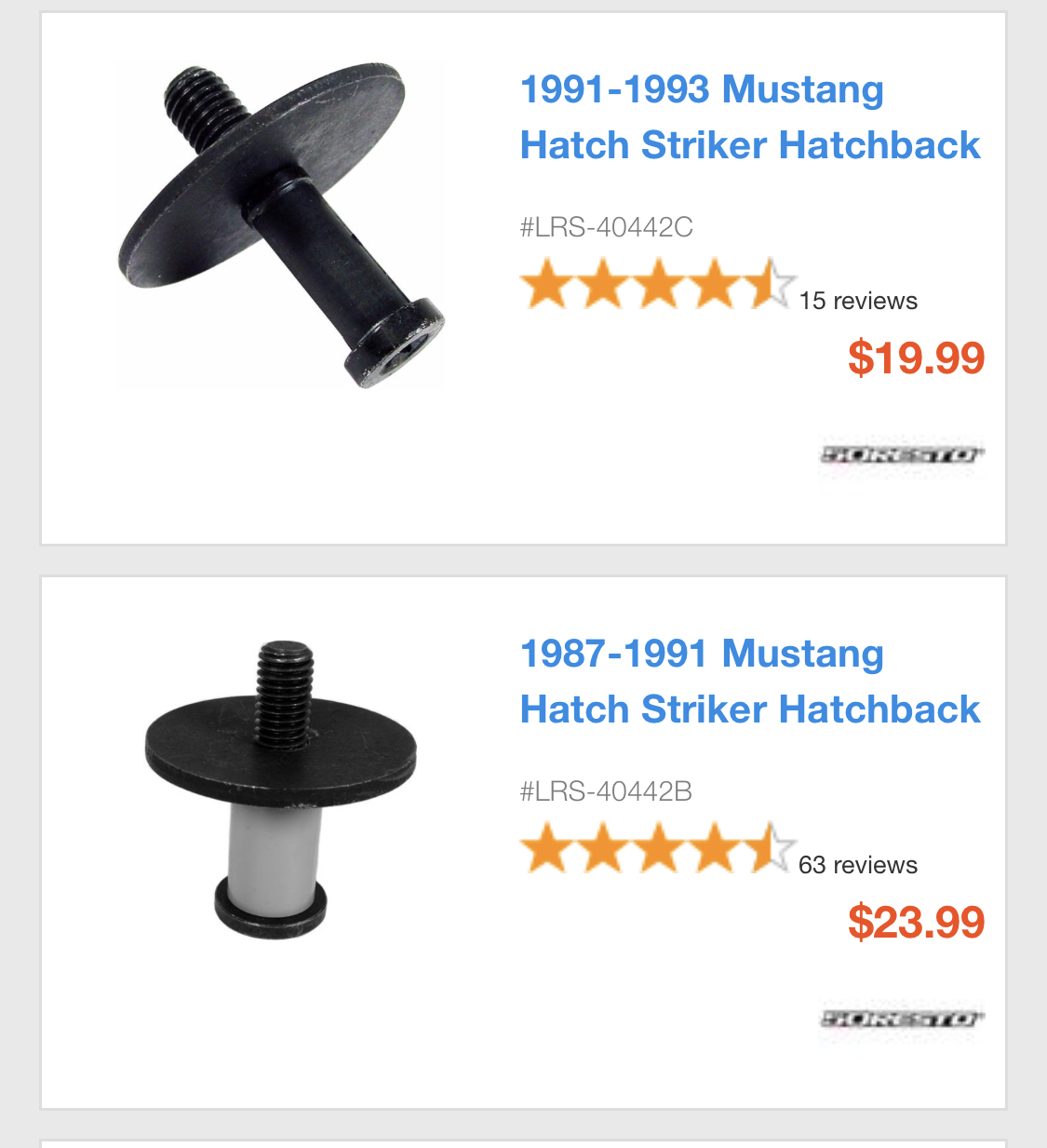

Been looks at my door/ hatch strikers. Feel like mine are missing the bushing. The hatch is actually pretty solid, no rattling but noticed two different ones on lmr, not sure if it’s suppose to have a bushing or not. My driver door if I push on it from out side has some play as does my passenger.
@Mustang5L5 Do I recall different part number latches for with and without striker bushings or is that just a trick of my imagination?
