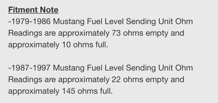

Me thinks the stock sending unit is not compatible with the guage. Does it have a spec range of acceptable ohms?
Looks like the factory senders operate on two difference ranges

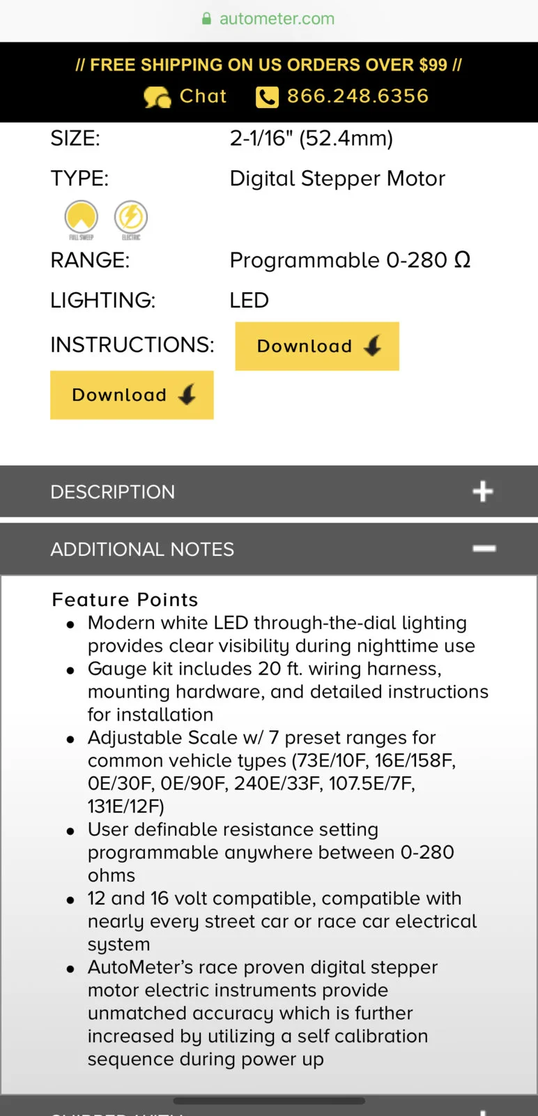

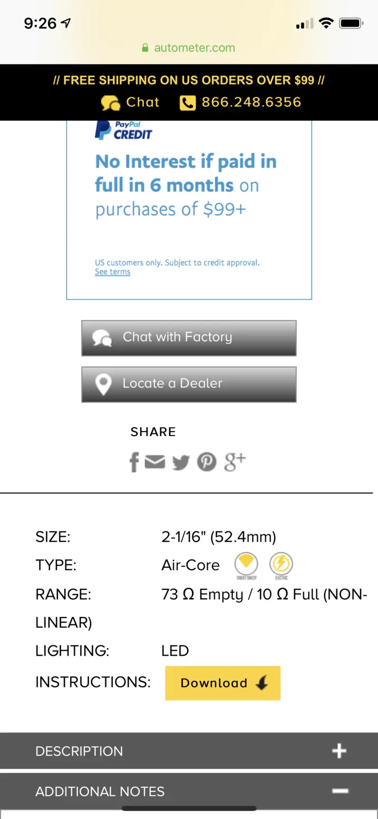

So I guess I would need to maybe swap my fuel gauge from the one I have to the stepper type. Here is the info for mine thanks @Mustang5L5 from what the info says this would work ok for 89s and earlier.

If the sender is reading in the late model range, the gauge you have is probably set to read an early year range ( 73-10).
I just looked back at your gauge pics, sometimes it's stamped somewhere on the ga. One things for sure, there isn't any way to change that gauge to read the current sender that's in the tank, the gauge only reads the impedance it was set to read.

Alright so i called and talked to autometer today, told them my issue they looked up my car year info, let them know the sender is the one the car came with but has an upgraded fuel pump. He said yes the gauge I have 73 empty and 10 full so it’s surely off, but he sent me a form and said I could actually send the gauge in and have them change the range ohm to something closer to what my sender is so they will change it to read 16ohm empty and 158 full which isn’t exactly it but close enough as mine would read 22 empty and 145 full. Figure that’s not bad for a 25 dollar charge. What do you guys think?
