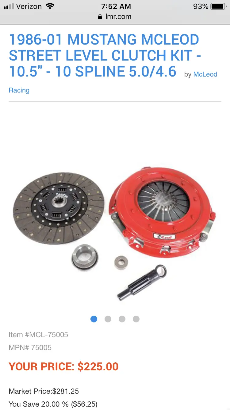

So been chatting with this guy in regards to his KB flowzilla kit which if he gets a fab’d a2a one he will relinquish his to me. Probably won’t happen but he had this clutch and flywheel up for grabs. My old clutch is surely about 15 plus years old, has a new MM clutch cable, etc. never really banged on the gears as it pretty much sat in garages since 2003. He also has a new fly wheel. What do you guys think. Is this a good clutch?![]()
Gotcha that makes senseYah, you have a full HCI car right? You are already at the limit the T5 can handle. Throw in a clutch that grabs and goodnight T5. I would look for something in the "Stage 1" range. Ram HDX or Mcleod Street level. I've been eyeing this one recently,
https://www.americanmuscle.com/mcleod-street-muscle-86mid-01-gt-93-98-cobra.html but literally don't know anyone who runs it or have seen any useful reviews.
If you are going to add the PD blower or bigger block soon then I would think about a new trans entirely and then, yah sure, throw that clutch at it.
I do have h/c/i yes and your probably right think my trans is only rated at 350 which I’m pushing 328hp 358tq so I know I’m there but I don’t drive aggressive. I do want a blower bc the itch is real strong right now and just want to push this stock block fornwhat it’s worth. I’ve contemplated some new transmissions bc I’ve seen some 3550s and tko500s for good deals but not sure if it’s worth it to invest into older transmissions and fix them up vs buying a new tko600. I’m also considering this dart block I’ve found from a guy not to far from me since I’ve wanted to do a stroker motor. I don’t think anything is really wrong with my clutch besides it’s just really old. Idk what it is either to be honest I want to say it’s an old center force.Yah, you have a full HCI car right? You are already at the limit the T5 can handle. Throw in a clutch that grabs and goodnight T5. I would look for something in the "Stage 1" range. Ram HDX or Mcleod Street level. I've been eyeing this one recently,
Yeah this one is pretty aggressive plus the balancer was a 28oz. This guy was someone who had another KB blowzilla I was looking previously and sold it and I contacted him to see what he sold to this guy who also had the flowzilla inlet. Anyways he has a 331 and a sick flowzilla kit on it and just contacted me about wanted to possibly unload the flowzilla to me if he bought the other a2a kB setup. So he obviously had a little better set up than I did. Oh well I’ll just wait thenYeah it say that thing supports up to 650 horsepower. Made for track use. The street level clutch I have from Mcleod is an entry level, more OEM/factory type clutch. The guy I bought my car from had a Spec stage three clutch installed in my car and that's the first thing I ripped out of it. It looks like that clutch you posted is a stage three type clutch. You'll hate it!! I thought that's the one I had, but I went back to my previous orders through LMR and I went with the Mcleod street level clutch kit posted above. I like it, just stiff enough.![]()

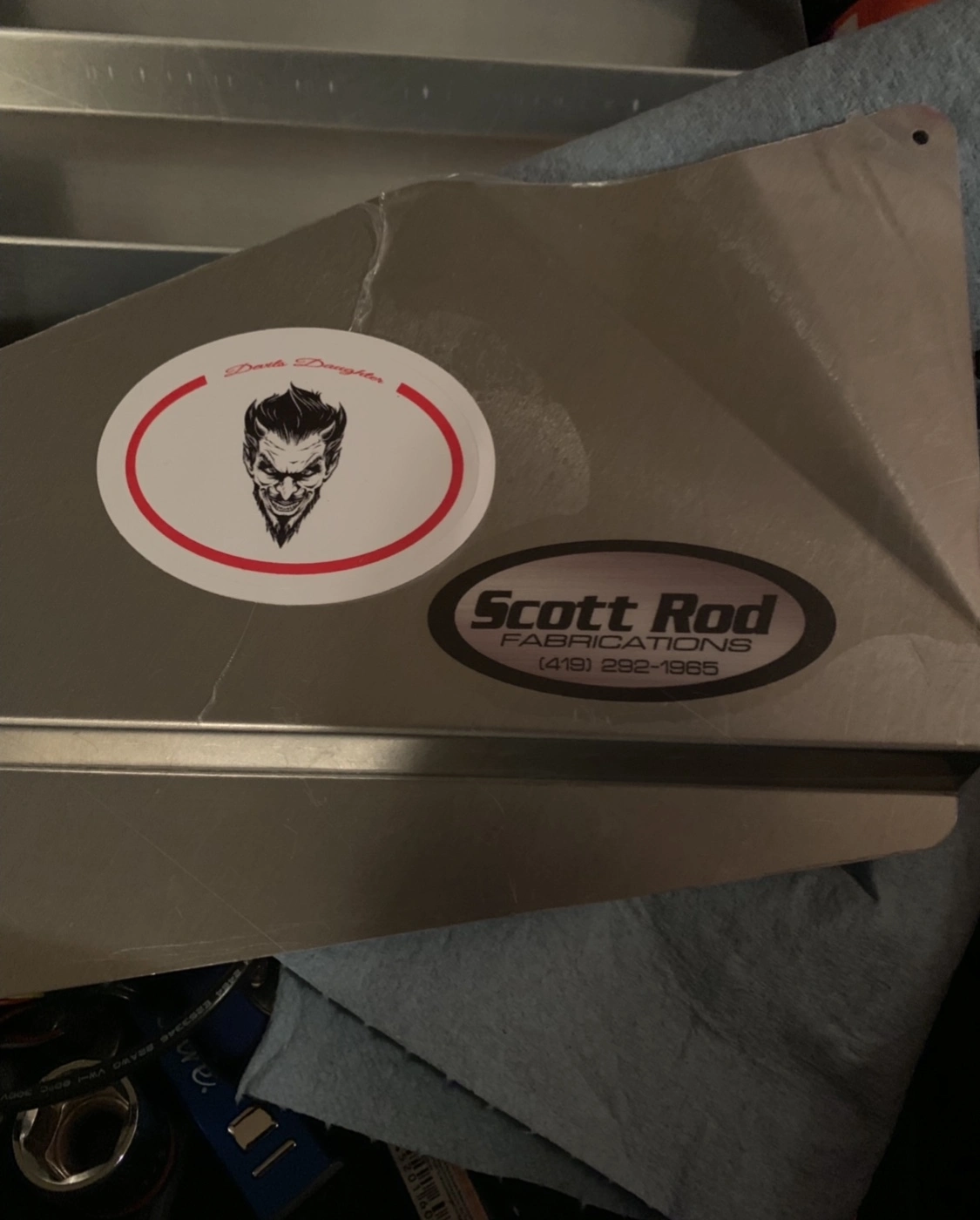

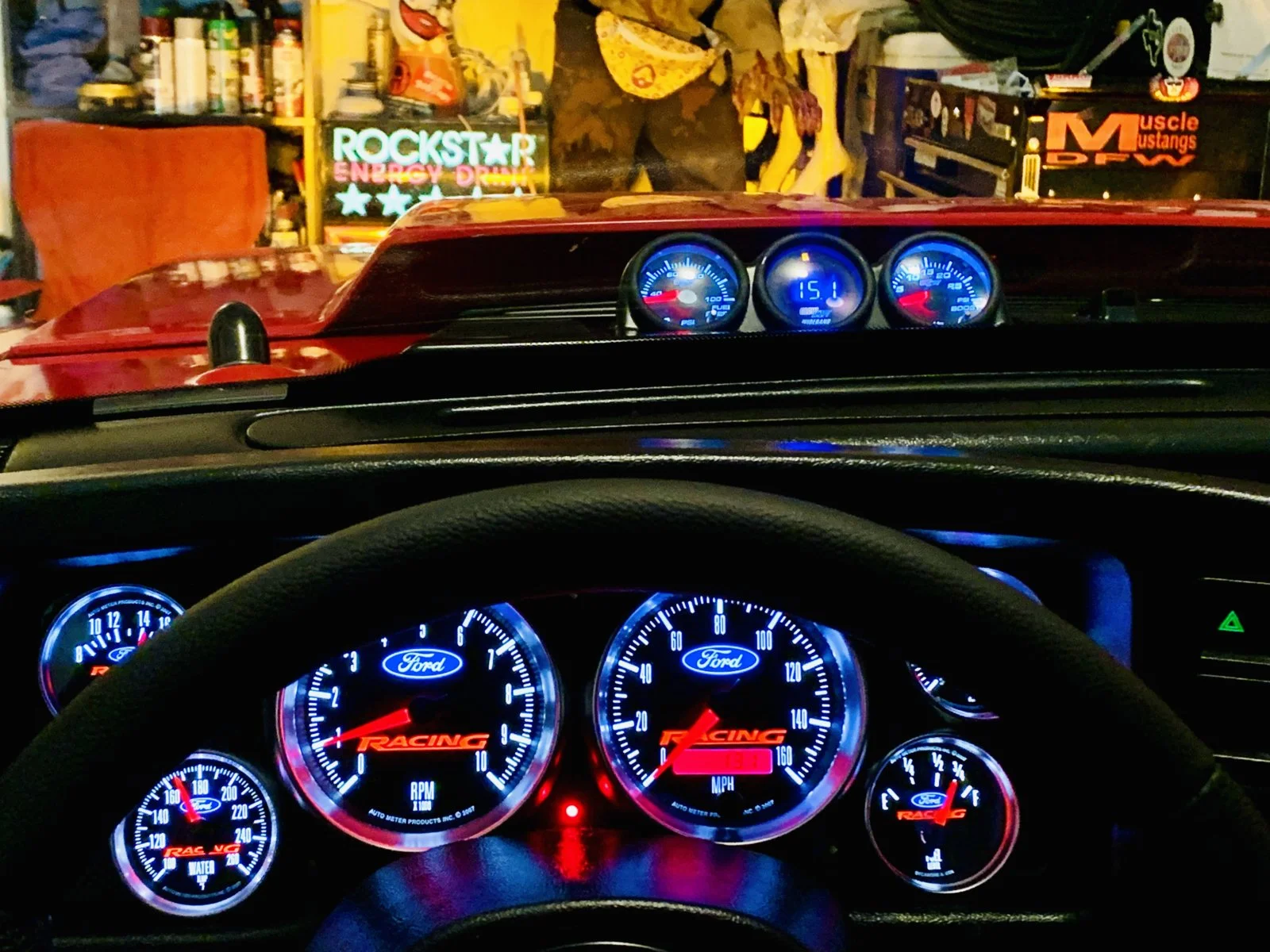

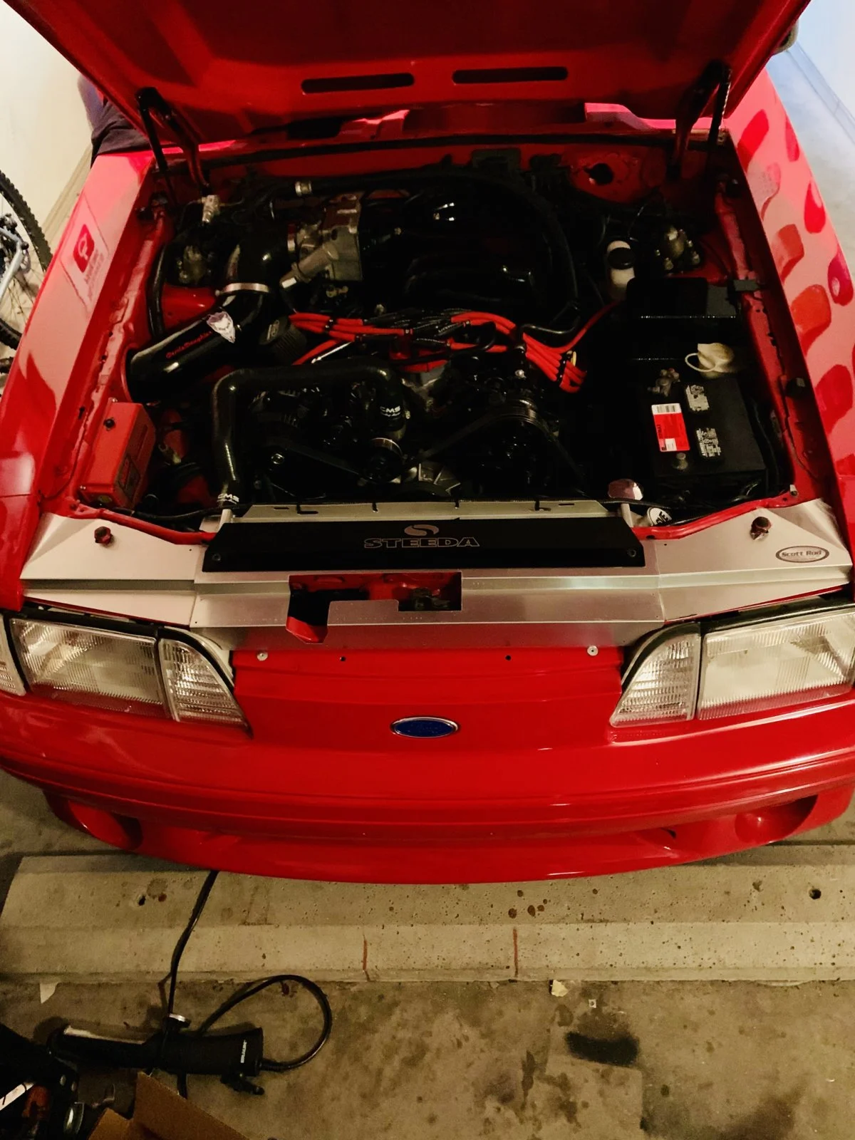

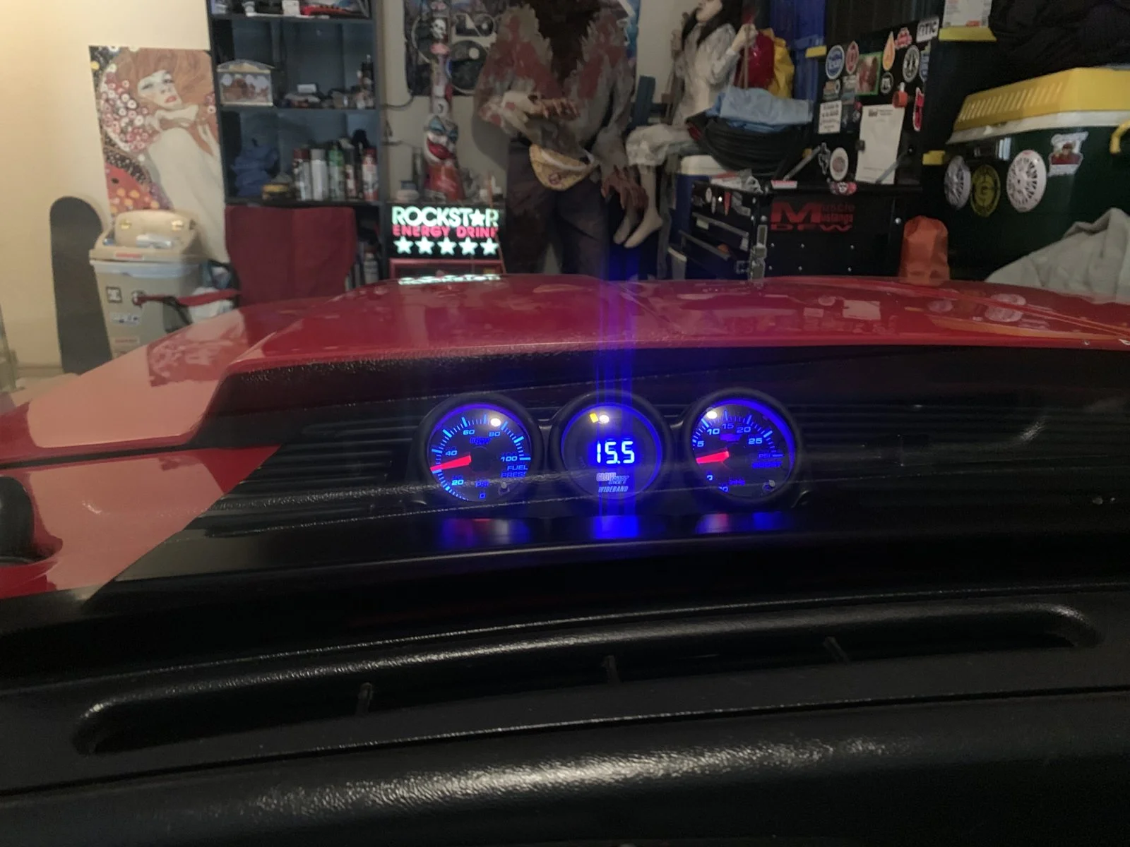

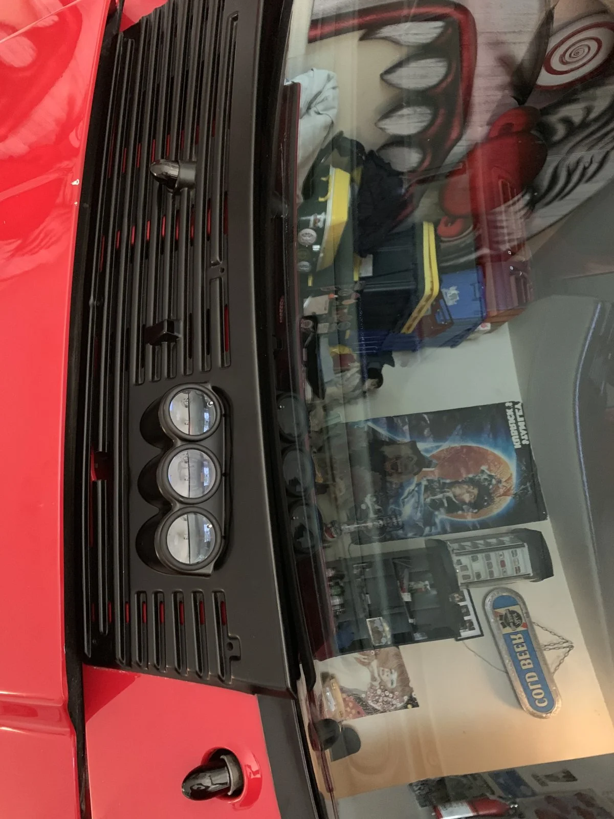

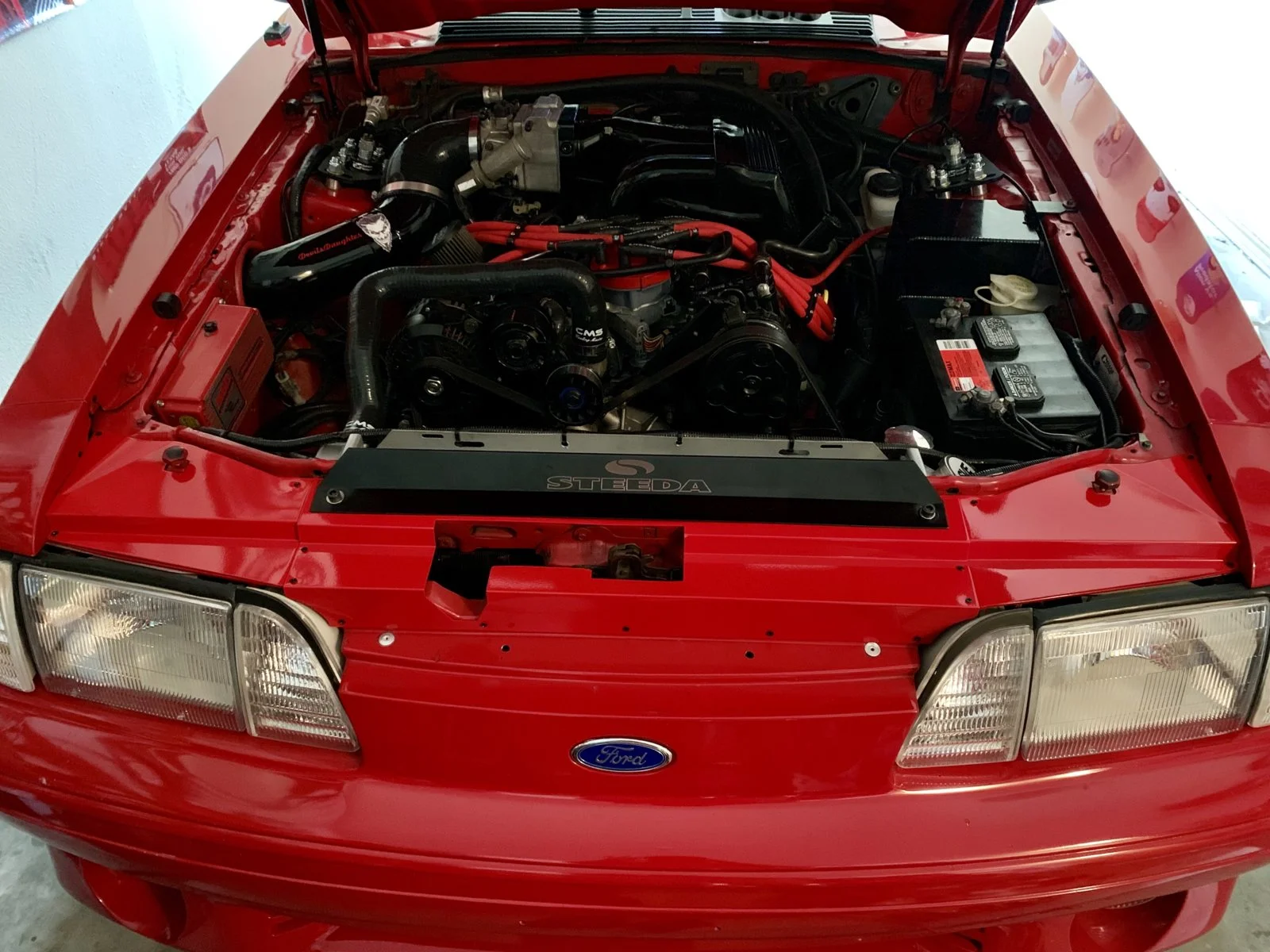

So I was bored the other night and got to work. I ordered this Scott rod panel after I even said nah I don’t like it. My buddy put a black one his red cobra clone and it just looked miss placed but I kinda liked it. So I went for one, was worried about my cervinis hood and Scott rod stating they made another option for such style of hoods. It is tight and I have to slam it down a little but it closes just fine. I ended up doing it how I thought in my mind it would look good and had it powder coated to match so it blends. I also decided to de-badge. Not sure if I’ll leave it, gonwith new s550 black 5.0, or possibly put on black cobras. I know I’m not a cobra but I just love those little snakes! Also debating on the cobra insert vs the cervinis stalker front bumper and cobra side skirts. Also popped these gauges in which yes I was worried about wiring myself but found the constant power, switched, and head lamp. I know I know wow easy 4 wire hook up but it was a task I was worried about lol but pulled out the test light and got it done. Pressure gauge/ afr/ boost!! Wait I don’t got no boost but hopefully soon. I actually think they don’t look bad once I set them to white, from the cockpit they look pretty good all together. I’m in the works of getting new custom wheel caps, ford ovals, and a replacement sticker for the Scott rod sticker.![]()
