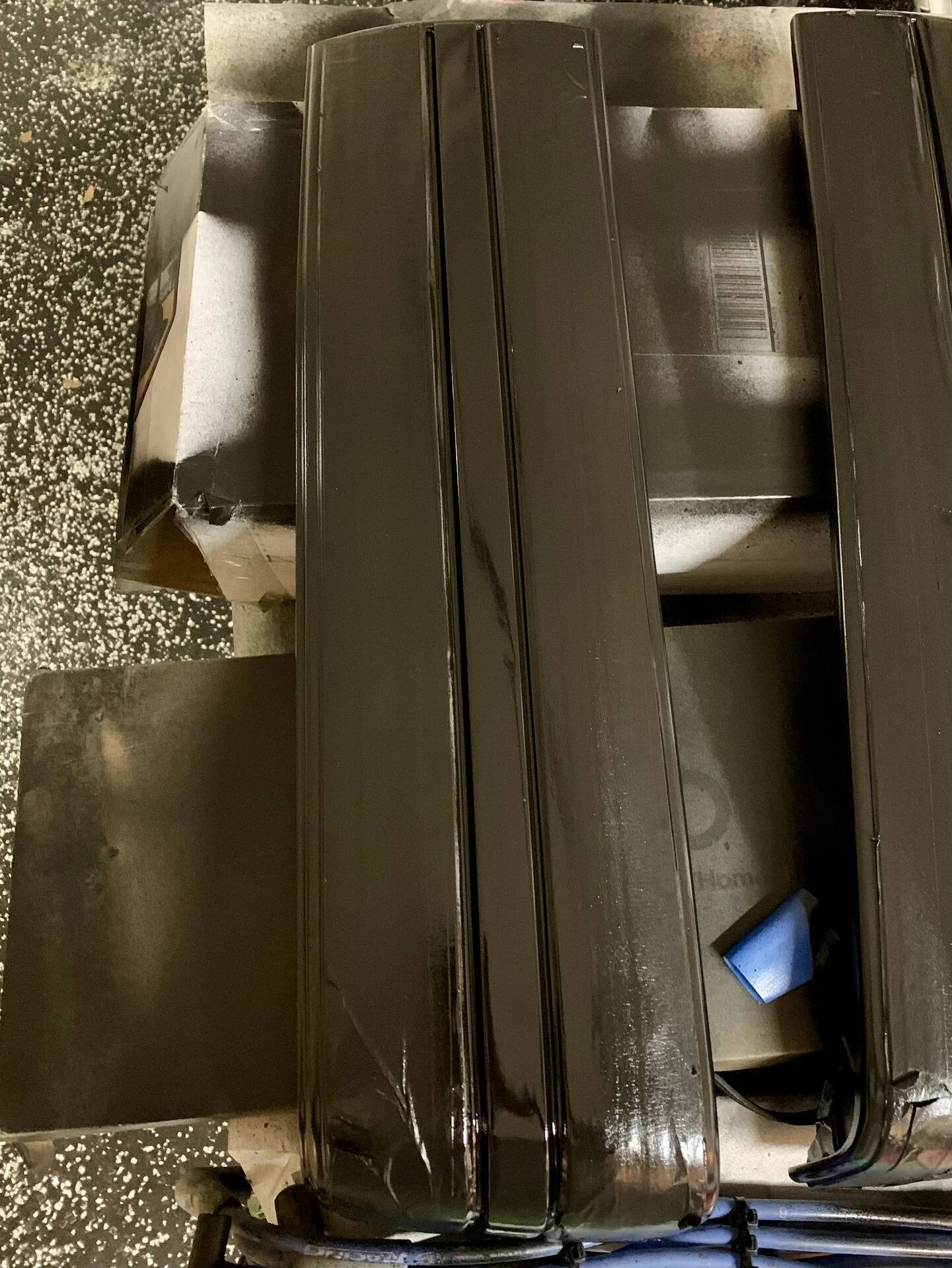

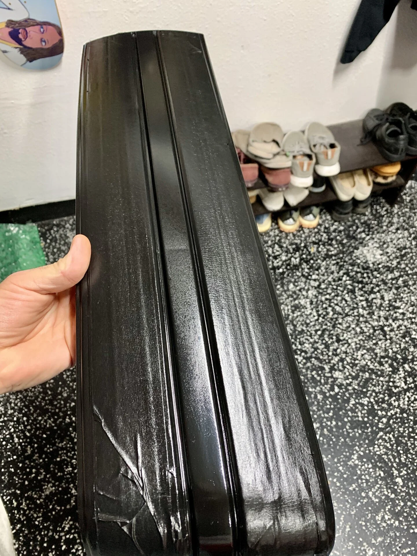

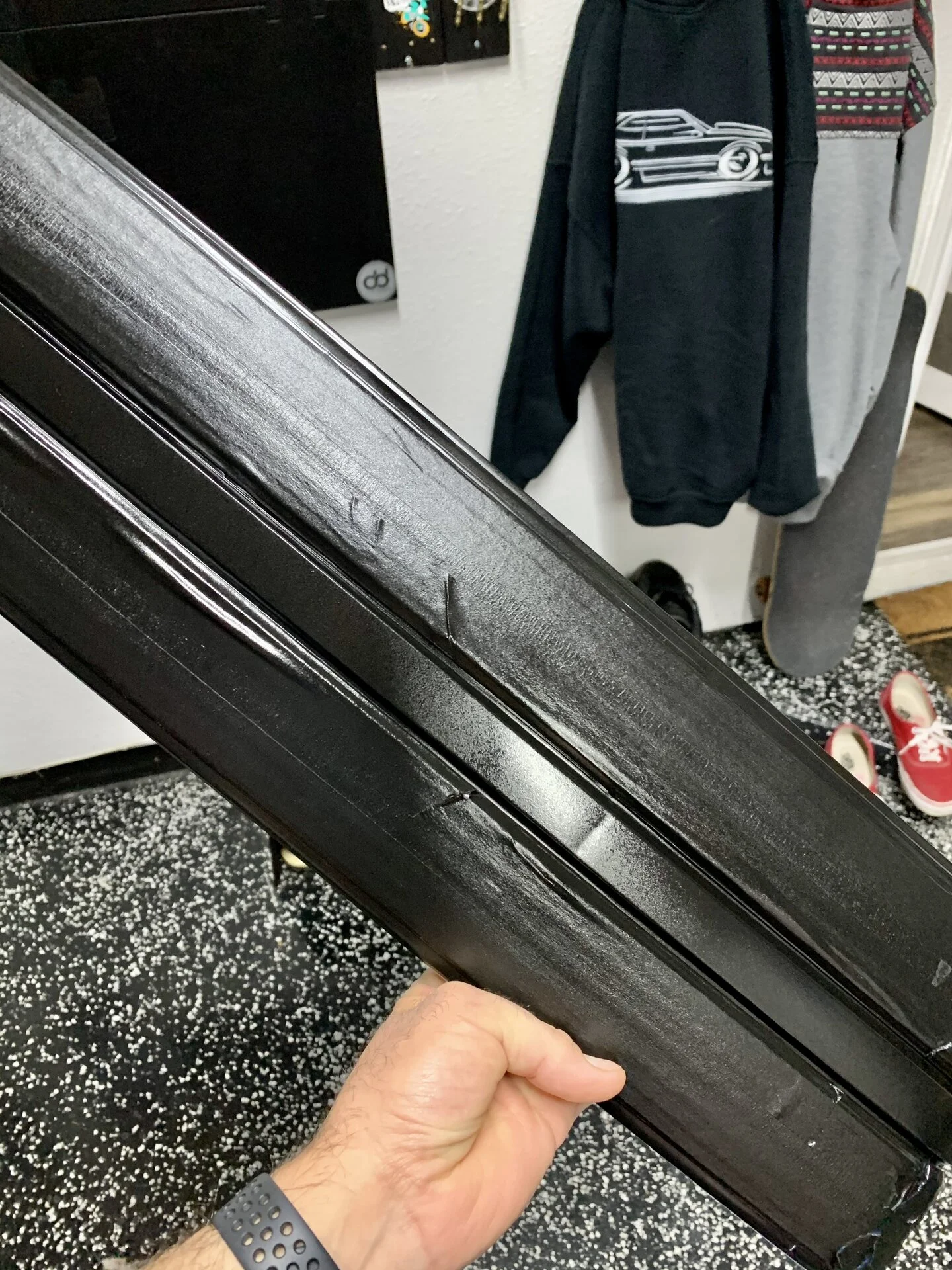

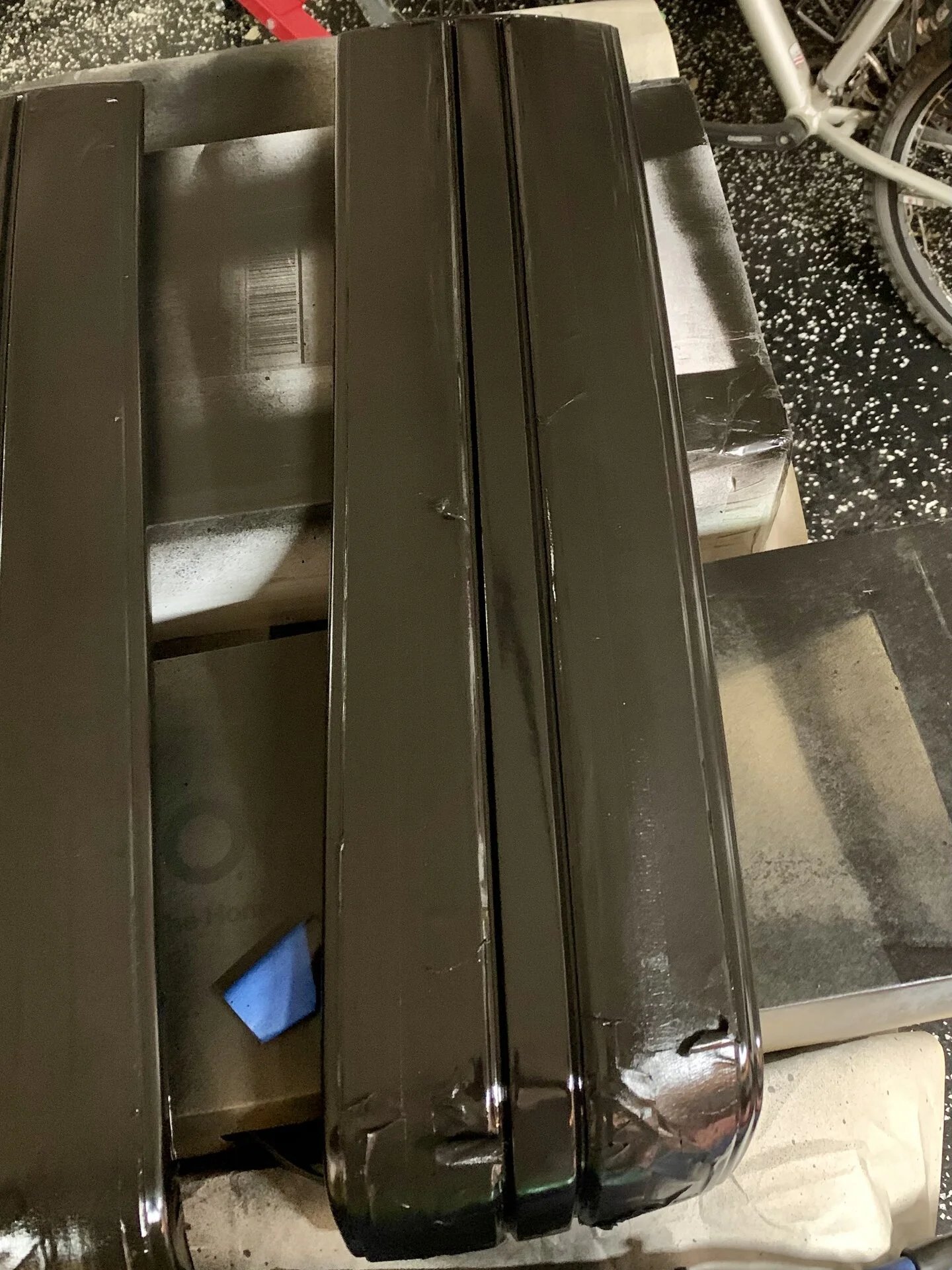

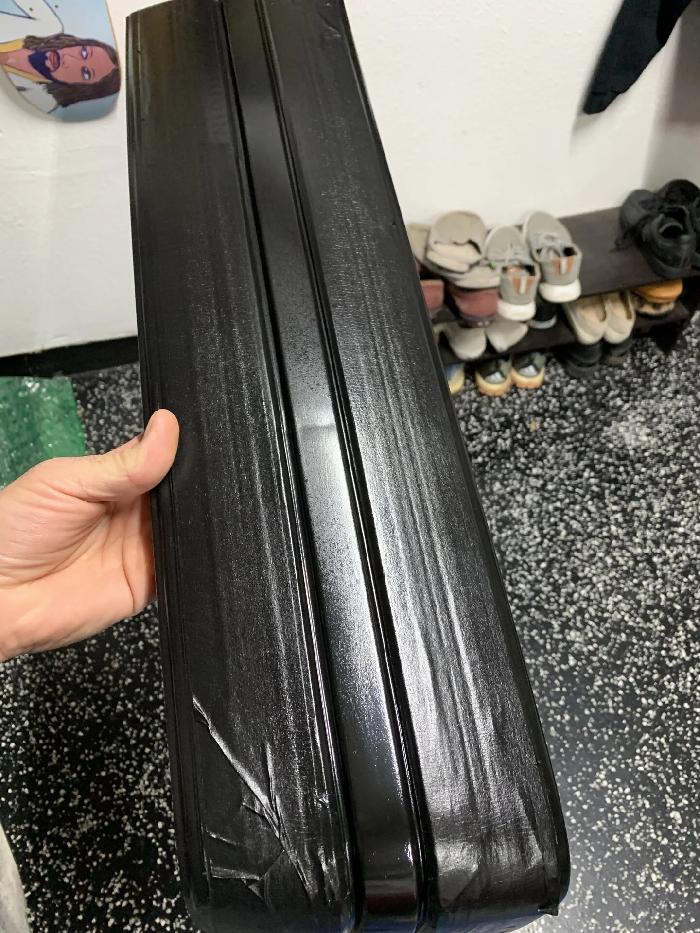

Alright man, so I sanded back on those run areas only and then did 3 light resprays but I didn’t add any more of the plastic adhesion promoter. It’s definitely not as smooth as a finish as the first go, seems blotchy or orange peelish. Think I’m just gonna sand them all back down again and start from the beginning. Maybe that’s what I should have done idk.OK , then sand and respray.
If it was clear coat you could wet sand them flat then polish.
