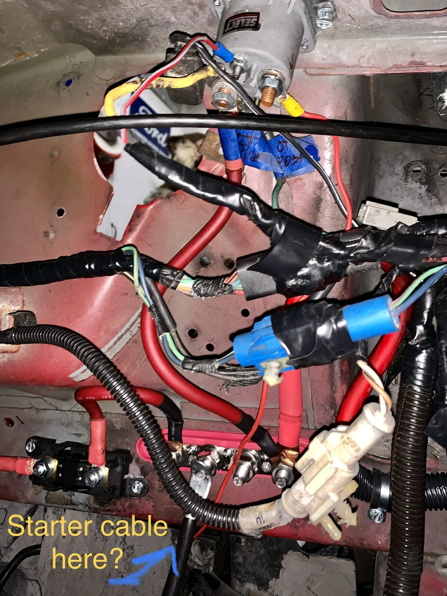

So connecting up the distribution block, I have my 1/0 positive connected and same spot added my wire from there to the solenoid. Can I run my main starter cable to the distribution block as well or does it need to be attached to the actual solenoid?

if you are using the pre 93 cable, it is about 6 inches shorter than the 93 with the mini starter. See if it is long enough to reach the distribution block,
I ended up buying a longer pre maid 4g starter cable, it reached up to the solenoid mounted up in the fender but I always hated how stuff that side of the solenoid got, so if I can mount it to the d-block instead I’d rather. Just wasn’t sure if that would be proper.

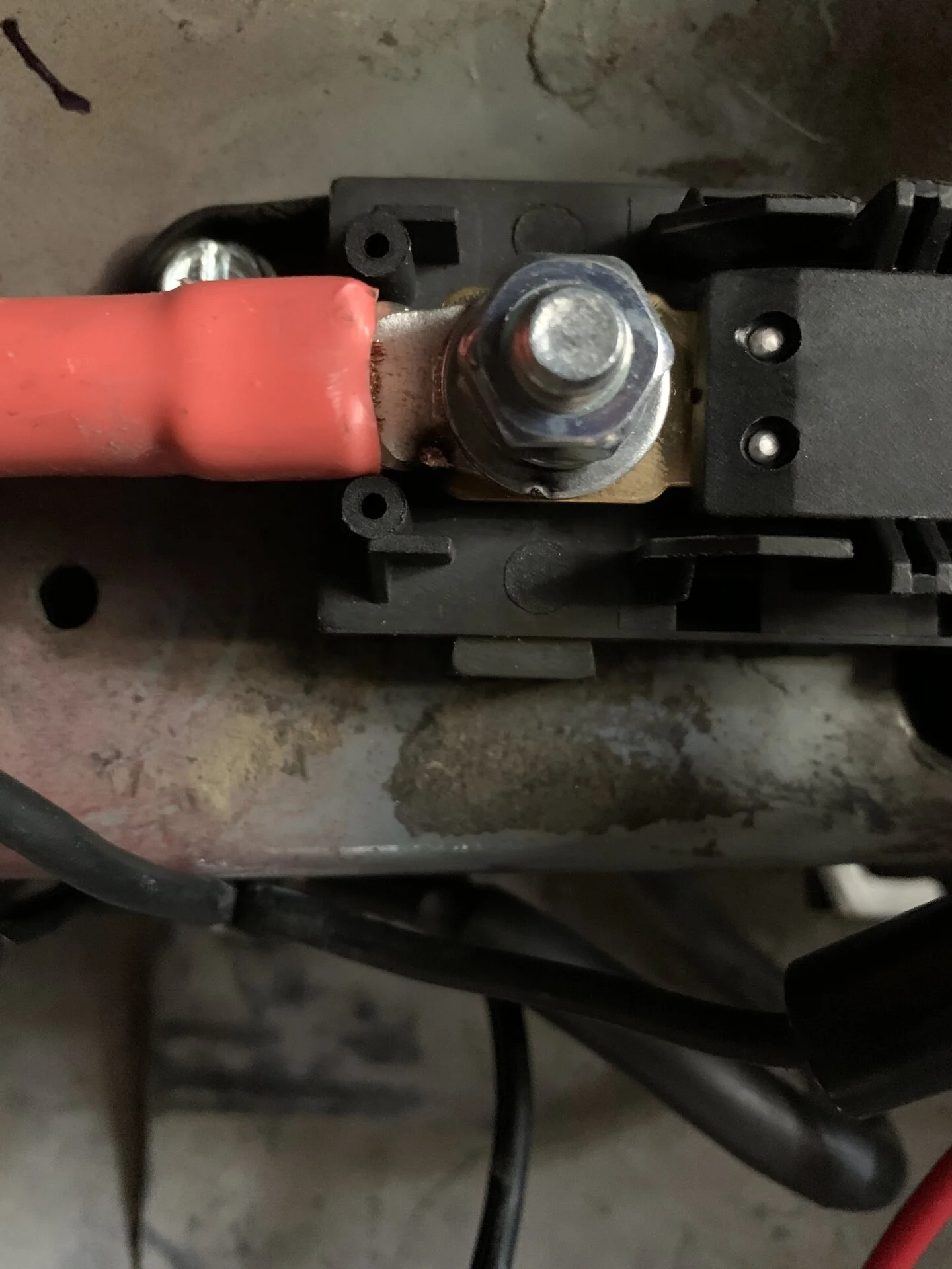

Ahhh boy Idk what I just jacked up but it threw some crazy sparks. I decided to move the ecu ground wire and put everything back together ground wise at this one point. The 4g ground from the block to chassis moved up and touched the mega fuse for the alternator and snap crackle pop small flash firework sparks and I thought oh crap I should have had everything unplugged again. No all is done, battery plugged up, and I have no power. Did I totally screw something up?
I have one! I just pulled the mega fuse bc I was thinking about either going to buy another one or order one off Amazon. What’s your idea?
Based on the reply, I suggest you phone a friend who can teach you how to use the meter to diagnose a blown fuse and fuseable links. I bet you are too far for me to stop by. Maybe someone on here that’s closer can help.

Hahaha yes I’m not as tech inclined as many of you guys in here!! I’m just gonna buy another 200a fuse From advance or something and see if that’s it, I hope! If not well got damn then what?
First, disconnect the battery cables for all resistance checks. starting with the positive side.
Set the meter for a dc range higher than 12 and red to pos, black to neg, touch the less to the battery terminals. It should be about 12 v disconnected.
Watch this before you buy a fuse. She has a pleasant voice to show you how to use the meter to test the fuse before you buy one.

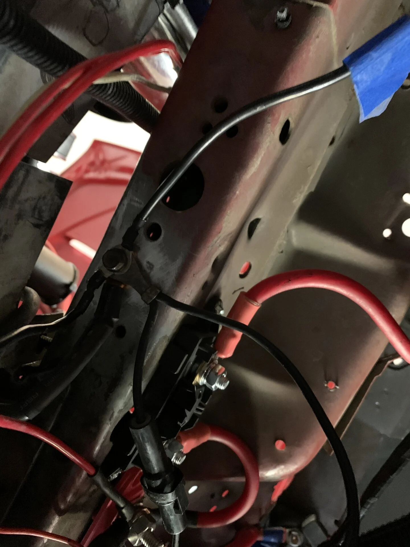

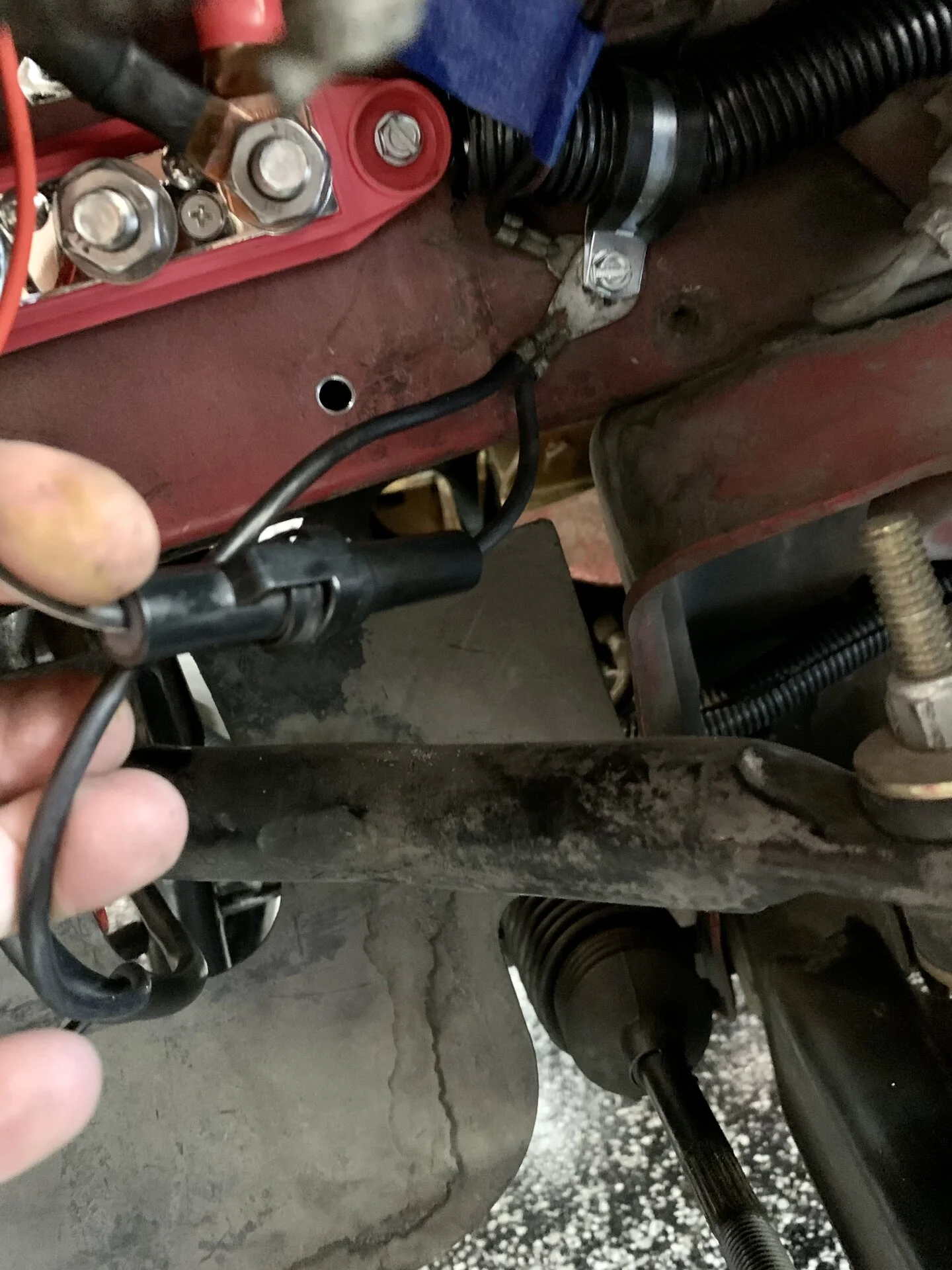

so the computer ground wire has that star eyelet and then this little guy to ground as well. Can they be grounded at the same point together or to the have to have different contact points? Then I can just attach the 4g ground from the block and a ground from my MSD and fan controller together? Before the dumb mistake I did and not disconnecting the battery before I started to mess with the grounds etc, the car started up but was running like crap. I thought well maybe it’s bc the computer ground wasn’t ground well enough, which is why I tried to bolt all of it together to the chassis. Then that 4g touched the alternator Mega fuse and things went south power wise. The second pic is where I had grounded the ecu originally and the tail was connected with the 4g wire point, Was that first ground actually ok?
Wherever you connect them, make sure you sand or scrape some paint off, so that they are making contact with the bare metal. And I don’t know if matters, but I would make sure the computer ground is the first one down against the chassis, if you have multiple on the same bolt.

I am concerned he hit the battery side of the fuse. That could have pulled a lot of power from the battery, and strange stuff can happen with a short.
In a 65 A body, the lighter socket center contact came un riveted and shorted out when I unplugged a phone charger. Not only did it take out the fuse for the lighter, it took out 5 other fuses, and the aftermarket tach still has periodic tremors. I added a fuse in the line to the lighter socket, but am still wondering how it pulled that much power from the radio etc.
