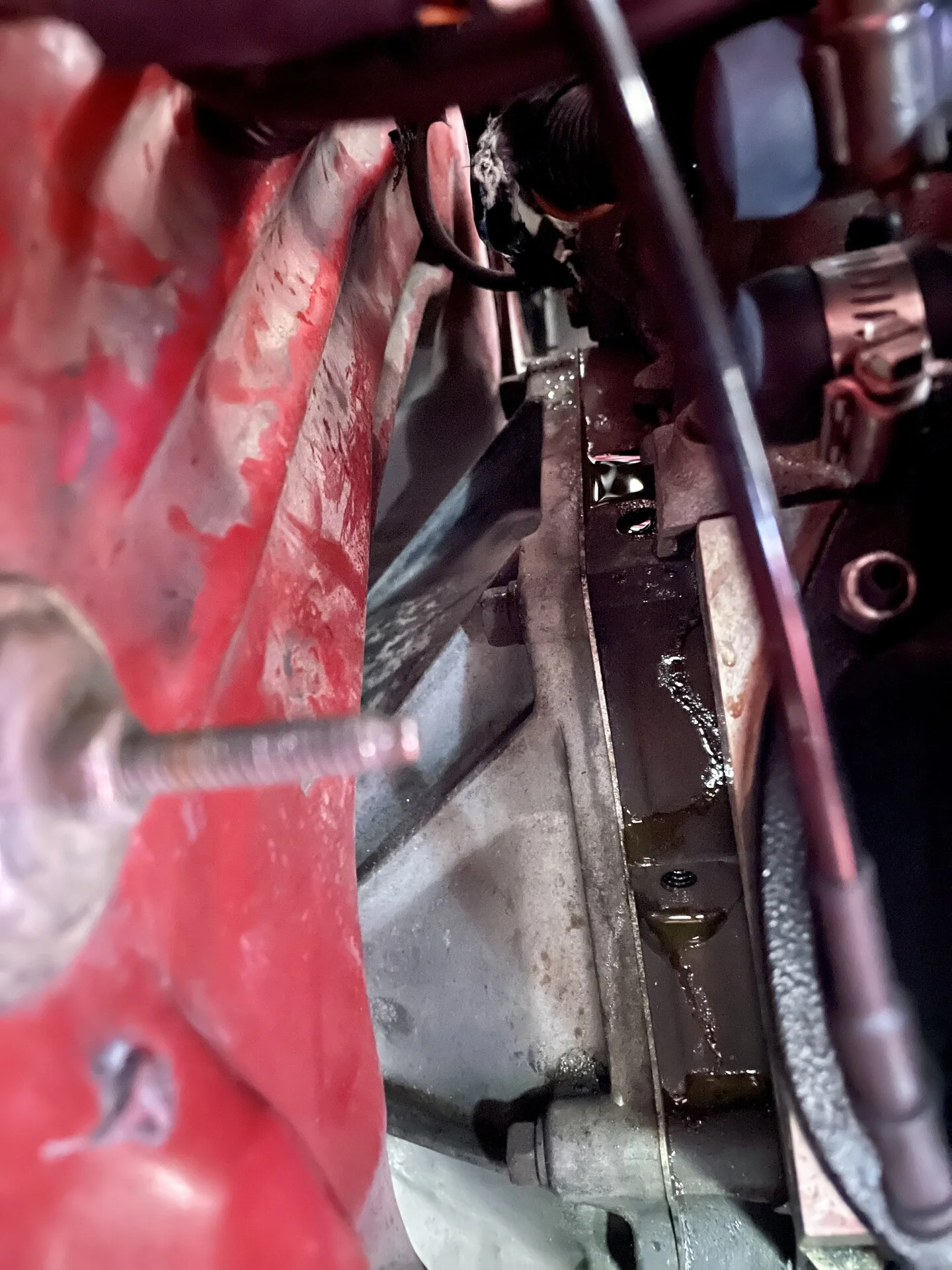

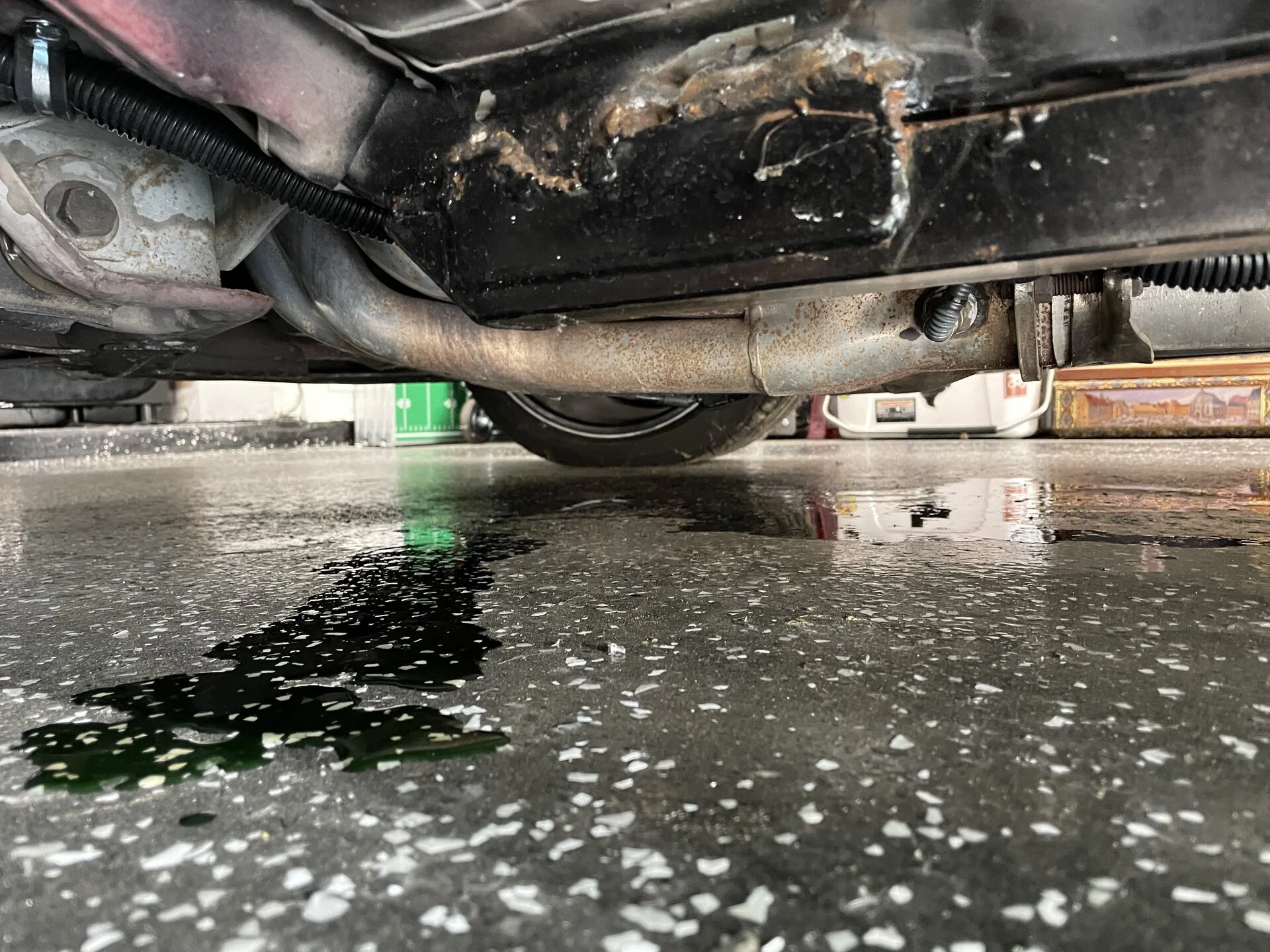

Now the seats are less of a concern. I cranked the car up on Sunday as I wanted to go out Monday morning for a cruise. Let it run for 10 minutes or so, turned it off and I’m chilling at the back of the car and see some coolant. A lot of coolant, so in my head I’m thinking it’s a hose but the front of the car all looks dry, floor etc. Look further back and the puddle is starting around the longtubes collector. So I look behind the intake and there is the problem. I’m guessing it’s the lower intake gasket? What do you all think?
Intake gasket is my guess. I wouldn't start the car again in case coolant is getting into the oil.
You can pull the intake manifold off for a better look and get a pressure tester to see if you can see where the leak is coming from.
