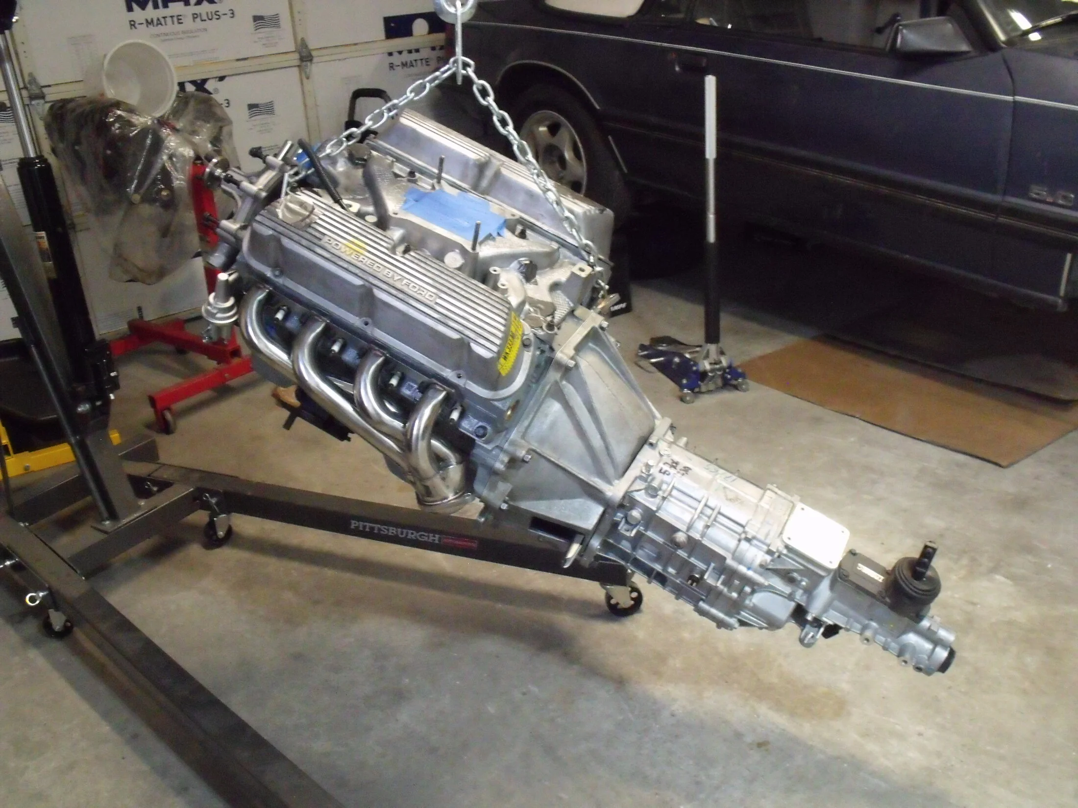

A TKX is gonna run you a hundred bucks shy of $3,000...... But it would be a brand new transmission....
Some cars will require cutting the floor for a TKO, can't say this is true with a fox body, but I know camaro's and Dodges had to be cut...
I see people spending alot of money on " custom " built TKO's that " in my opinion" would be money better spent on a TKX or a magnum 6 speed.
Pic of my TKX that bolted right in to my 83 Fox body.... I had a SROD 4 speed originally whose bellhousing fits a TKX.. A TKX will not bolt up to a T5 bellhousing...

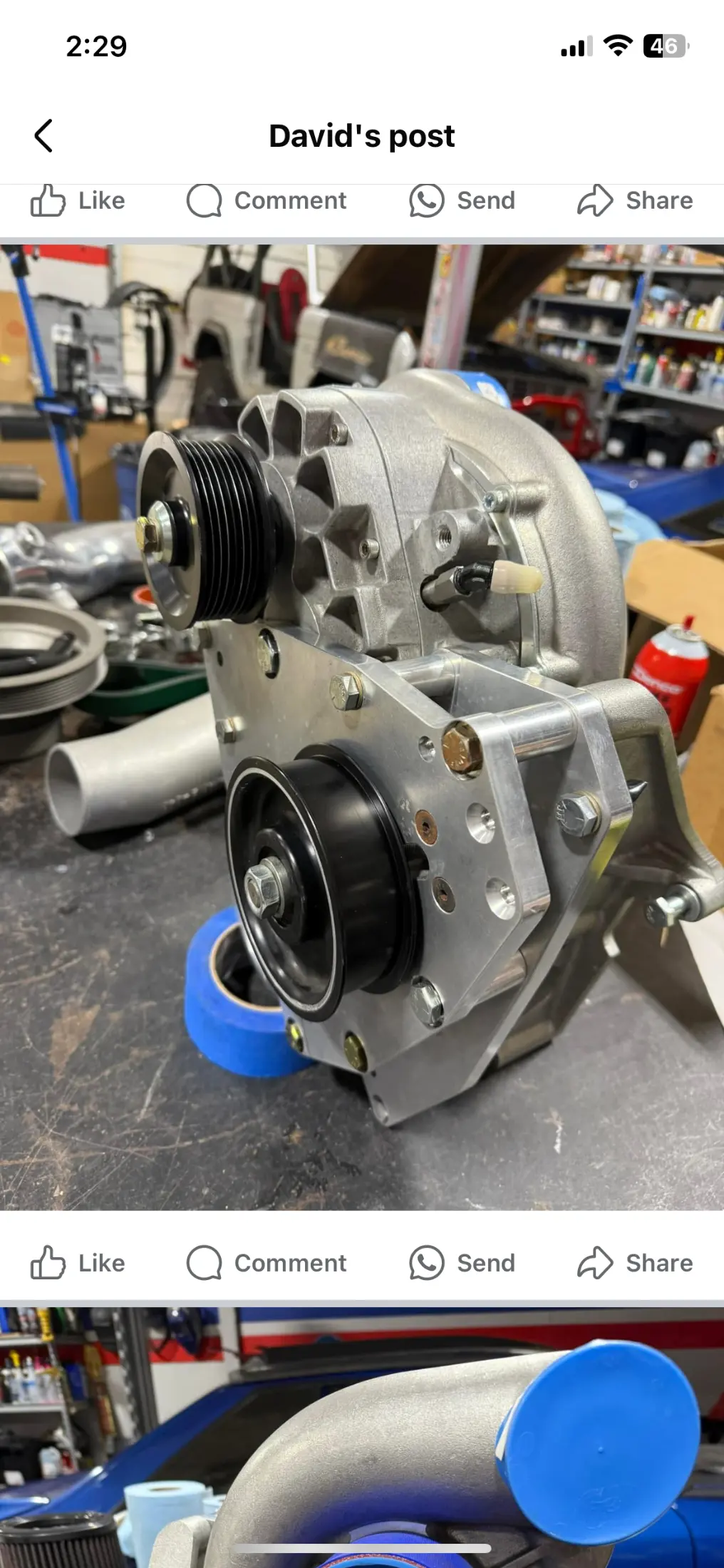

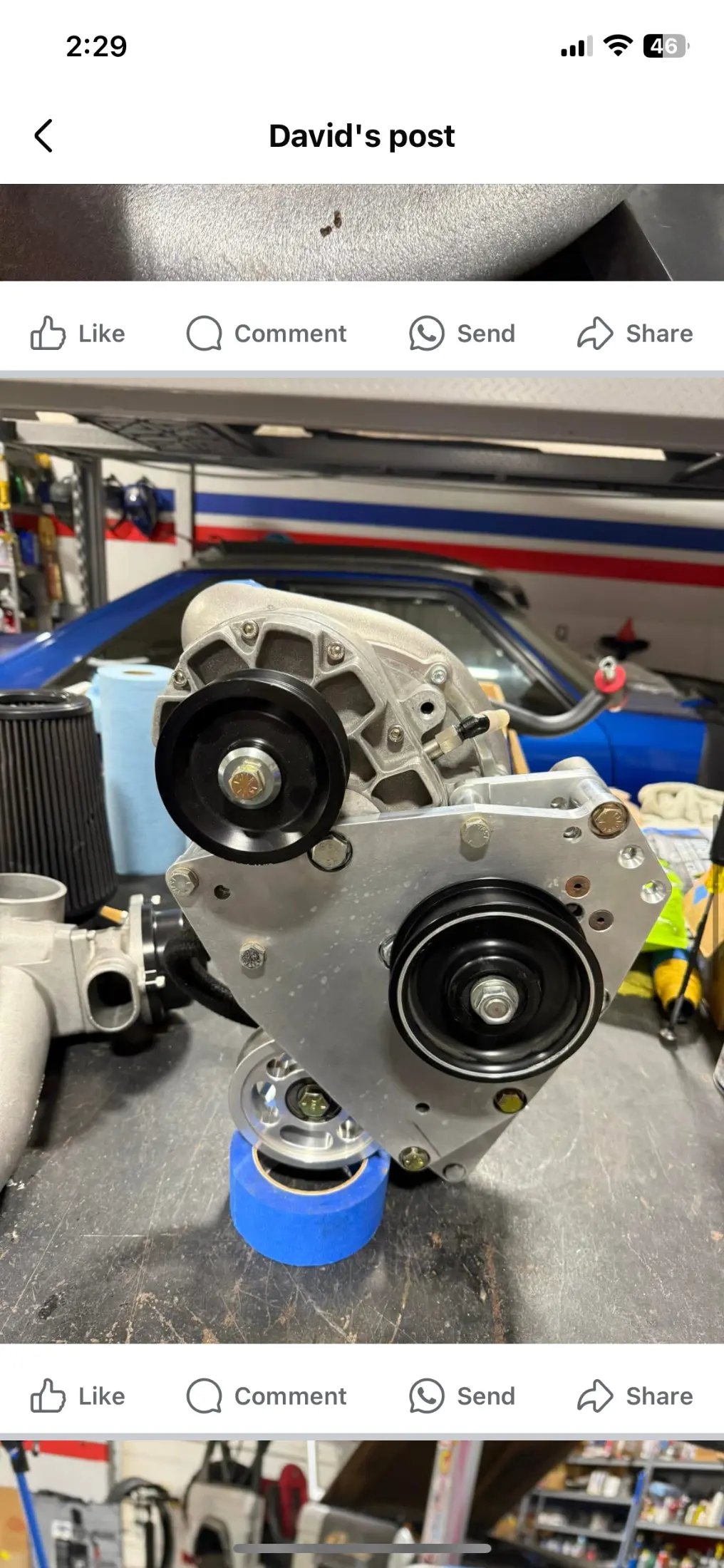

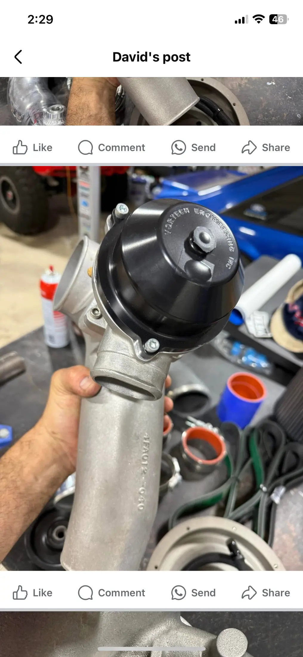

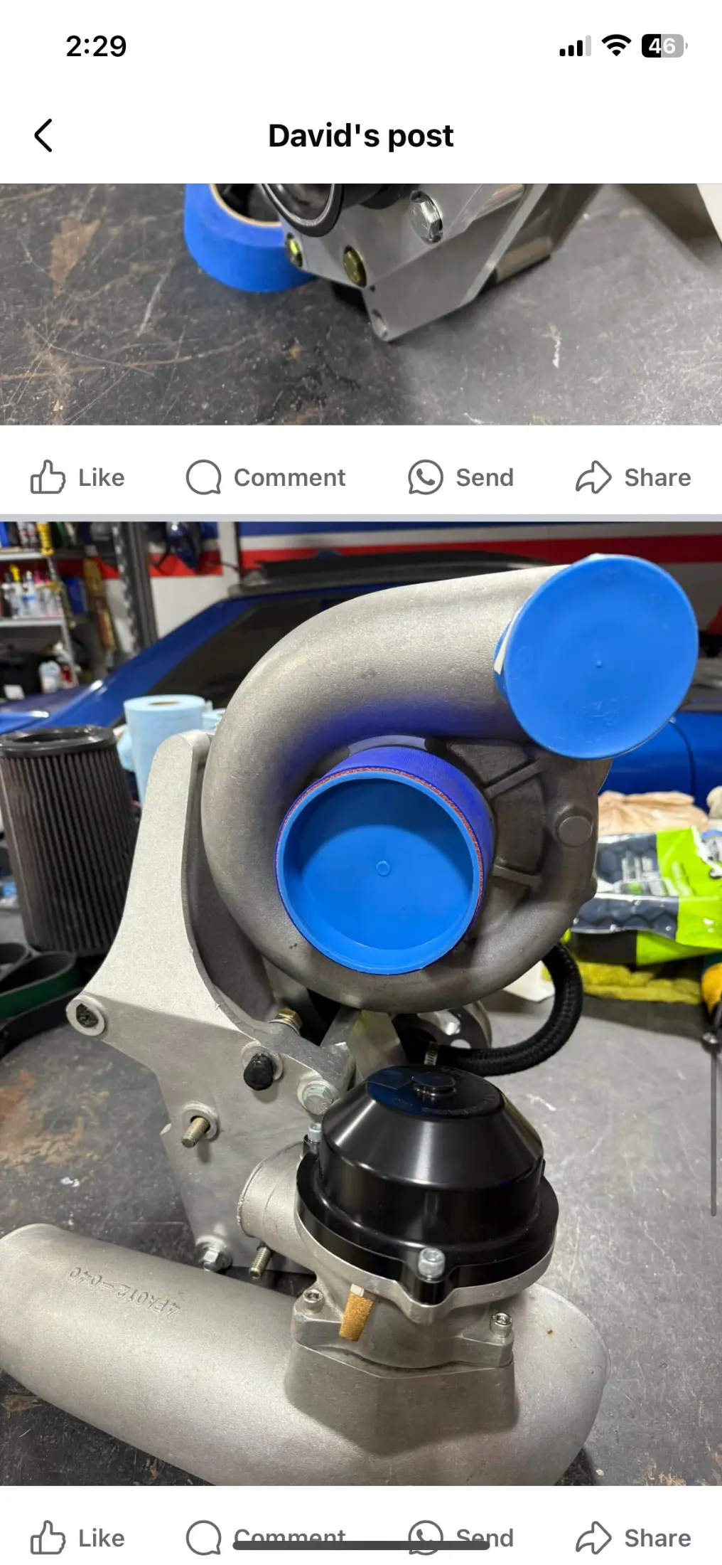

So I missed out before but there’s another kit available around me. This is a V2 TI kit for foxbody. Wanted self contained which this is not but not a big deal. I don’t have a wild set up currently 302 head cam injectors etc chip tuned. I have a term x kit I’ve been wanting to install, plus I also have a 351 I would like to some day build up and swap. I am just trying to figure out is this to much blower for my setup? The guy was building a 351 he was stroking, put on car to idle it and that was it,
So kit is fairly new. Sent serial number to Vortech and they identified. Originally wanted a pro charger but a new kit quickly jumped to 7k + :oops: saw this kit posted for 4k but he said currently he would do 3800. It’s satin though and really wanted this big piece of the engine puzzle to be polished.

Don’t quote me but I think someone on the Brew2L YouTube channel ran/runs a Ti on a stock fox and it was seeing like 13lbs of boost? Anyways seems doable but you already have a lot of other performance parts so maybe your power would be too much for the block.

That’s what I’m wondering in regards to boost. My current motor isn’t pushing huge numbers. When it was on the dyno last after getting tuned I was 325hp 340tq. Granted I know there’s more room to push but this car isn’t a daily or track car. My thing is this unit seems like it’s built for higher boost levels and comes on at higher rpm’s say VS an SI trim at 8-10lbs of boost

Based on a quick look at its compressor map and some beer math, I think a TI is gonna work really well on your setup. 325 at the tire implies 500 rwhp by 9-10 psi.

That looks like a nice kit - renegade bracket and discharge pipe
The ti would be fine and you could grow into it if you needed

Don’t worry about the few rpm the blower makes power later it will wake that thing right up and if you do build a Windsor be plenty of blower for it
I’ve seen Freezy make just shy of 800 to the tire through a stick with a ti
