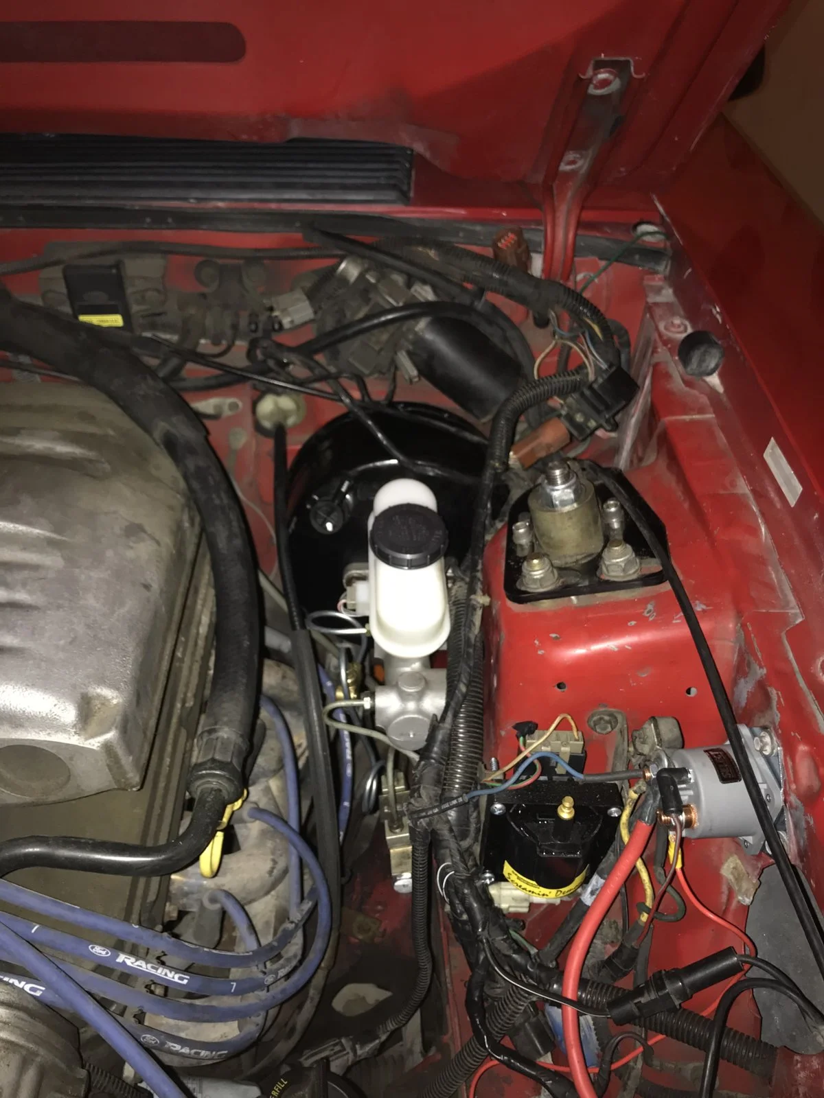

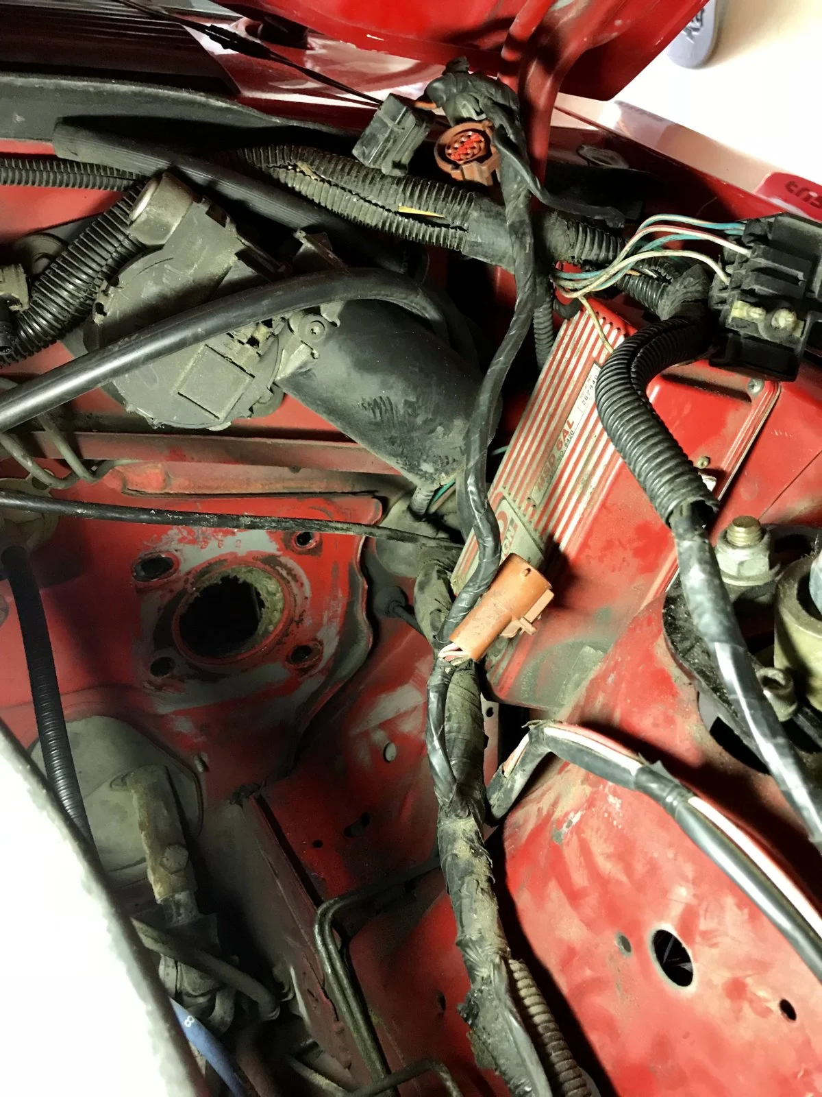

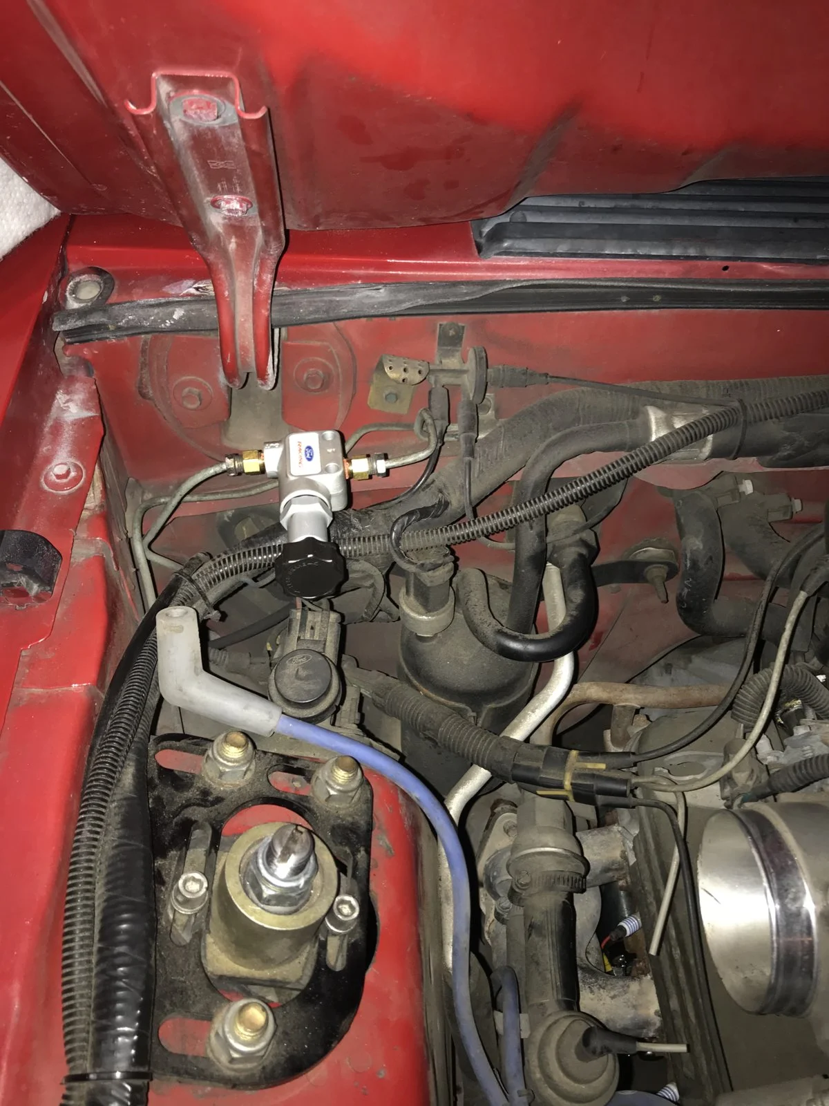

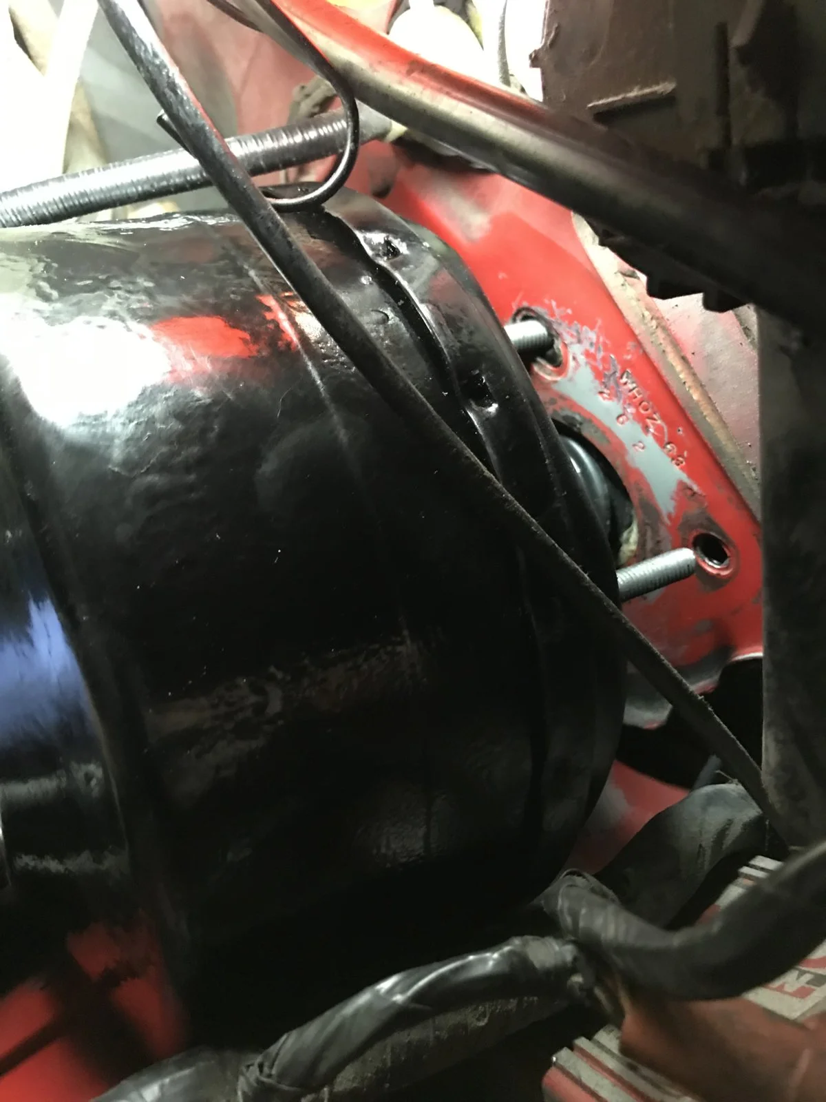

So working on getting this booster in now, it’s gobna be a struggle and alr day scraped a big junk of my paint off it from rubbing against the intake. Tempted to remove but have heard plenty get it without doing so. What do you all think of my msd placement? It’s been there for about 16 years now, idk if it’s even functioning but will it be to tight with my booster. If I remove the MSD box is my car going to run right? Just thinking maybe I should place it somewhere else.
Just pull the intake. Loosen the bolts and just shift it to the passenger side. Save yourself the headache it's only 10 mins of work.
I'd ditch the MSD personally

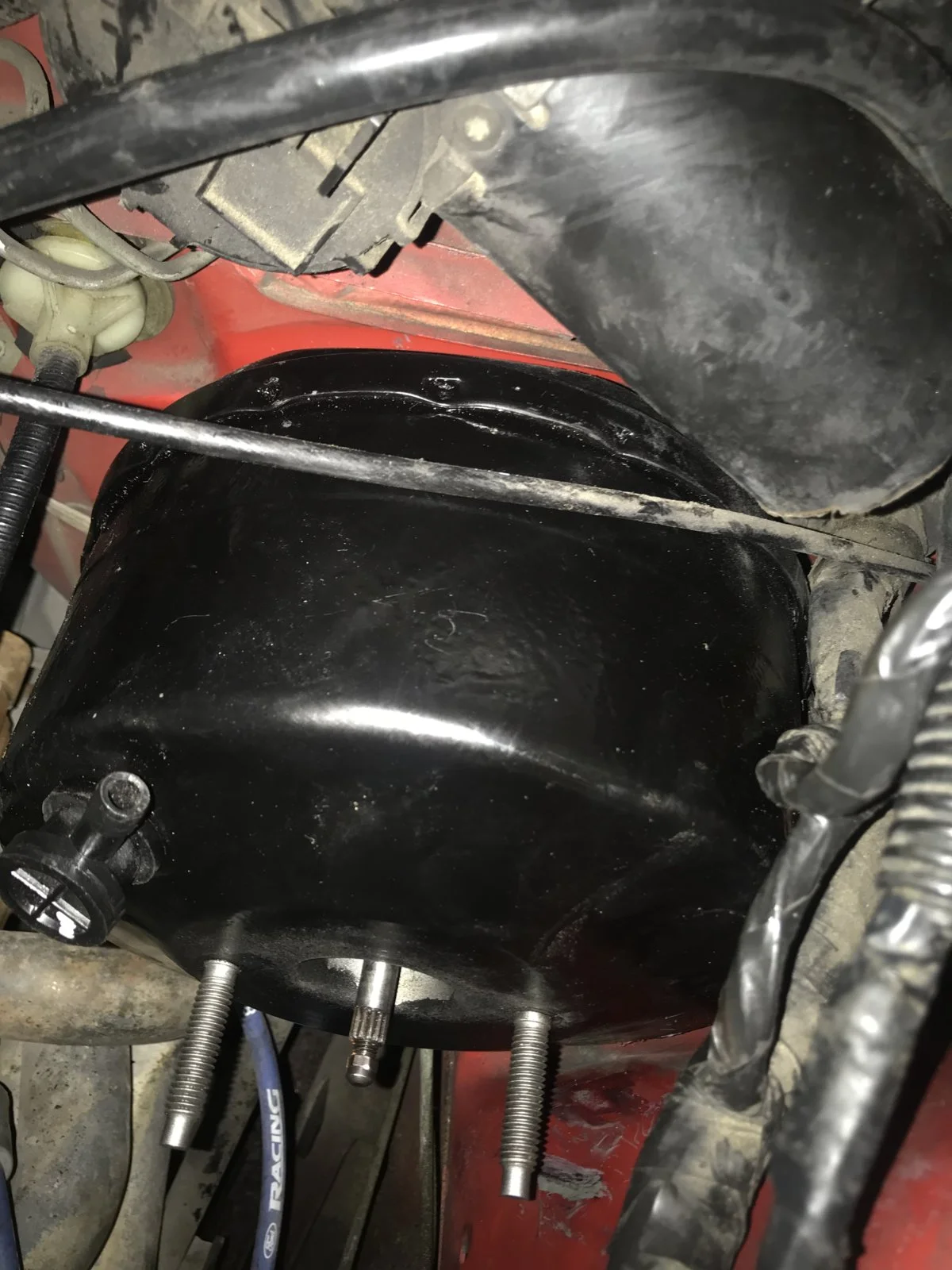

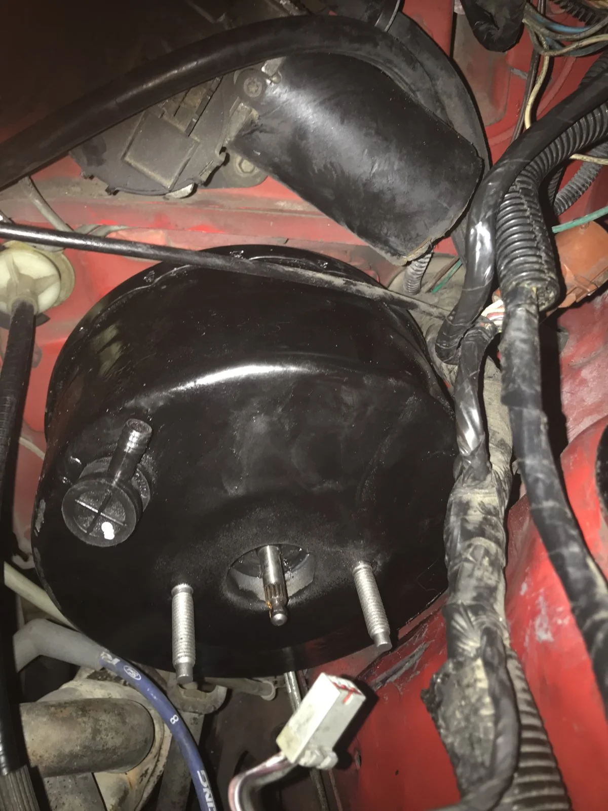

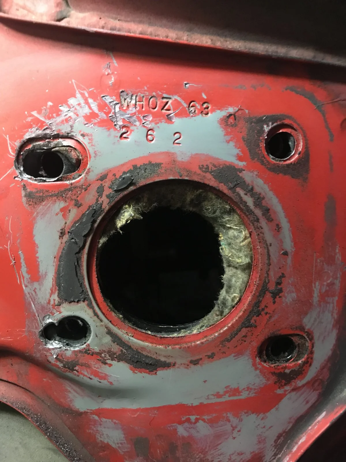

I tried to slot the holes slightly and it’s so close. Did you do about the same or go more? Didn’t cut the studs bc I don’t have anything to re thread them and honestly idk how to.
All you need is a cheap standard tap and dye kit from any parts store. If you take some of the stud tip off it'll make it alot easier. I'd also advise putting some sealant around the holes. Butyl for front windshields works well. Just pull a string of it about 1/4 to 3/8th thick and stick it around the base of the studs.
The pinch weld will drip around the booster sometimes in heavy rain. The factory booster had a gasket behind it.
My last car had no sealant or gasket and the floor was never wet on the drivers side....just precaution.
The hexagon bit that has the same thread as your booster studs literally just screws on the stud to clean the threads up.
If you put a nut on the stud before you cut it off it will clean the threads up when you take the nut off. Put it on and off a couple times and you're good to go. Thats how you used to always do cut bolts and studs....before i started using tap and dye kits. Worked every time. A grinder or cut off wheel ( even a dremel ) will make quick work of these studs. Don't take too much off....about 1/4 to 3/8th an inch.
About the same. Youbare really close. I'd probably slot those two a little more sndvsend it home.
When I trimmed my studs, it threaded two nuts on first then cut. I backed off the first nut, and ensured I could get it back on. The second but was just a backup in case I couldn't get the first nut back on. I didn't have the proper die handy to rethread it

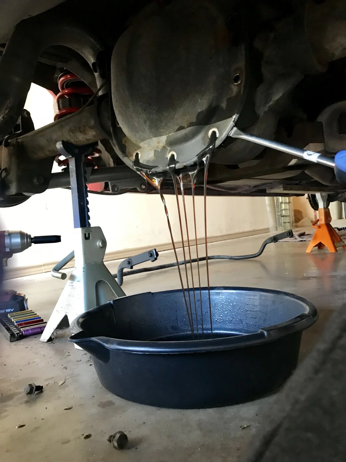

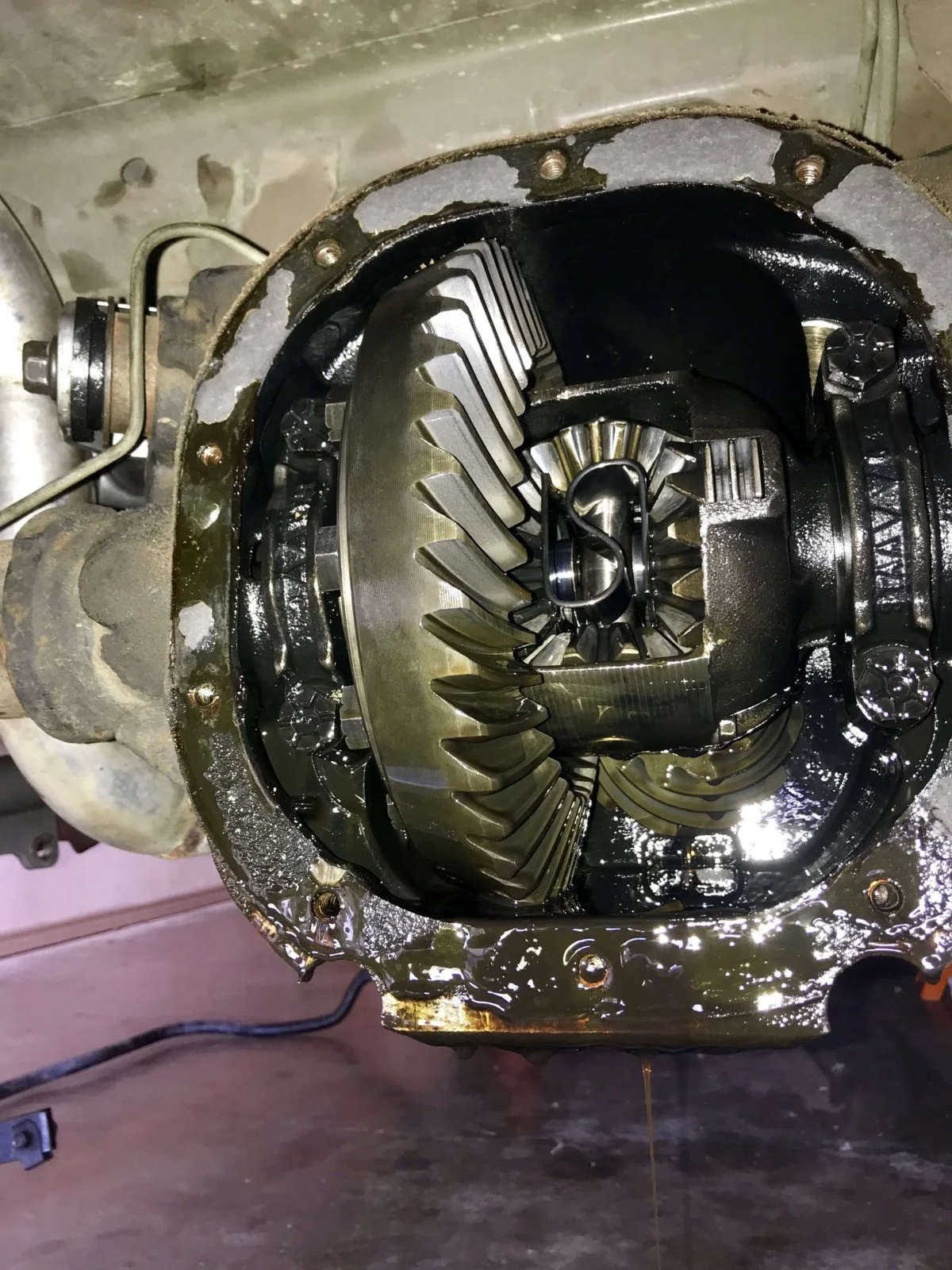

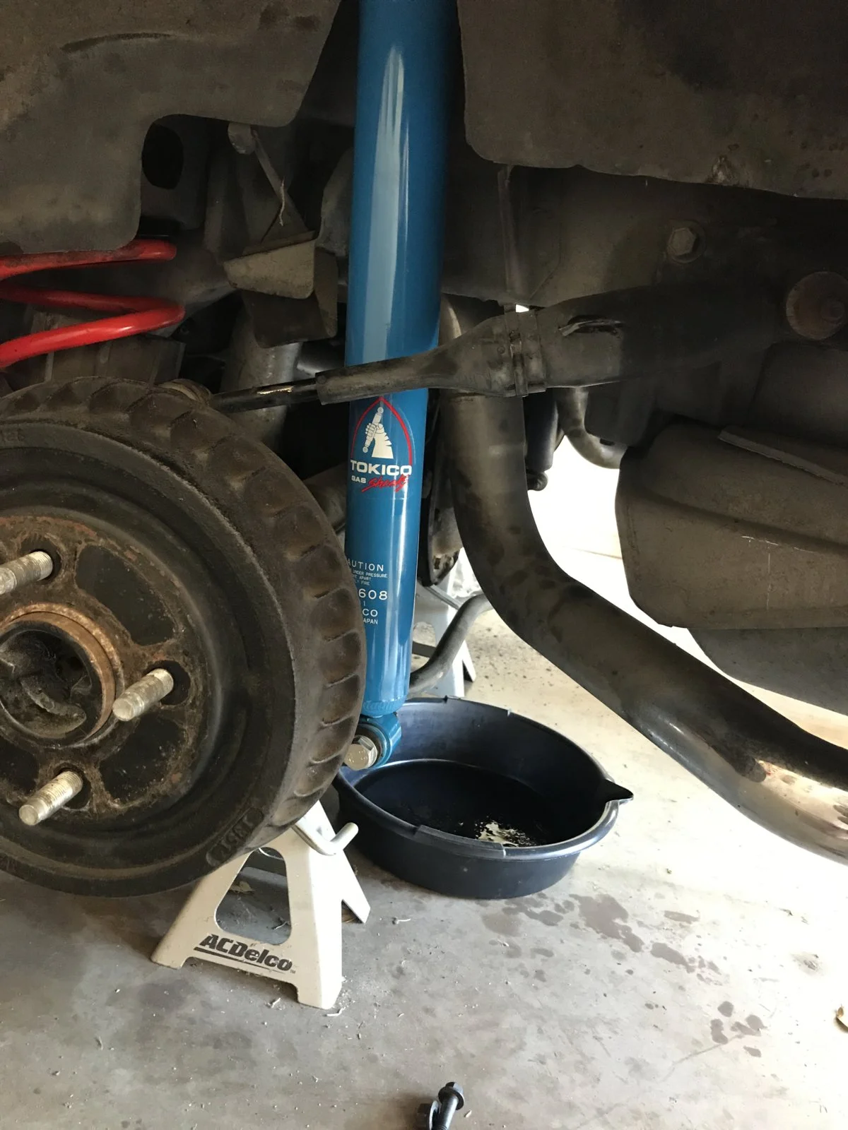

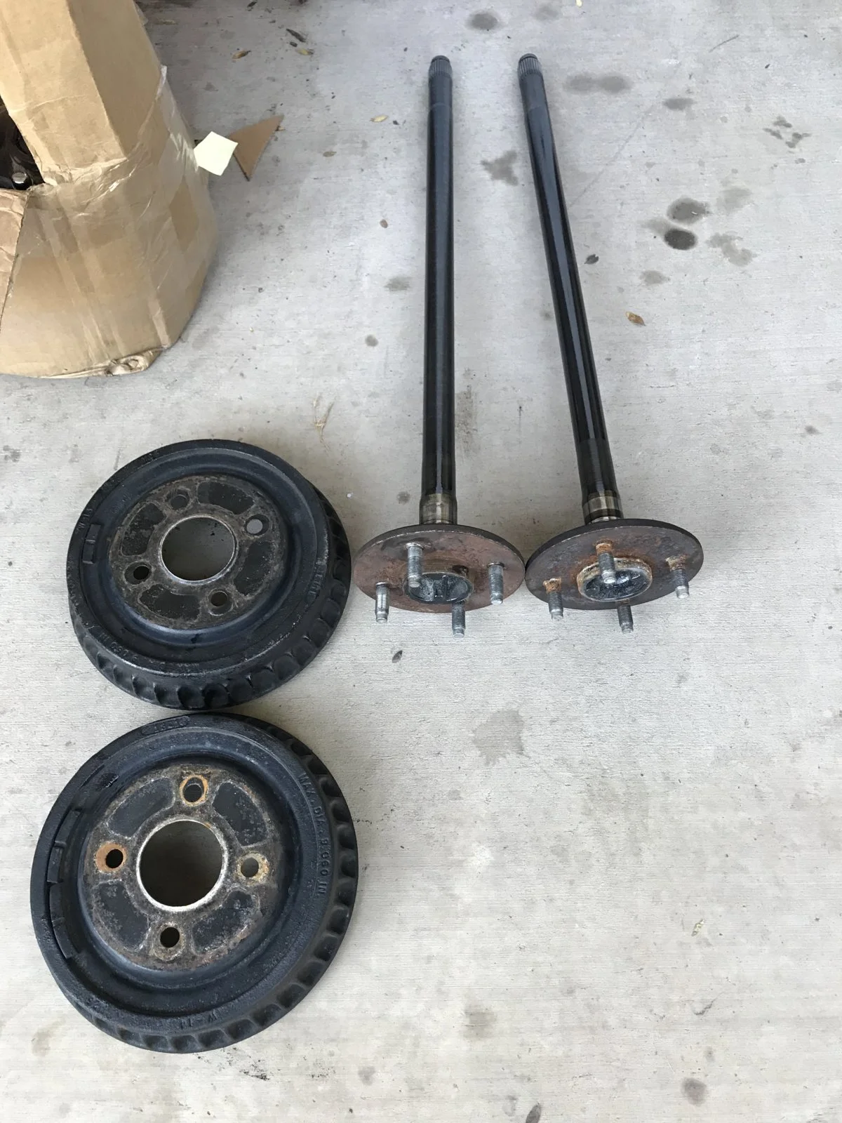

Well started to attack the rear!!! Guess that comes off kinda dirty :oops: So got both the shocks in, opened up the diff and man once that oil started draining, it stank real gross. Sprayed some cleaner in and tried to get most of the oil still need to scrap out some puddles. Pulled the pin, C-clips are out as well as the axles!!! Guess I’ll get the drive shaft out next, and pull the remaining hard ware off from the drums. Thought I’d get a head start while I await my rear cobra kit to come in sometime this week. I’m kinda worried about the whole E-brake
Evbrake is easy once you get all the right parts for it
